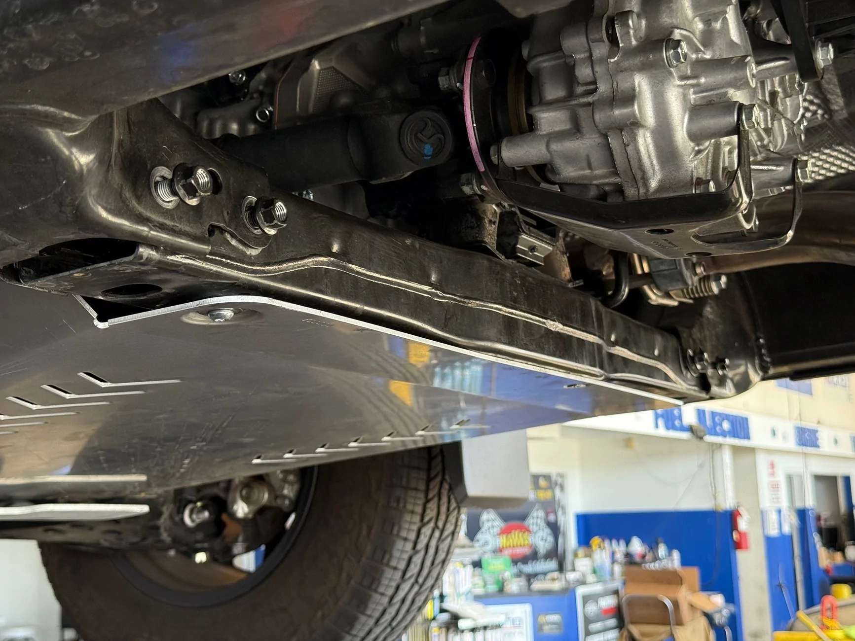

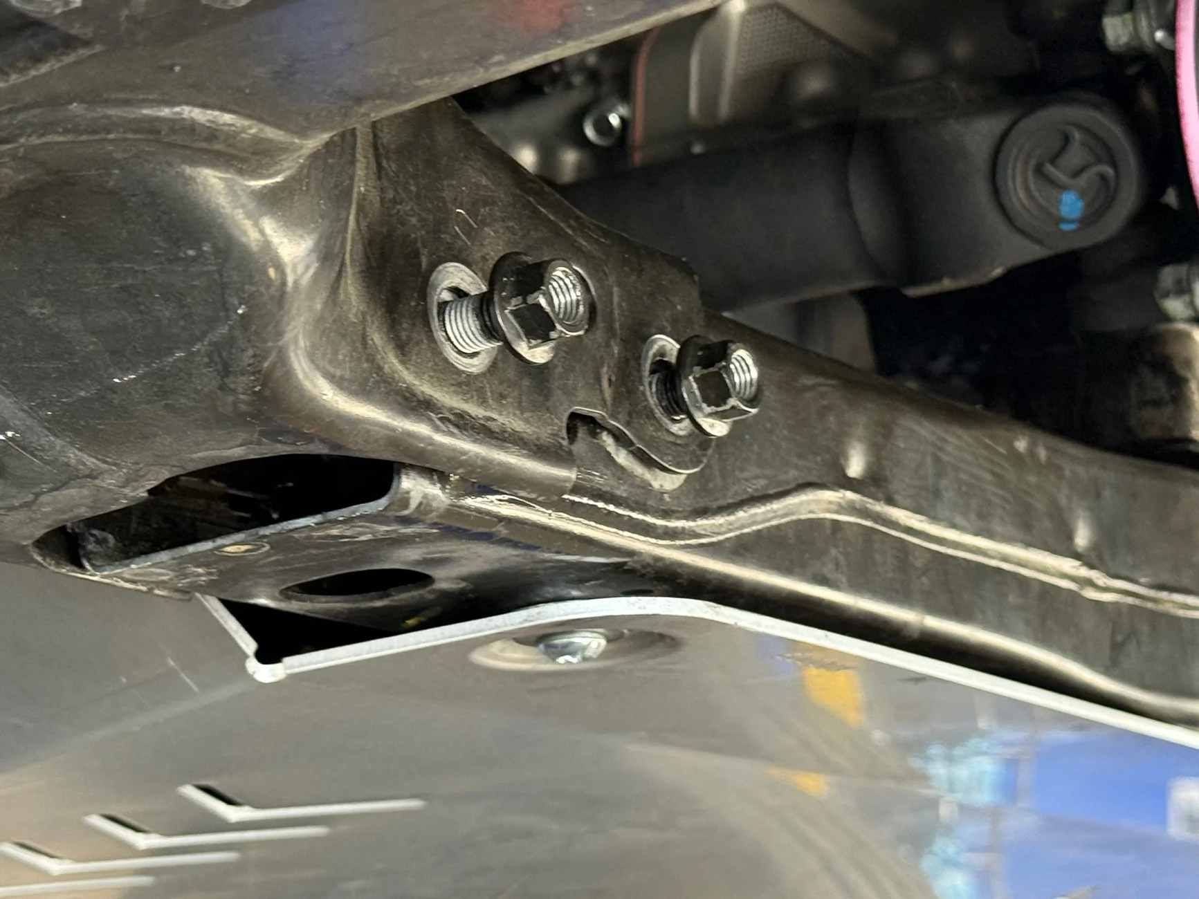

Got my truck back but then had to send it back to Tustin Toyota a couple of days later since they did not tighten all four bolts on the transmission cross member nor did they tighten my transmission shield all the way.
Oh, then when I went to pick it up the service writer told me he’s worked with the tech for many years and he’s never made any mistakes before and they believe it was tight when it left their dealer and it was probably someone else that loosened it. Basically implying I did it.
I’m now looking for a new dealer to bring my truck to in the OC area.
No surprise to me…
2,331
3,018
I'm not really all that surprised that they forgot to tighten down those four bolts on the transmission cross member or fully tighten the shield plate. I should not have happened but people do make mistakes. I am amazed that they had the balls to say you sabotaged your own truck and loosened those bolts to make them look bad. I don't think they need any help there from your experience.
I agree - find a new dealer but I would follow up with Toyota since you have the pictures and ask them if they think you F'd up your own truck to cause trouble, and if this is the quality Toyota care that we are supposed to trust.

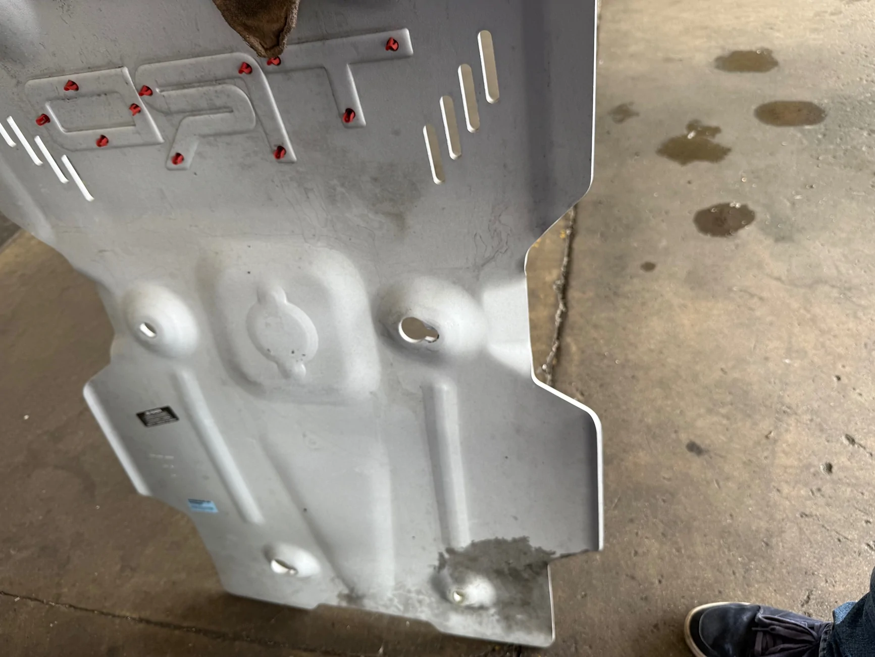

Noticed oil on the cross member. Had to take truck in to repair engine oil pan leak, was under warranty all good so far 12k miles

Well F, now I need to go look at that when I put my skid plate back on tomorrow.
