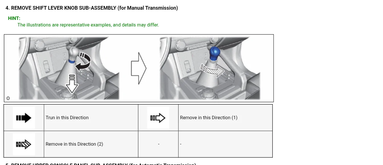

The service manual is definitely not the clearest on this...
I think this means to turn the lock or trim ring (highlighted blue) clockwise and down, then the knob will loosen counterclockwise. Maybe.

Edited the response - I realized that the ring is highlighted blue in step 1, turn the knob in step 2.

Thanks! Guess it does just get brute forced off lol
