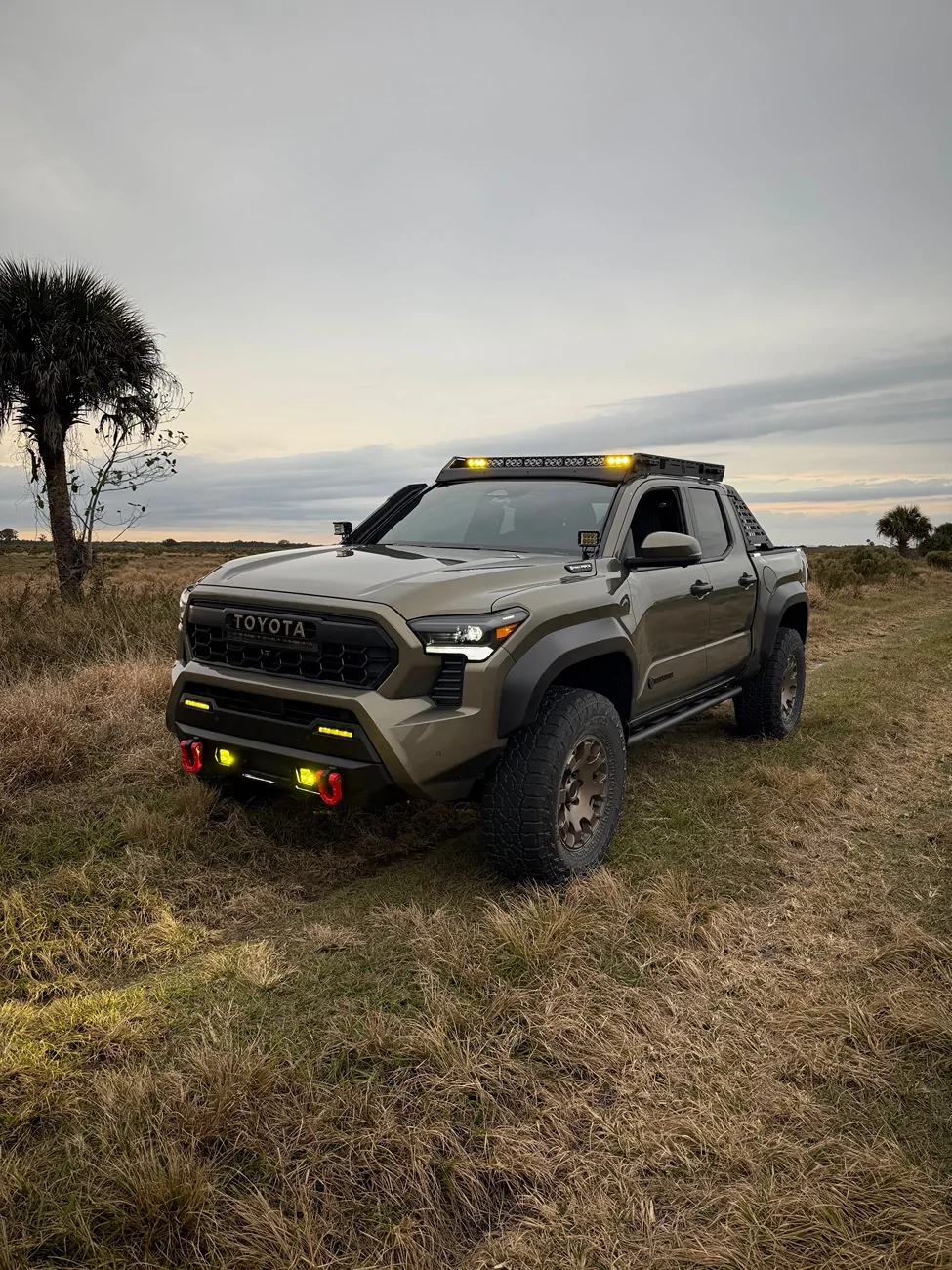

Here is a a random photo because pictures makes posts better lol
2024 Tacoma Rotated Tires, now pulls to the right! IMG_5400
