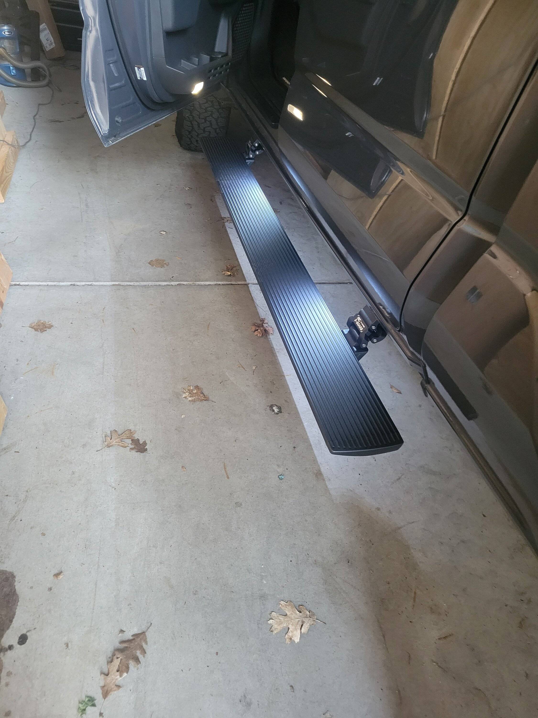

Took me 5 hours for the total install with a lift. The biggest problem is that they tell you to install the control module on the center mounting point for factory steps, which is fine, but there are 4. The only empty one that works with the wires is the rear and that makes the wires crossing the car inside short. I have one that is uncomfortably tight that I'll have to extend this weekend.

I installed these took about 3 hours total I wish you could tap into the door switch instead of the magnets has anybody figerd out if you can bypass the magnets and hook up through the door switch ?
