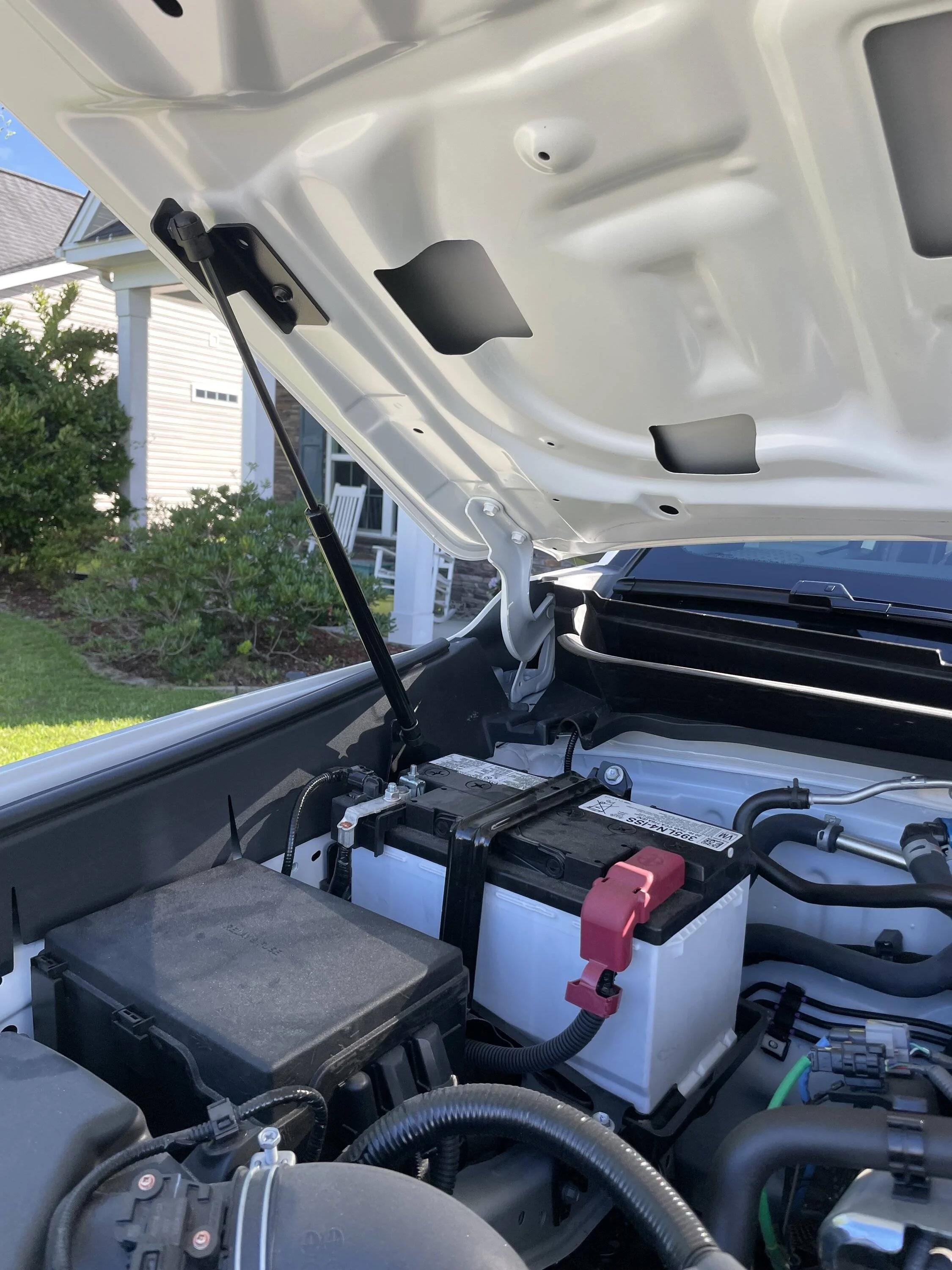

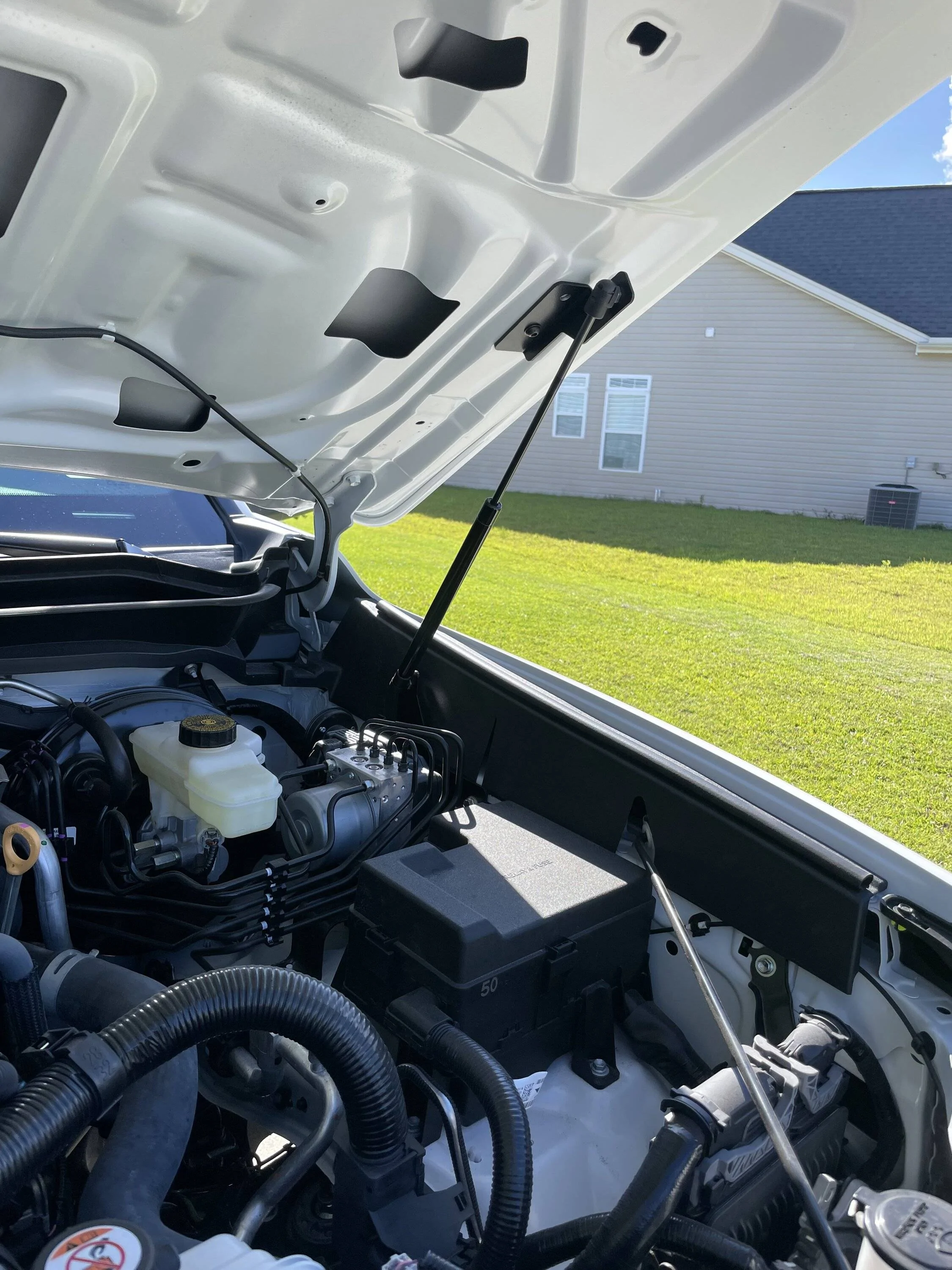

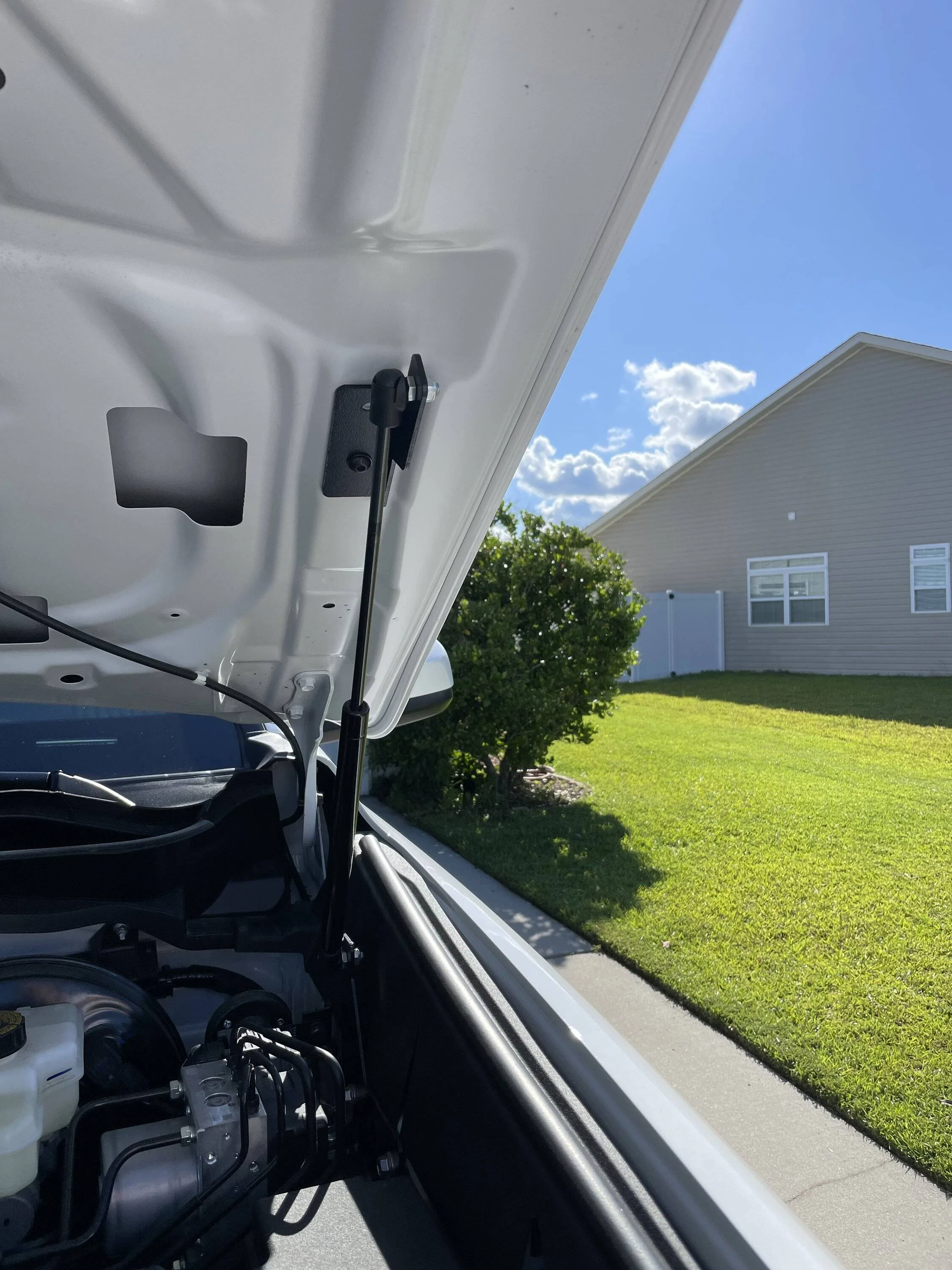

I actually didn’t drill it. Going to see if there’s any flexing or anything before I decide if I’m going to. I most likely will drill the two holes. Seemed solid with just the one bolt in the hood. With the way the struts mount and the brackets, it really doesn’t seem like it’s needed.

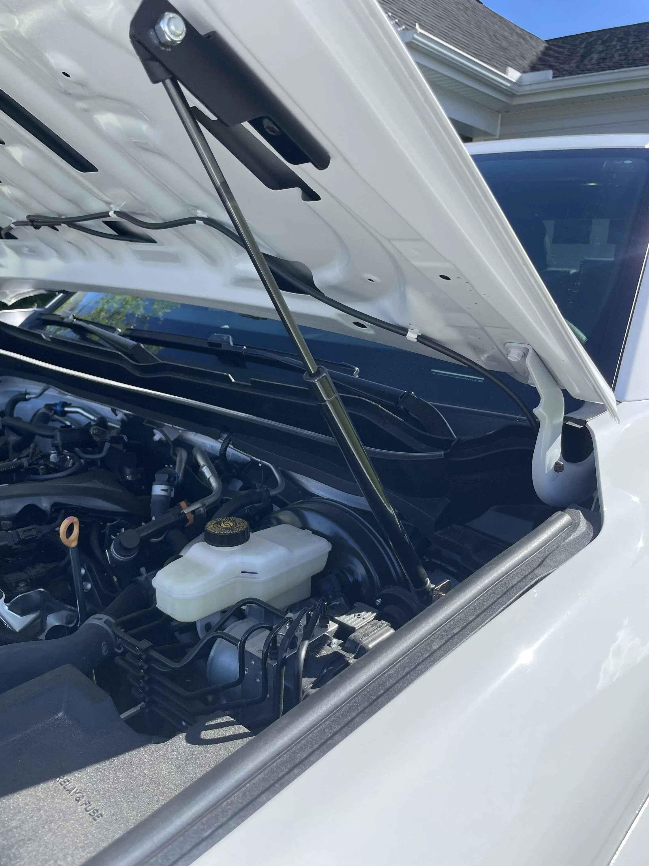

I just got done installing mine. Their directions suck. You’ll need an m12 socket for the bolts and a m5 Allen wrench. One thing they don’t tell you, you can’t have the prop rod in when you put the struts on. The struts won’t allow you to lift the hood enough to remove the oem prop. You can rest the hood on the outside of the hole where the prop sits in the hood. You have to use a little force but it will pull out once you connect the struts.
The photo was taken just before I realized I couldn’t get the prop out. Haha

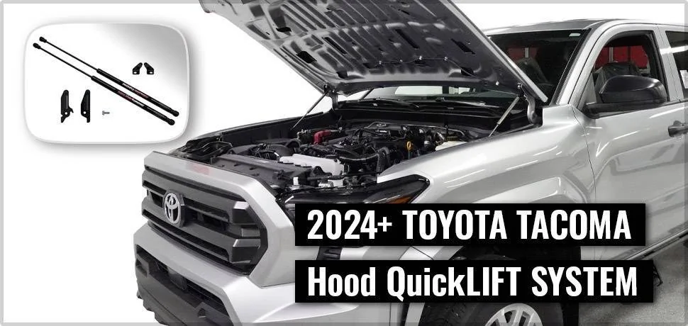

Redline Tuning is pleased to be a sponsor on the 4G Tacoma forums and want to showcase our new 100% Bolt-In Hood QuickLIFT system for the 2024+ Tacoma (No drilling required). We also have systems available for all Tacoma’s back to 1995.
Features include:
- Bolt-In installation with no drilling required (takes less than 10 minutes)
- Black powder coated mounting hardware
- 4 year warranty (QuickLIFT PLUS system with Black gas springs/struts)
- 5 year warranty (QuickLIFT ELITE system with Stainless Steel gas springs/struts)
- Made in the USA

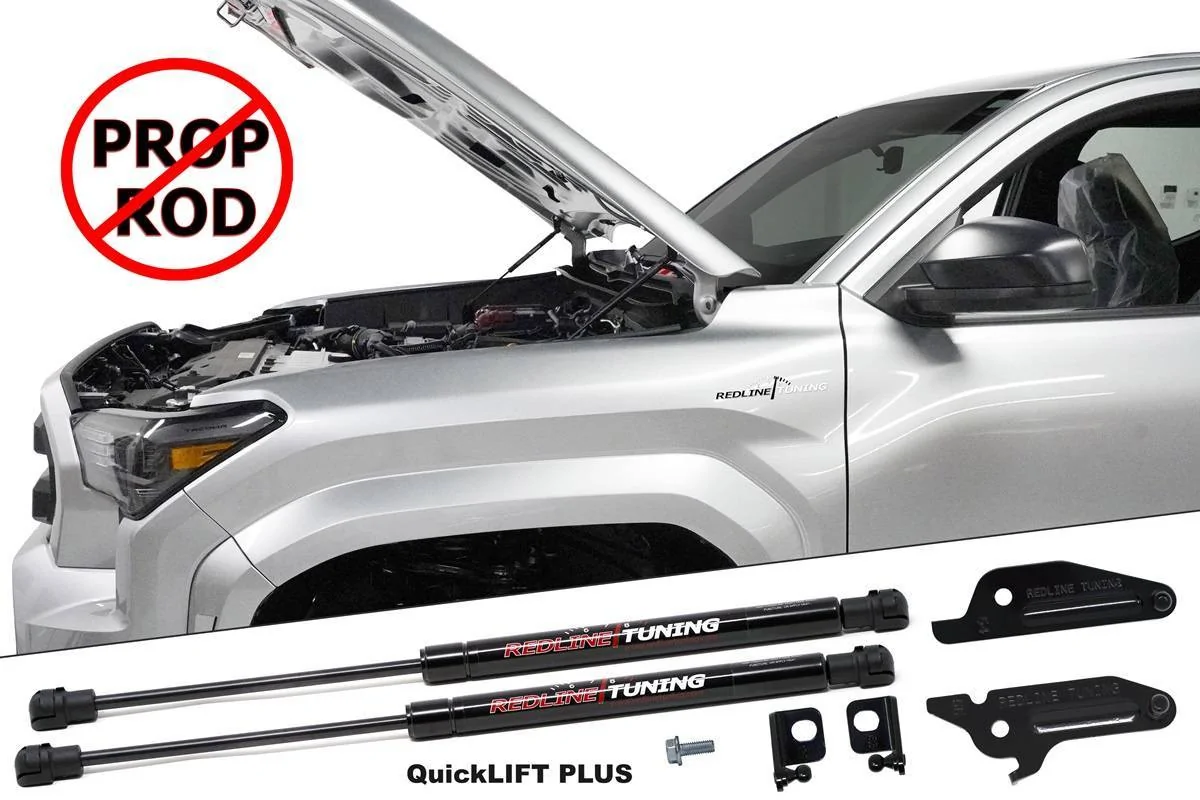

QuickLIFT PLUS features:
* All black powder-coated mounting hardware
* Black e-coated gas springs
* 4 year warranty
available directly from our website here: https://www.redlinetuning.com/2024-Toyota-Tacoma-Hood-QuickLIFT-PLUS-p/21-27022-02.htm

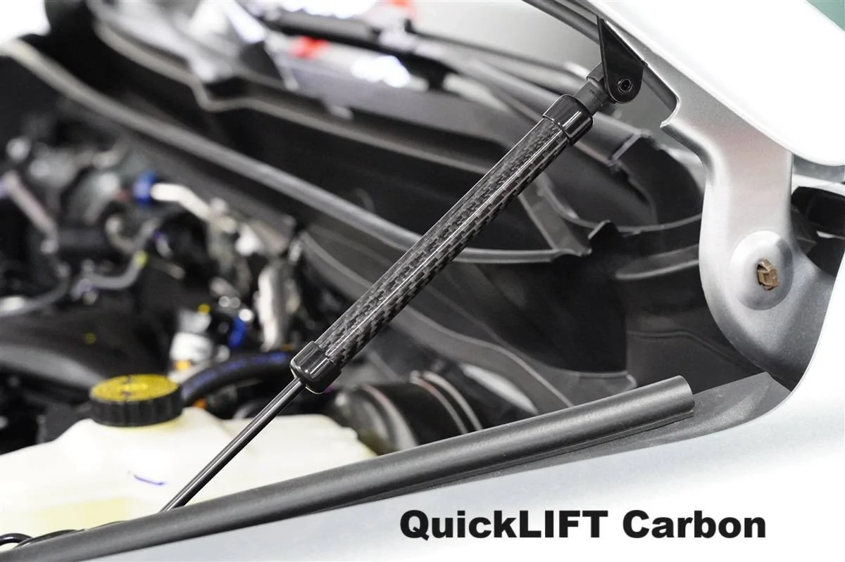

QuickLIFT Carbon :
Real Carbon fiber sleeves that can be added to our PLUS system as an option.

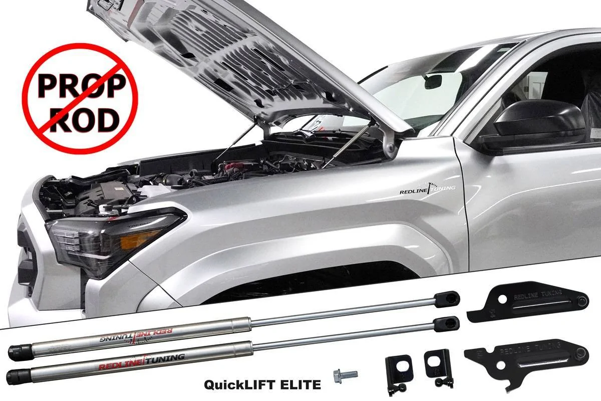

QuickLIFT ELITE features:
* 316L Stainless Steel gas springs
* 5 year warranty
available directly from our website here: https://www.redlinetuning.com/2024-Toyota-Tacoma-Hood-QuickLIFT-ELITE-p/21-27022-03.htm
Both the PLUS and ELITE system function identically it's just personal preference on the finish of the gas springs.
