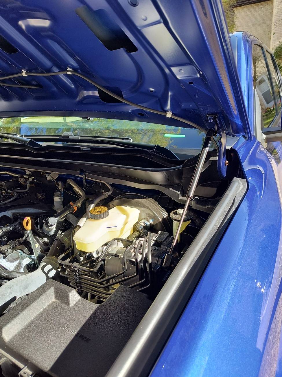

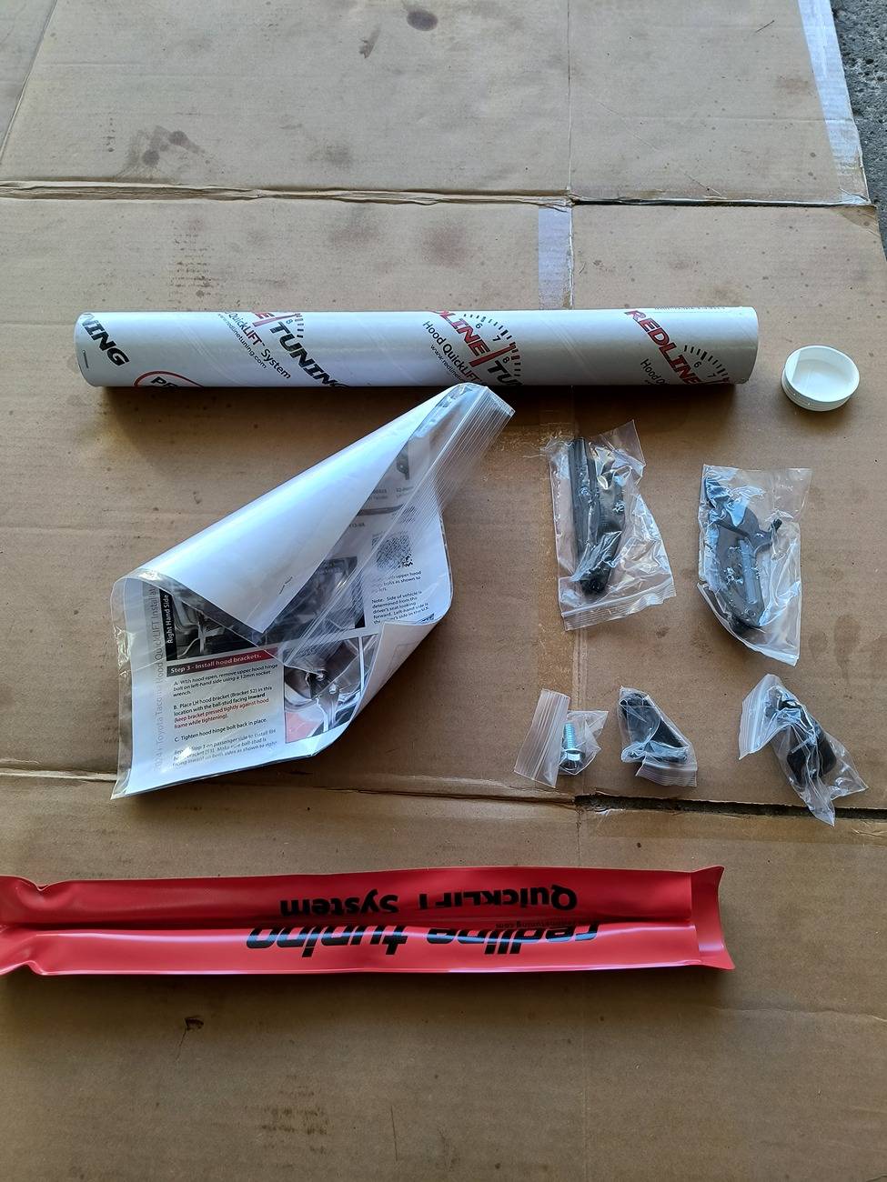

I also just installed this hood prop. No unusual concerns here. Packaged well, very detailed instructions, and very easy to install. I would recommend Redline Tuning in a heartbeat . Great product.
