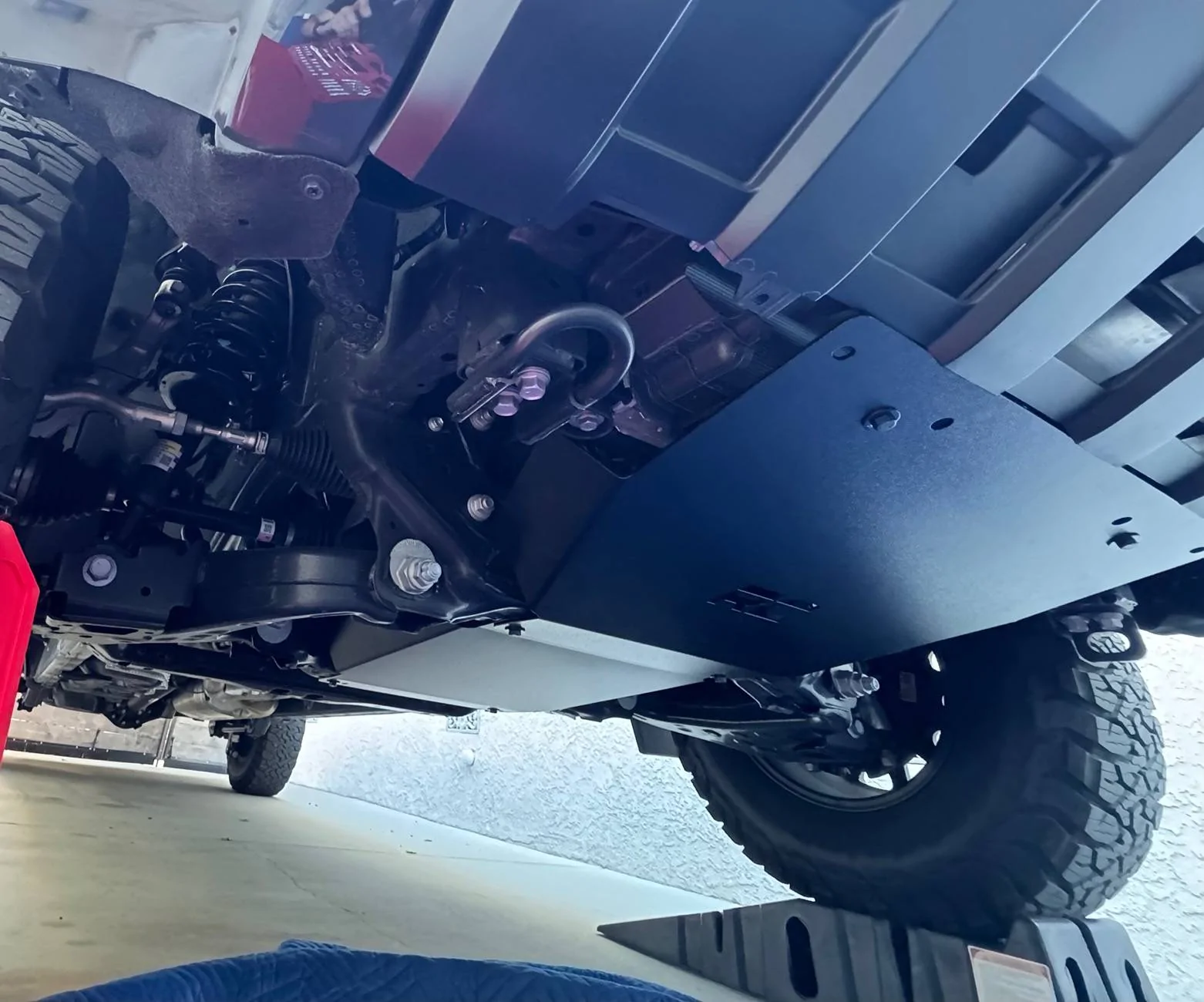

The skid plate is great. Super heavy and thick. I cut out my own access holes for the oil filter, oil drain, and front diff drain. Put nut inserts and fab'd aluminum covers over the holes.
WOW! I’m noticing that now. Freaking awesome work ? How’d you go about cutting the access holes? I recently got the RC skid plate installed the other day. I definitely got to get these access points now. AND the aluminum covers ! Lol

Metal hole saws, Cutting wheel, metal jigsaw blade. Rivet type nut inserts. Drill press. I have access to a heavy equipment shop
