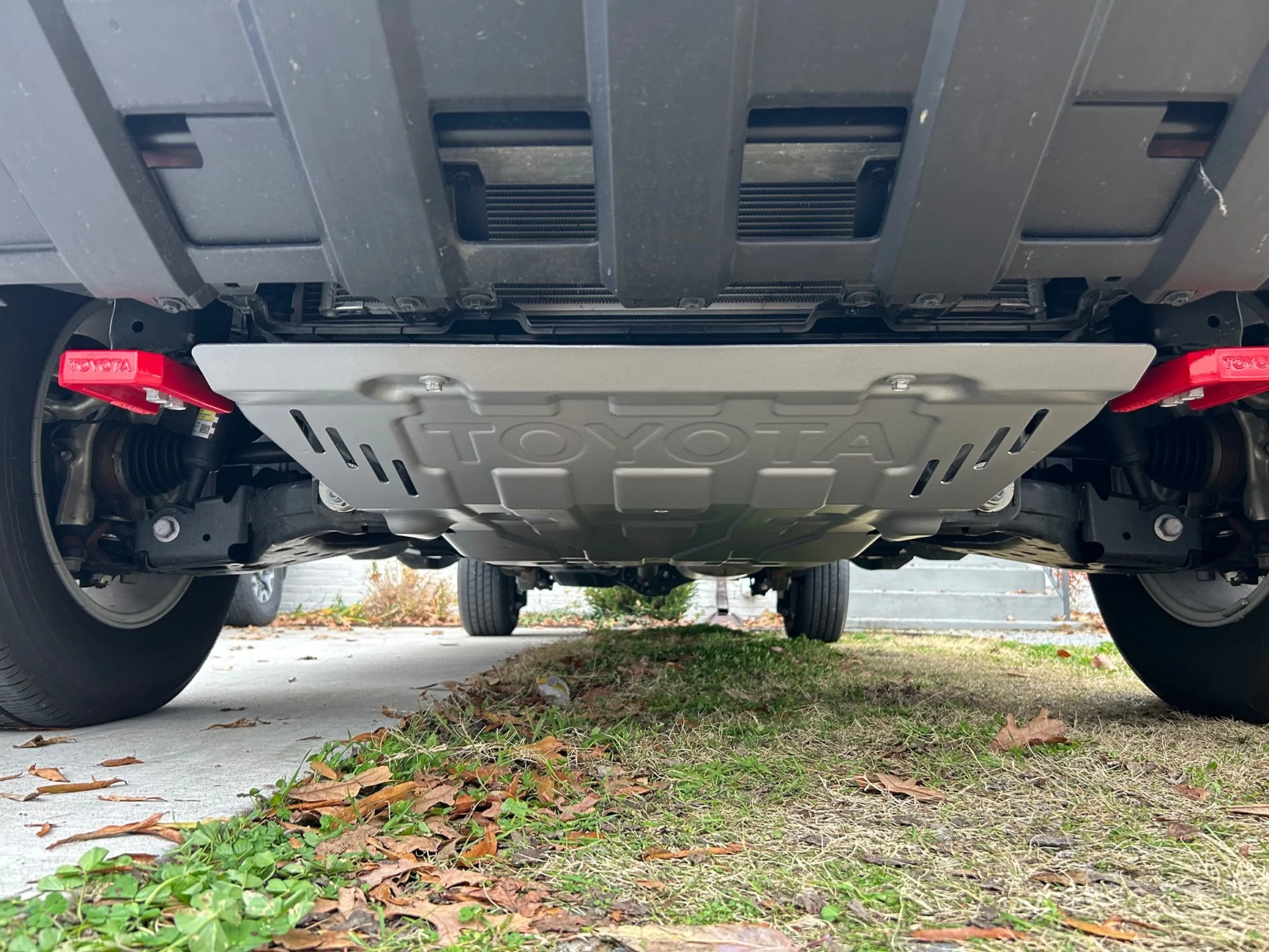

I have the OEM TRD (aluminum) plate on mine. Like you said, it has the two elongated holes so that you can sit the plate on those and take out the other 4 bolts and just slide it off. Super easy to do by yourself too.

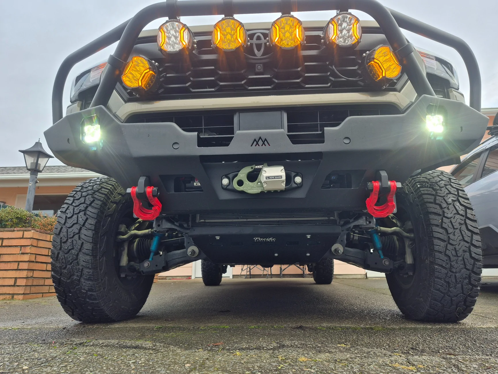

Agree, you will need to buy the cross member. I have 1/4" aluminum full skids underneath mine and access to everything is easy. Installing was simple due to the rear of the skid plate hangs off of the two bolts, while you put the bolts into the cross member.
To make oil changes easier I installed a fumoto valve.
Very Functional and would recommend.

+1 for the “TOYOTA”/LC skid. Super easy to install and you will require the additional crossmember being a SR5. Plenty of access at my stock height and the wide holes def made it easier. I added the OEM front recovery points while I was at it.

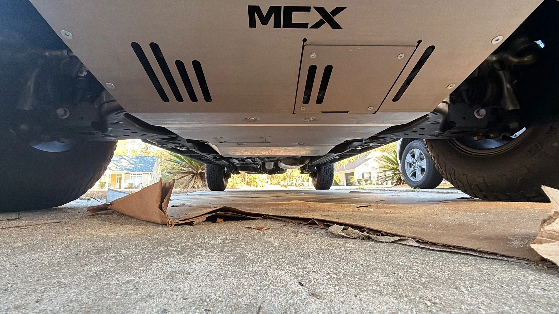

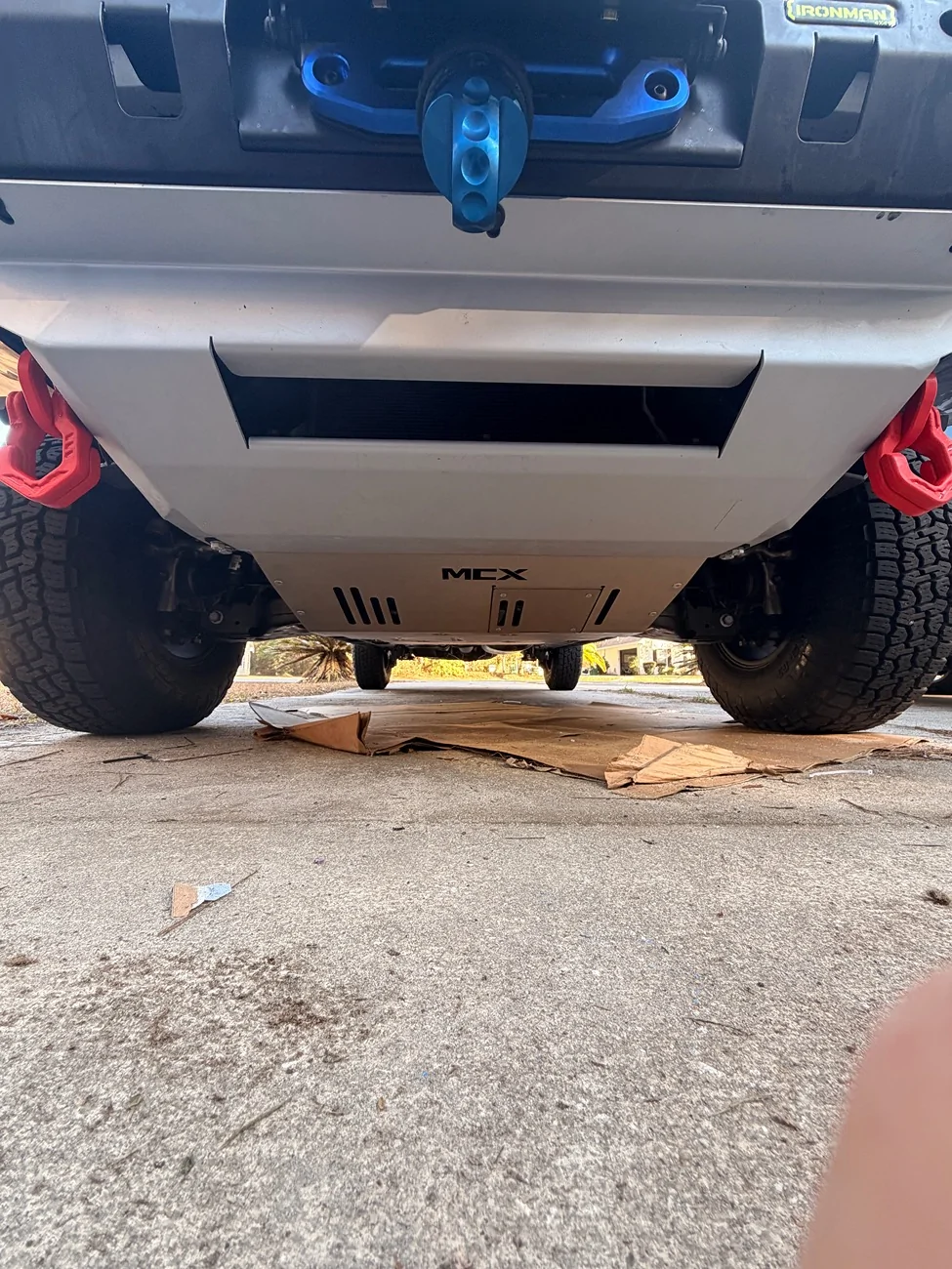

Millercat makes a great product.
