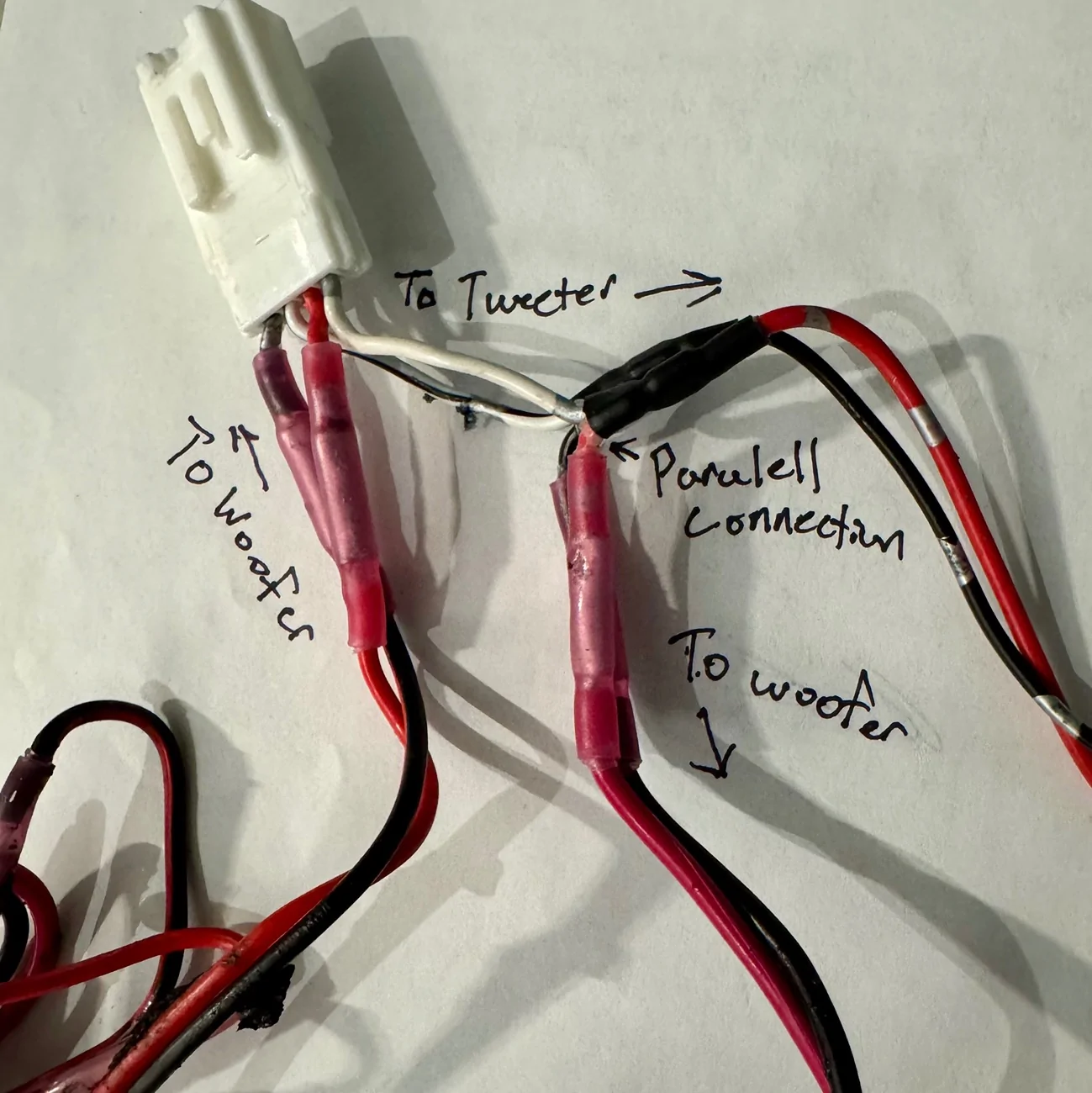

Clayton4x4
Apr 17, 2025
Seattle
2024 Tacoma DCLB TRD Off Road
The harness for the dash has the parallel connection to the door come out of the harness and back in. Here I have a JL Audio inline crossover going to a CF-350 MT, and an inductor low passing the signal to the door with a JL C1-650se woofer.
They were wrapped in foam and there was plenty of room for them in the dash location
