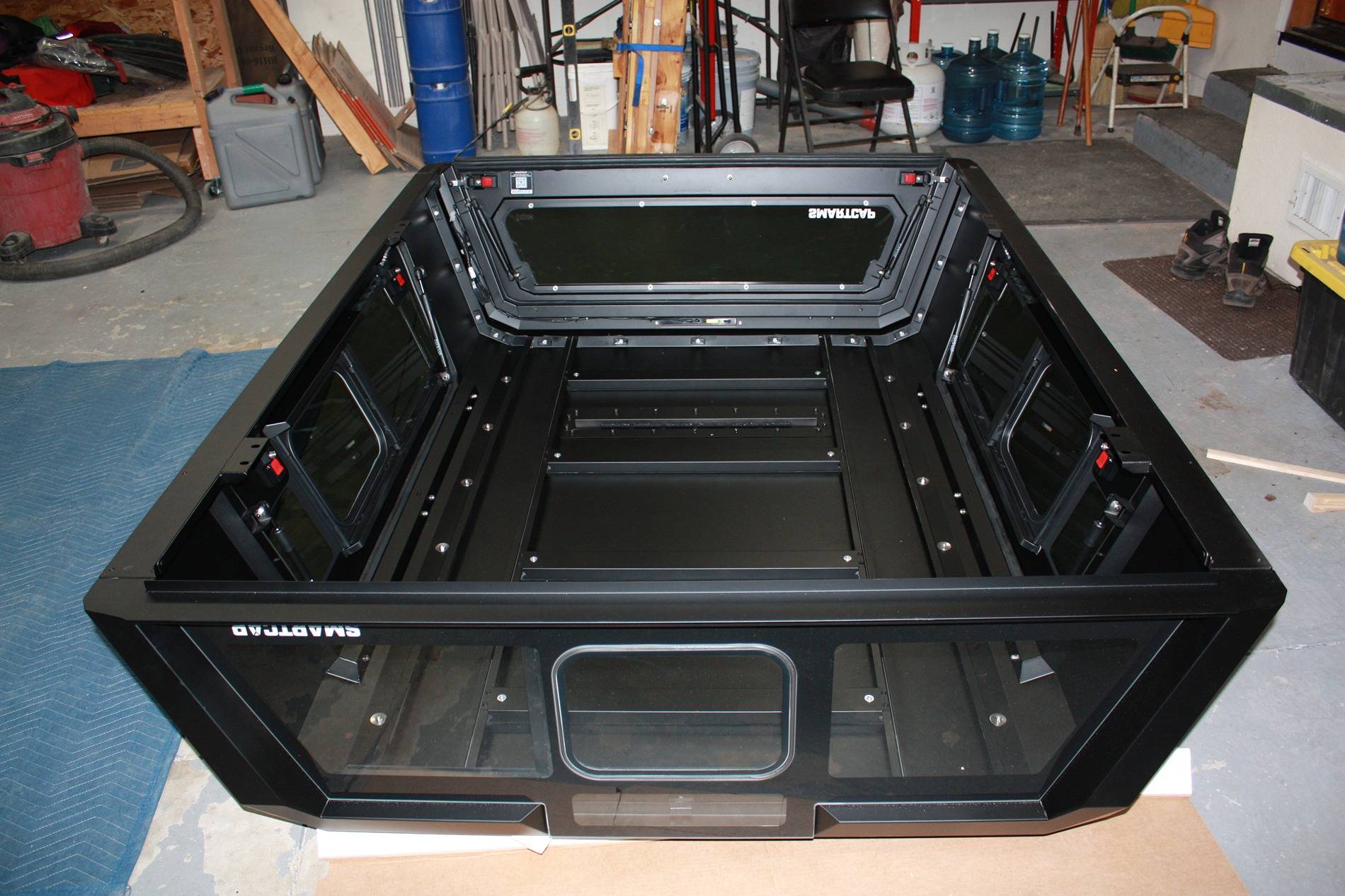

I put mine together yesterday. Picked up a 20-200 inch-pound torque wrench from O'Reily's Auto Parts because my existing in-lb wrench didn't go low enough. (Am now the proud owner of 5 torque wrenches).
Today's tasks are to get the gasket on and mount it on the truck.
Unfortunately, they were out of wiring harnesses, so I have to wait to hook up the top brake light.

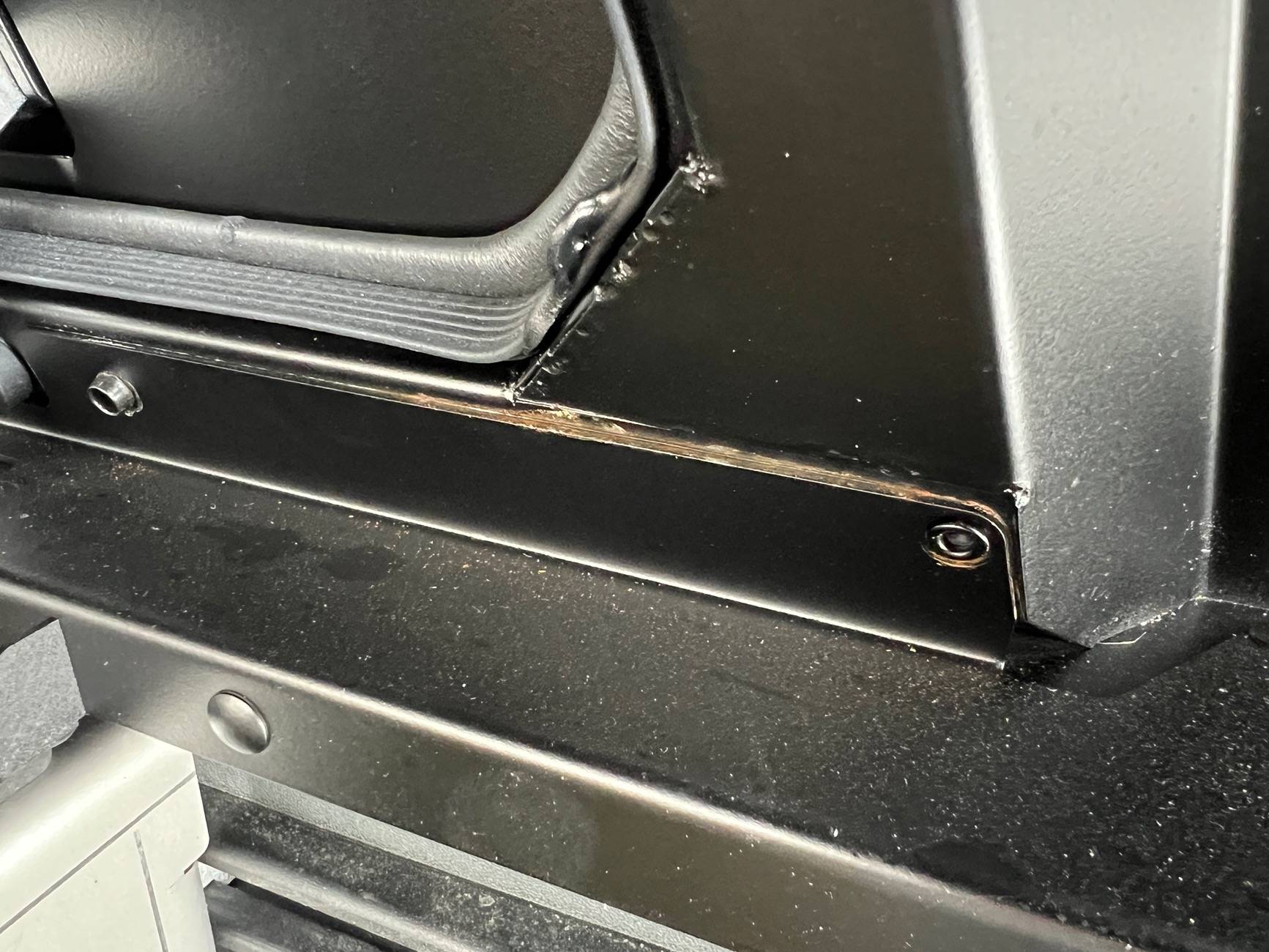

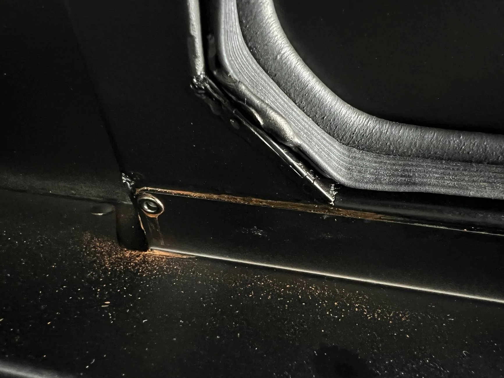

@soupy1234 I'm getting rust dust along the inside bottom pinch welds/rivet areas on both side panels. Are you seeing anything like that? I checked the stainless and its 3CR12, which is not as corrosion-resistant as the typical 304 stainless steel most folks are familiar with. But based on my google-Fu, the rust should only be superficial. Other that, tops are awesome!

I haven't noticed any, but I keep my truck in the garage, and we've had a very dry winter this year.
They probably went with 3CR12 for cost and workability. It is handy that it's magnetic for doing temporary mounts.
Agreed on the material choice reasoning. I have a couple very small usc-c rechargeable unilite k-550’s in the truck and love sticking them inside the topper.
I’m sure mine was from overzealous pressure washing at the car wash but I didn’t expect rust.

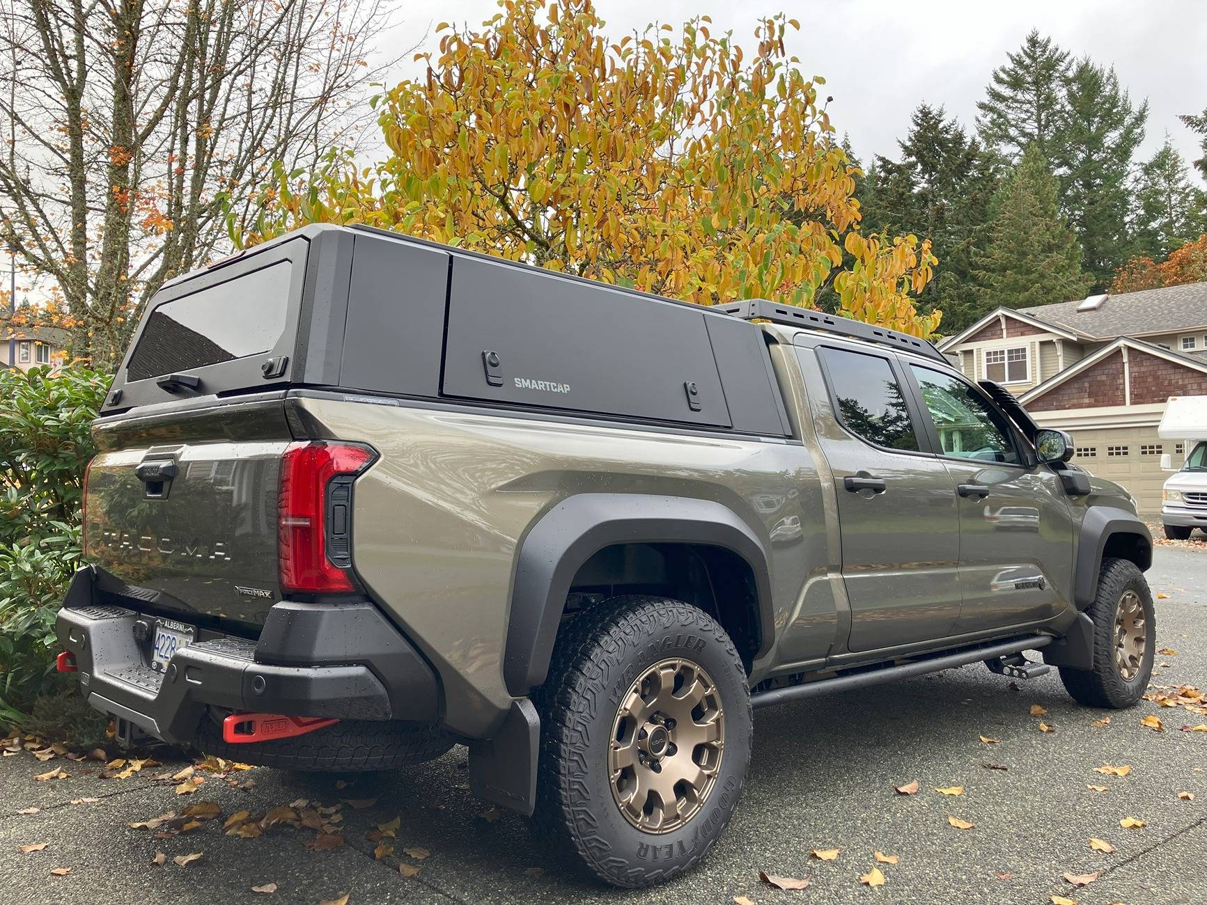

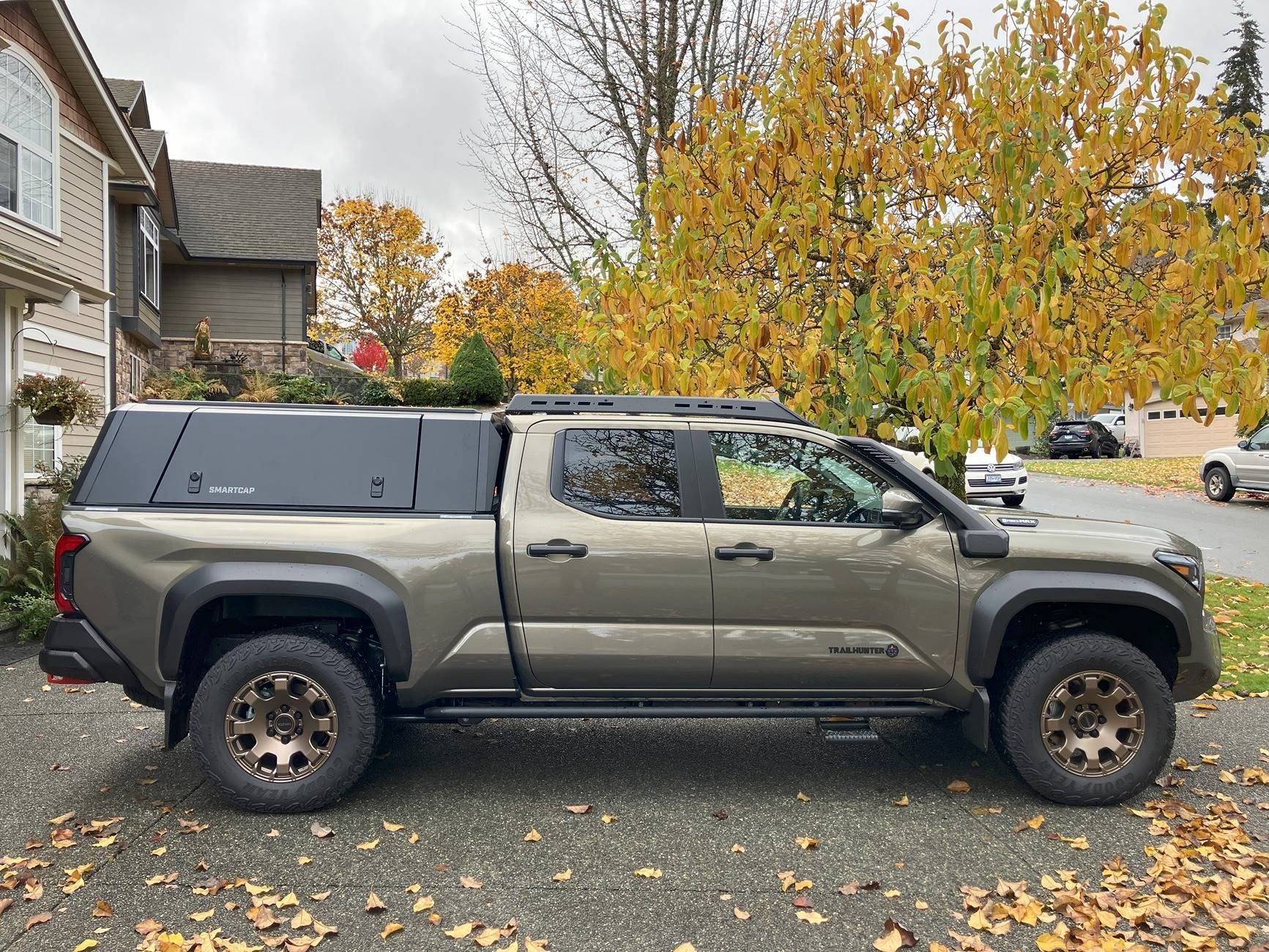

2024 Tacoma SmartCap EVO Bed Cap installed on 2024 Tacoma TRD Off-Road IMG_5965
2024 Tacoma SmartCap EVO Bed Cap installed on 2024 Tacoma TRD Off-Road IMG_5962
