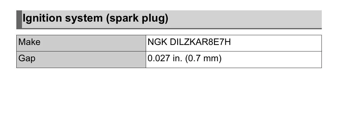

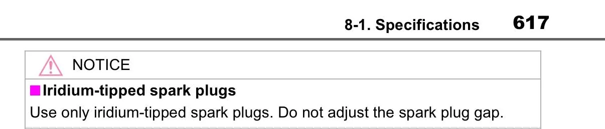

Thanks brother. I’ve looked every other week or so since August. Even NGKs site doesn’t list the plug (or any fitting plug for that matter) and they make the dang thing. Here’s a couple pics from our manuals:
2024 Tacoma Spark Plug Mystery 🔍 IMG_2318
2024 Tacoma Spark Plug Mystery 🔍 IMG_2319

I tried to find it on the website.... you're right.

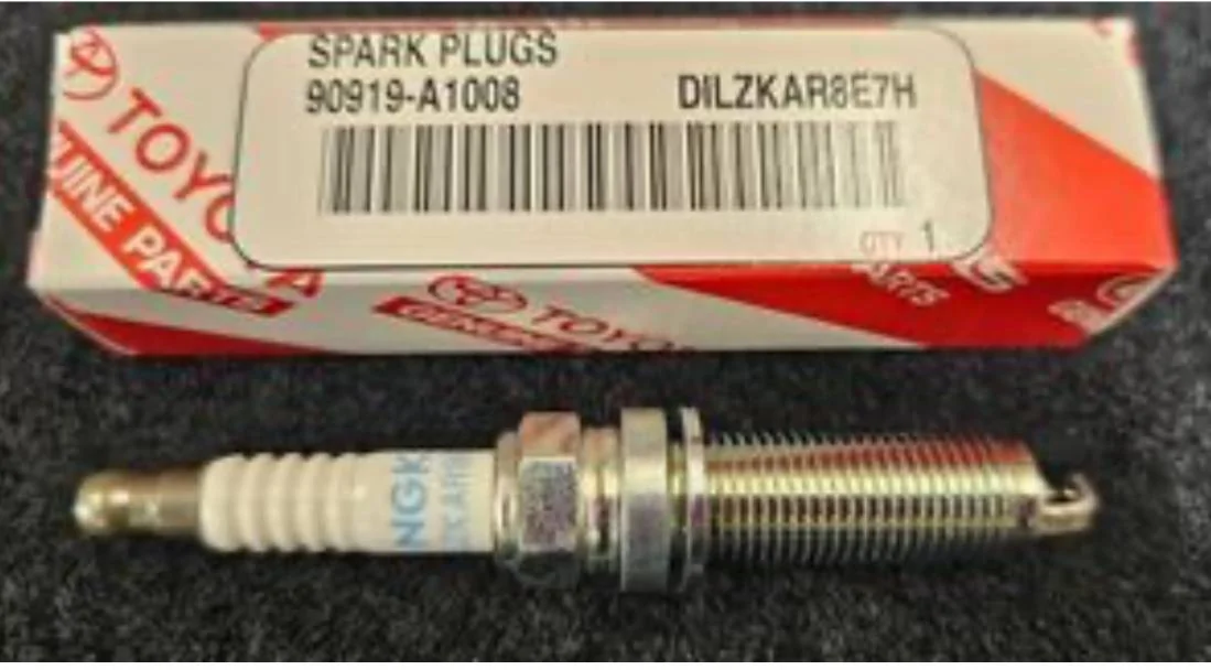

Add: you can also see 90919-a1008 bleed into eBay a bit but that’s inconsistent and still $30 a pop minimum before tax and shipping

Just got off the phone with the NGK tech team. After going up a couple rungs on the corporate ladder I was told Toyota indeed does control them in the aftermarket department and is the approving authority on releasing them for the aftermarket. They told me verbatim aftermarket release “has been proposed but has no release date” and that “it could be years still”.
After looking at their other plugs for iridium tipped 9/16” drive and 0.027 gap they confirmed they have no alternative.
So Toyota is playing their cards so that they hope when drivers begin approaching their first plug change interval of 40k so they can charge an abhorrent amount of money for a 10 minute job. You can pay $150 after tax and shipping to get the same reboxed spark plugs from the dealership so Toyota will still make a fat penny either way.
