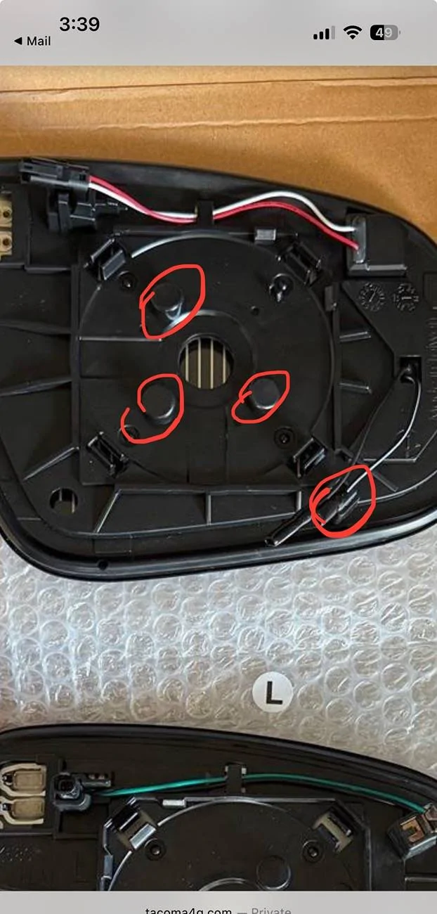

Yeah that’s what I used to install mine, careful not to drop your mirror cap and scratch it up like me lol. Also beware if they still sending out the same quality stuff as what I got you’ll have to trim parts of the plastic on the back of the suma for it to properly clip into place on the 4g

Care to point out what parts need to be trimmed?

circled in red, total 4 locations. If you look at the full picture of the side by side (suma next to oem on page 1) you can see that those 4 spots I circled are in slightly different locations compared to the oem.
Did you also receive a set that looks like mine? Supposedly they said they fixed it.

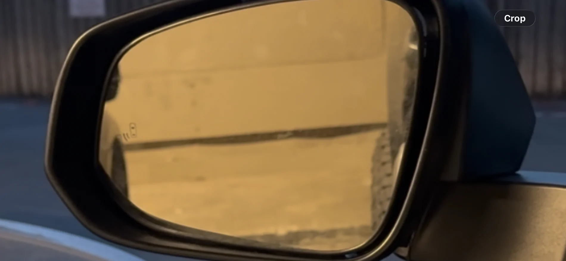

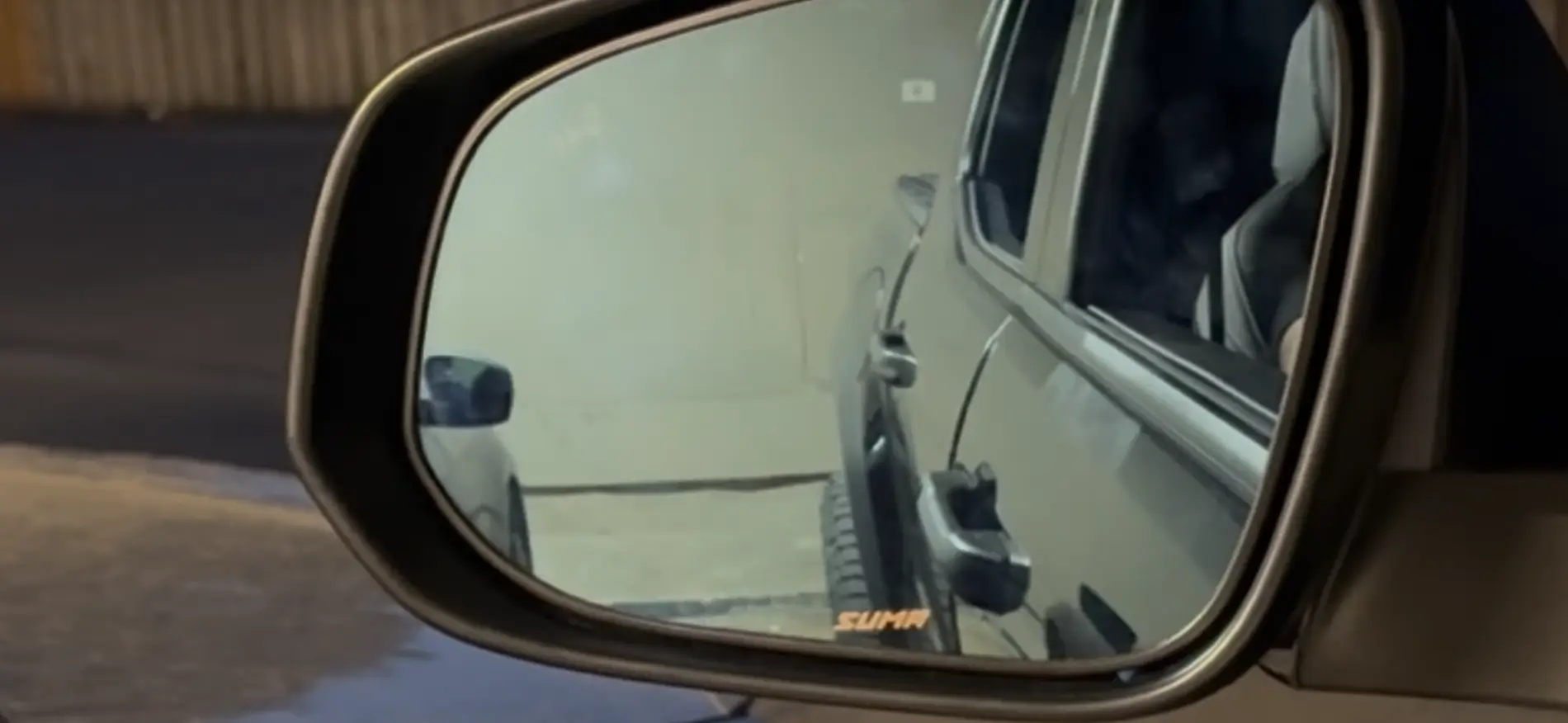

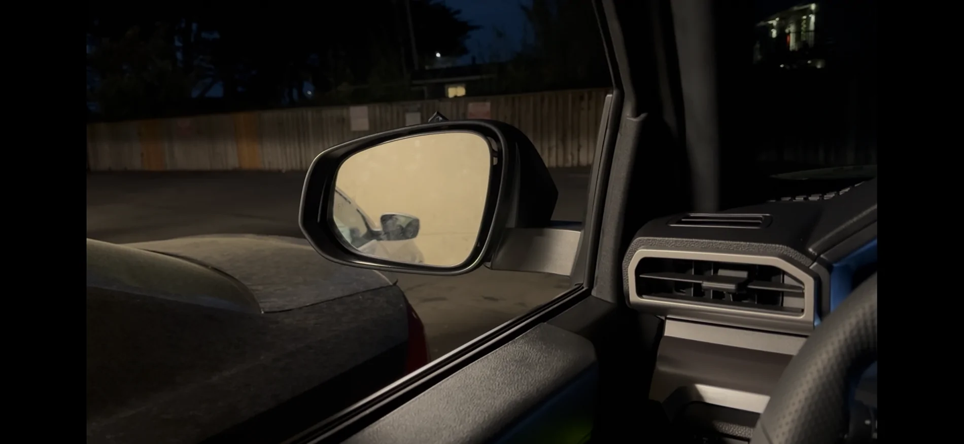

I installed these today on my Tacoma. I’m not liking them so far it seems like the only FOV I gained towards my truck. I reached out to Suma to see if maybe mine are defective. I’m pretty sure these mirrors don’t have as much travel around the housing because i dont think they point down as far down or to the left as the OEM mirrors.
Has anyone else installed them on their Tacoma and had a different experience?

OP here. I had the same concerns and reached out to them as I got these for free to test. They let me know that what you’re getting is and intended. I found that if you move the mirror to the top most position and kind of push it. Worked great and you get used to it. Over a year of using it and it all feels normal.

So you had to manually adjust the mirror to the position you wanted? That fucking blows dude what’s the point of the mirror if it makes it so that you can’t use the electric mirrors? I feel like the issue is the new mirrors are noticeably thicker and since they are convex they make contact with the mirror housing much sooner limiting its range of motion.
