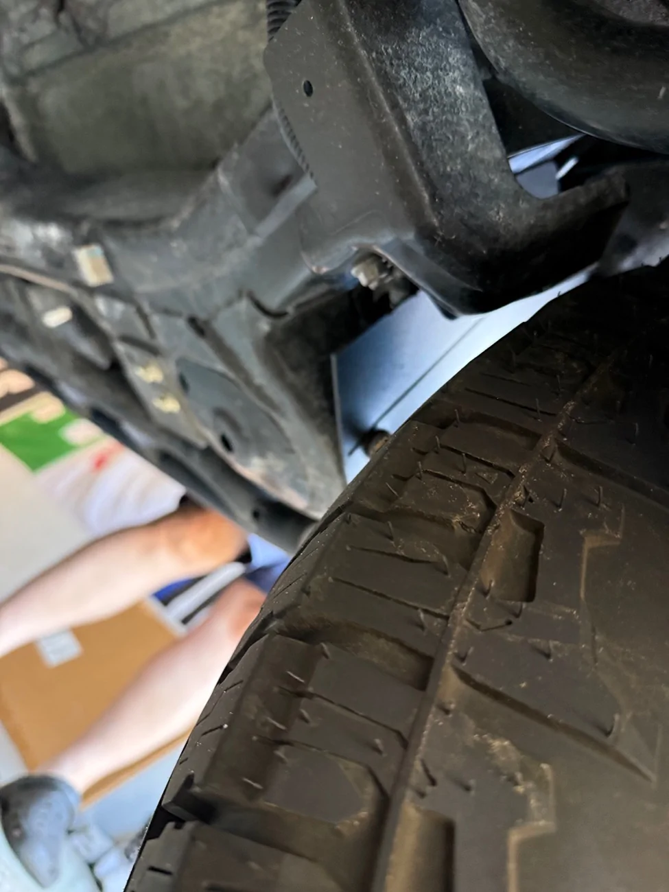

I am not worried about clearance on the bumper or body but iam concerned about the clearance between the 35 and that steel bracket that protects the sway bar disconnect harness.
Anyone running 35s, have you seen this to be an issue?
Photos are the bracket and full lock distance on the 295s.
2024 Tacoma Sway Bar Disconnect Clearance IMG_6379
2024 Tacoma Sway Bar Disconnect Clearance IMG_6376
2024 Tacoma Sway Bar Disconnect Clearance IMG_6382

Yes, it is in the way. Easily solved. Check my build thread for details.

Oh sweet, just read it, just the info iam looking for, and cool build too.
When running the harness over the frame, i don’t need to extend the harness right? Just disconnect, route over, and remove shield right?

Correct. No extension needed. It is snug, but works fine. Happy the info helps!
