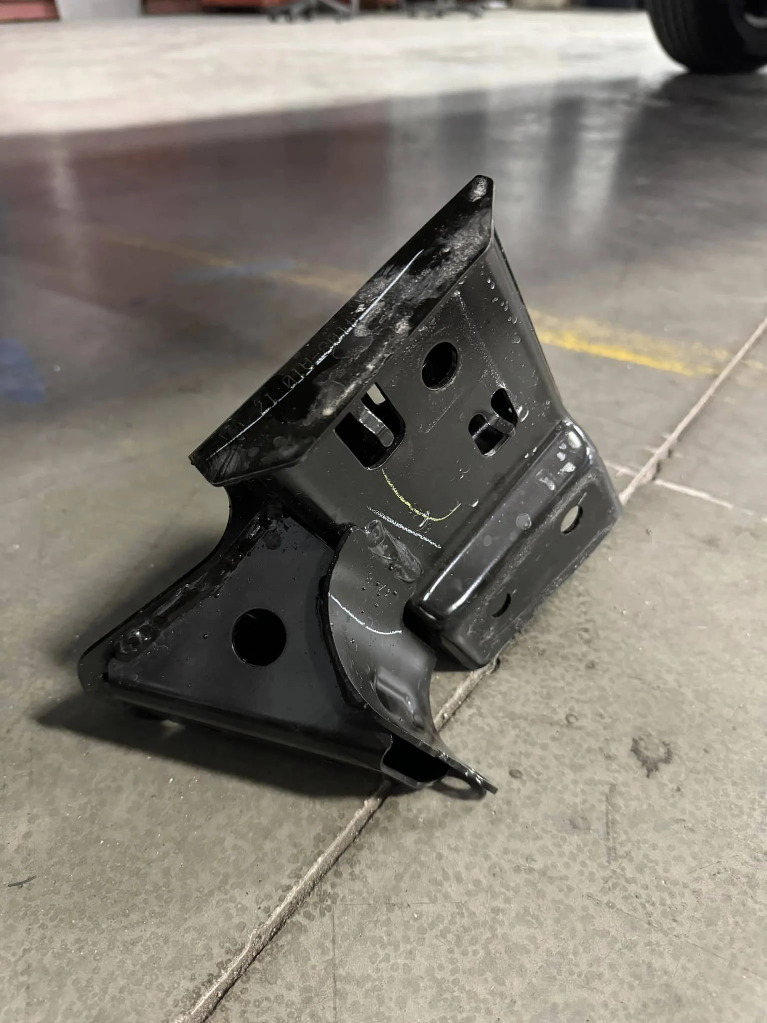

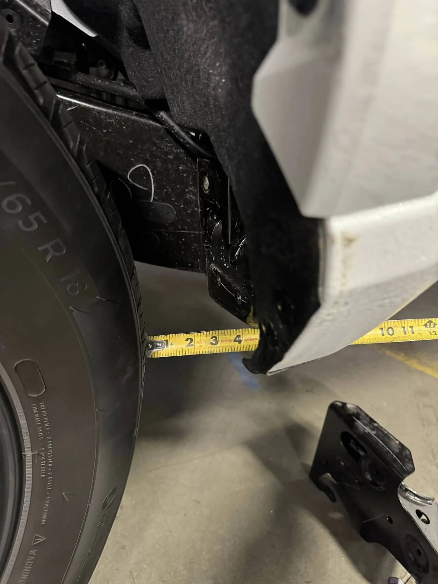

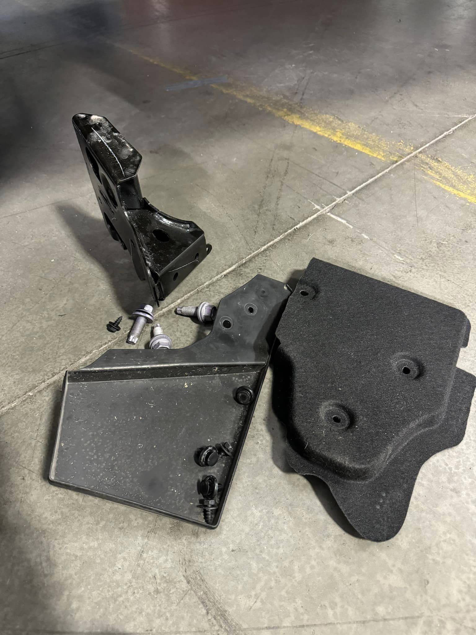

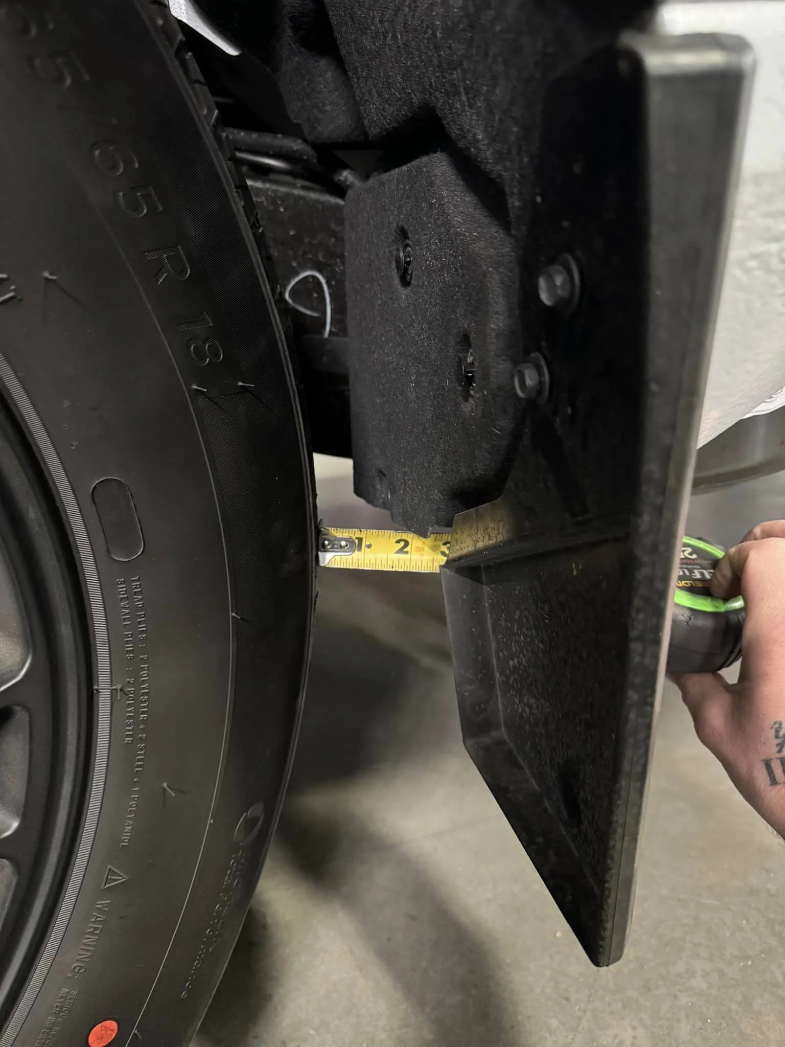

So this is how you can easily gain 2" of turning clearance to fit bigger tires on the 2024 Tacoma. You just have to remove this crash bar bracket.
Steps:
1. Remove the mud flap
2. Remove felt cover
3. Remove bolts from steel bracket to remove from body mount
Note: the braacket is called a crash bar and helps prevent the tire from coming into cab in a collision.
PHOTOS:
Bracket Removed
2024 Tacoma How-to: get bigger tires clearance on 2024 Tacoma -- bracket removal DIY bigger tires  2024 Tacoma no rub remove crash bar bracket 1
Bracket, Mud Flap, Felt Cover Removed
2024 Tacoma How-to: get bigger tires clearance on 2024 Tacoma -- bracket removal DIY bigger tires  2024 Tacoma no rub remove crash bar bracket 2
Stock Clearance Measured
2024 Tacoma How-to: get bigger tires clearance on 2024 Tacoma -- bracket removal DIY bigger tires  2024 Tacoma no rub remove crash bar bracket 4
Clearance Gained After Removing Bracket
2024 Tacoma How-to: get bigger tires clearance on 2024 Tacoma -- bracket removal DIY bigger tires  2024 Tacoma no rub remove crash bar bracket 3

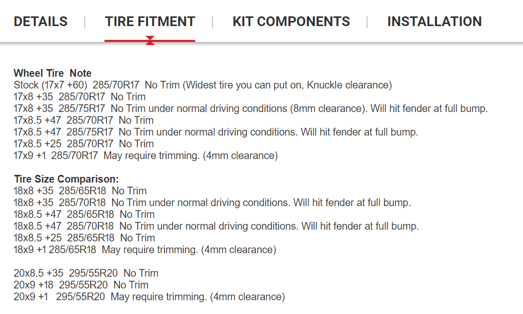

2024 Tacoma How-to: get bigger tires clearance on 2024 Tacoma -- bracket removal DIY YzExJIs
w00die
Scott
Feb 27, 2024
Virginia
Gen 4 Tacoma SR5
I wouldn't have a problem removing the cab mount bracket if I was trying to run 34's or 35's, that's why they made it removable in the first place. Most 33" setups are fine though.
Where did this fitment chart come from? Thanks.
