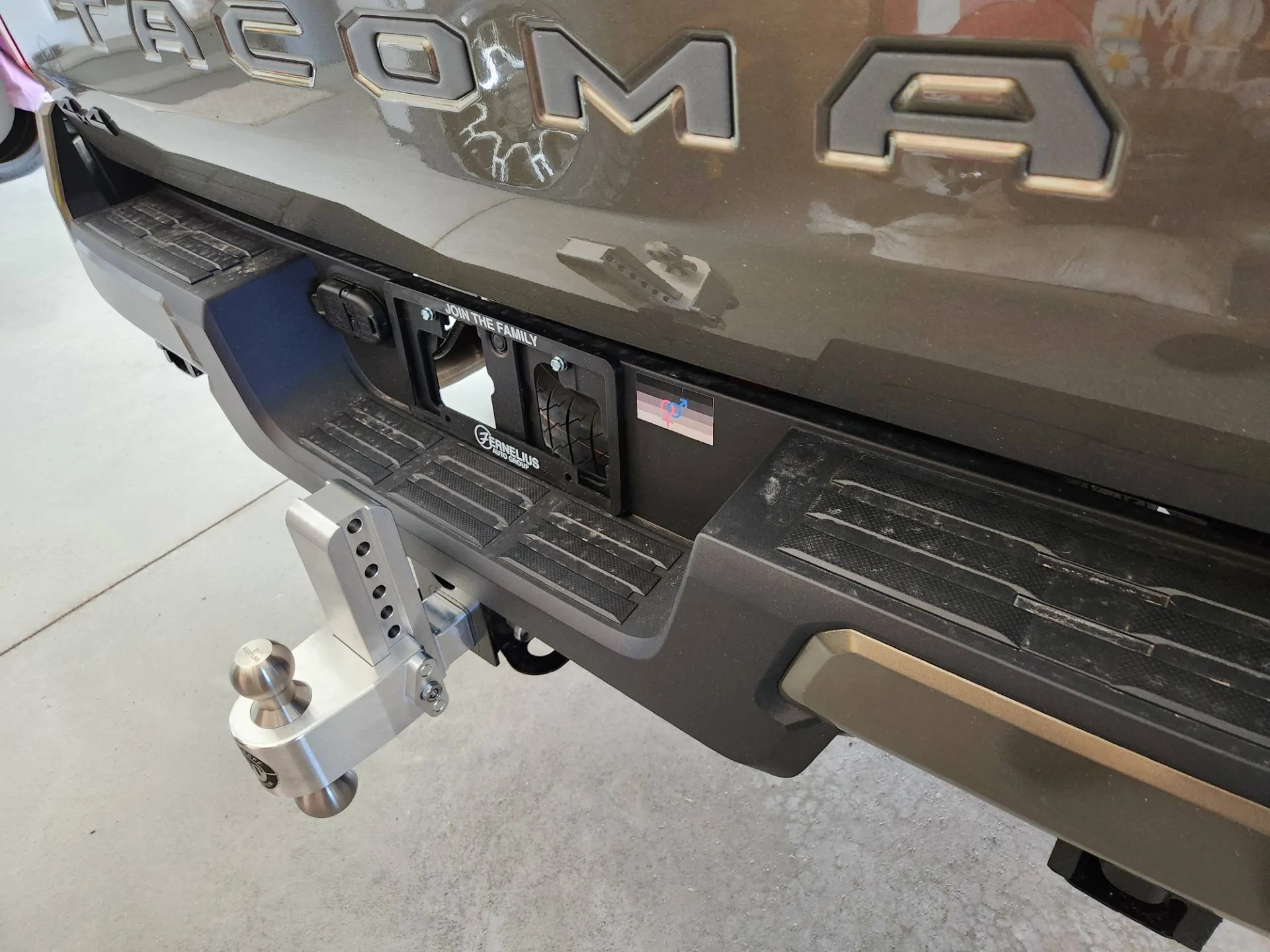

What draw bar do you use?
Here is what I picked up today:

I've been pulling with the dealer supplied hitch and ball lol. Nothing I've pulled so far is heavy and for the amount that I'll ever tow behind, it's probably all I need ?

That's too pretty to use. LOL.
I picked one up from harbor freight for like $139. Looks the same. The small utility trailers at work are too low for the new taco. Never thought I’d need a drop down for a mid size truck. Lol
