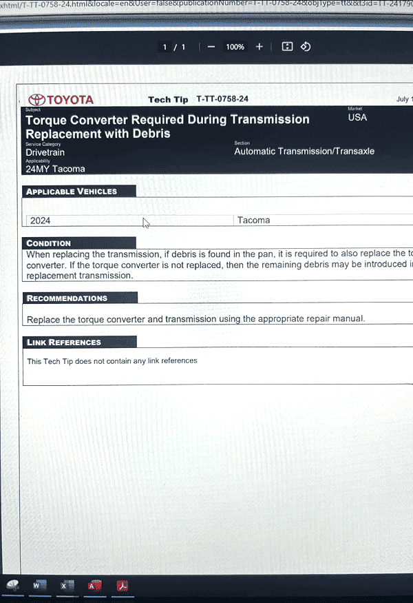

Thought I’d share this….so far this is all we have that Toyota put out to their dealers.

So far I haven't had any issues with mine. If I do does it have to be towed in?

My 4th gens Tacoma transmission also failed, losing gears 1-5, at 1200 miles. I posted a Reddit thread about it here.

I would assume so. It sounds like most people are losing gears 1-5 and it will only rev at that point.
Technically, I was able to get mine to go from stop so I could get 2 miles down the road to a hotel for the night. What I did notice was it took a high rev to get it moving forward, once up to 35 mph and up, it ran fine... I'd imagine if I had to climb a hill or was in stop go traffic, it wouldn't have been able to make it without overheating the transmission.
