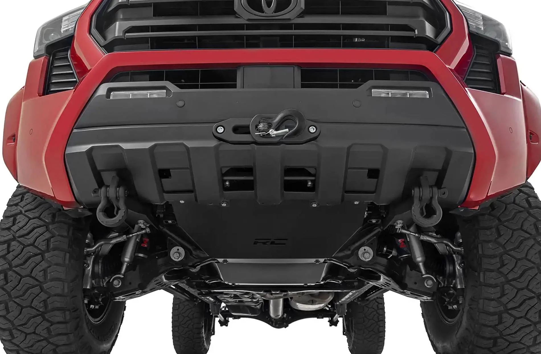

I’ve researched this exact same request: putting a skid plate on a Limited after air dam removal.
Most of the stock skid plates will NOT fit. The reason is the off-road models have an additional cross member under the radiators which most of these skid plates attach to, and the Limited does not have this cross member. Several companies are working an aftermarket cross member, but I haven’t seen any for sale yet.
Another option is to install a hidden winch kit which also contains the skid plates. The best example of this is from Rough Country. Their hidden winch kit has both an engine and differential skid plate, and this kit actually requires removal of the off-road cross member, so it’s an easier install on the limited. Since you don’t have to buy a replacement cross member, this kit is about the same cost as installing just the skid plates, and you get a winch with the package. :) Pic of kit attached FYI. It’s an option.
Good luck.
Good luck.
You can buy the cross member to bolt the stock skid plates to. I believe it is Nytop that sells it.

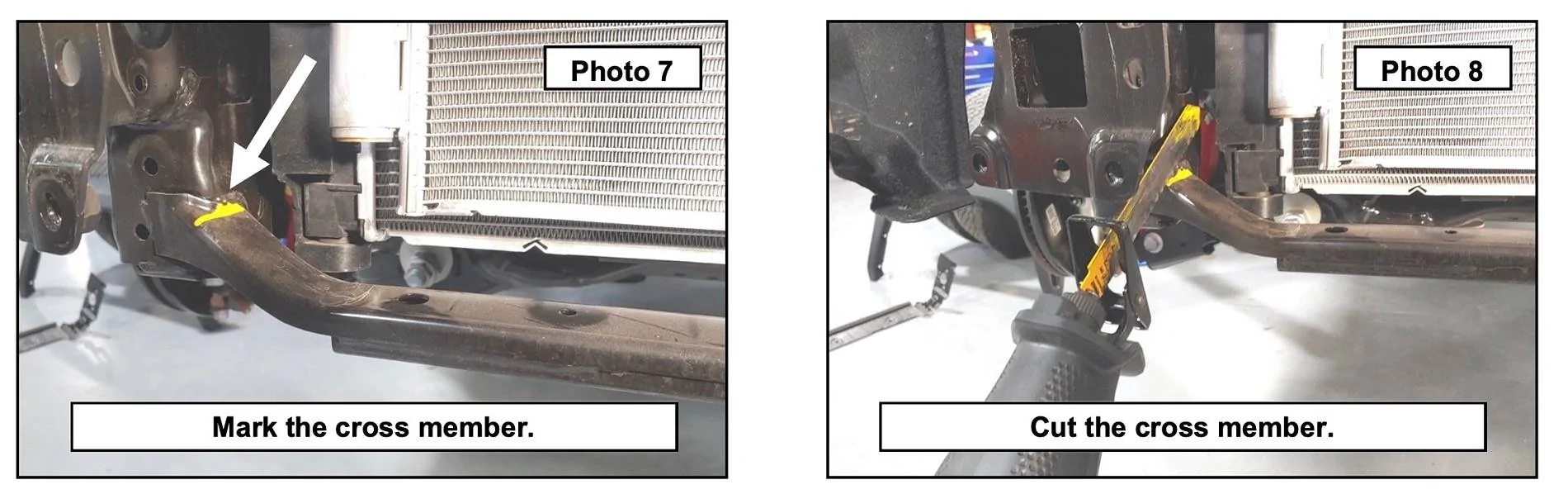

I thought the OR crossmember was welded in? How would they expect someone to remove it?
