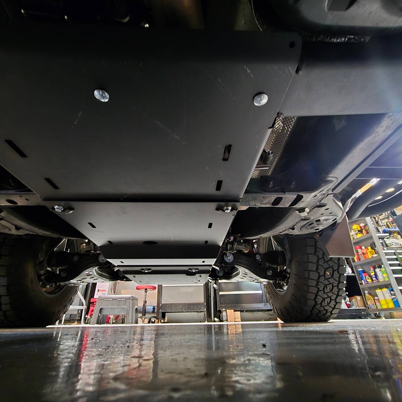

I installed the full set on my Offroad. Nothing to remove except the oem plastic skid
2024 Tacoma RCI skid plate package 20250617_133443
