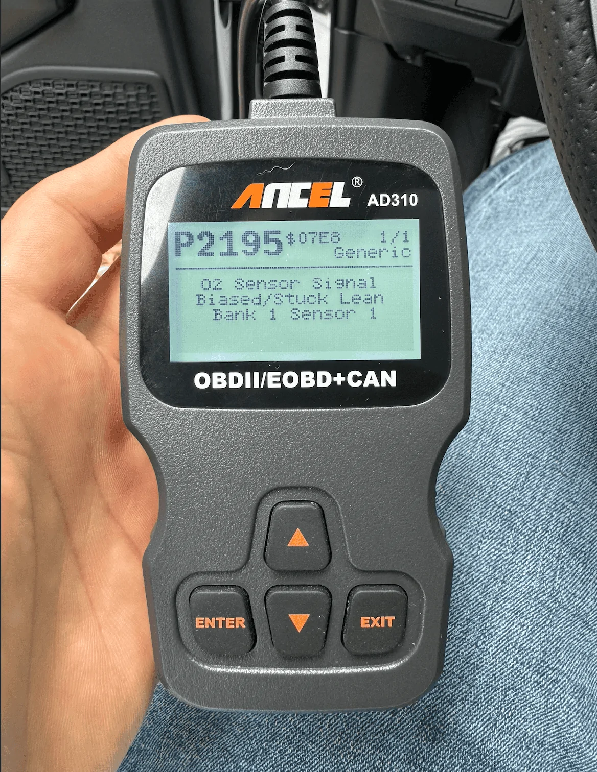

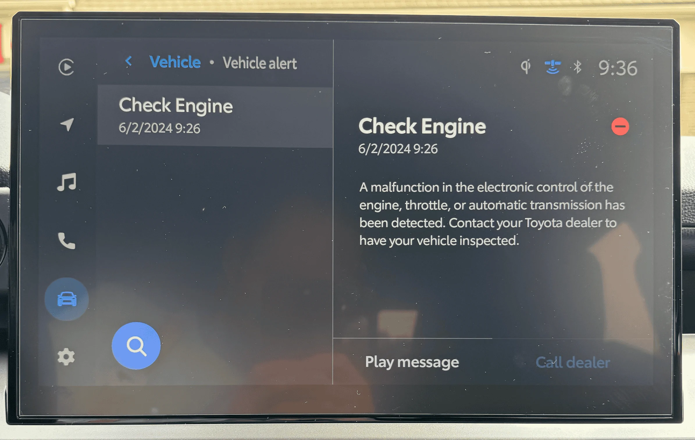

TRD Off Road with 1,150 miles 6 speed manual, check engine light when off this morning on the way home from church. I thought it would be the grill shutter thing, this looks like something different? Truck still drives thankfully.
OBD reader says P2195 - O2 sensor signal biased/stuck, Lean Bank 1 Sensor 1.
I don't want to break any factory warranty so I will have to take it in and see what they say I guess...
ANSWER:
I disconnected the battery for about 10 minutes, and it cleared the code but it came back in about 40 miles (I could feel the problem still before it came back) I would sputter and kick under acceleration.
The dealership just called a while ago, it is the bank one sensor one on the engine side of the catalytic converter.
