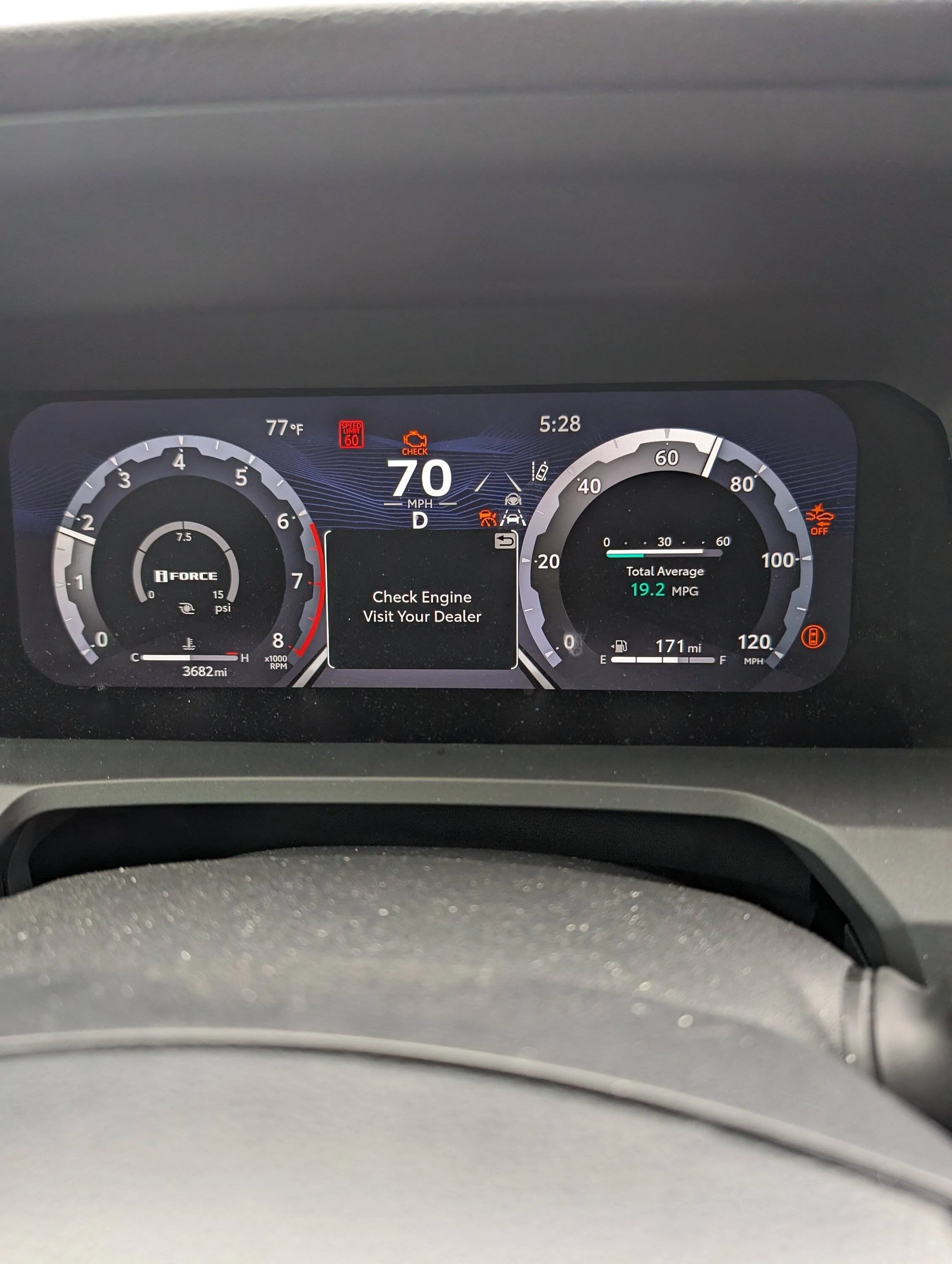

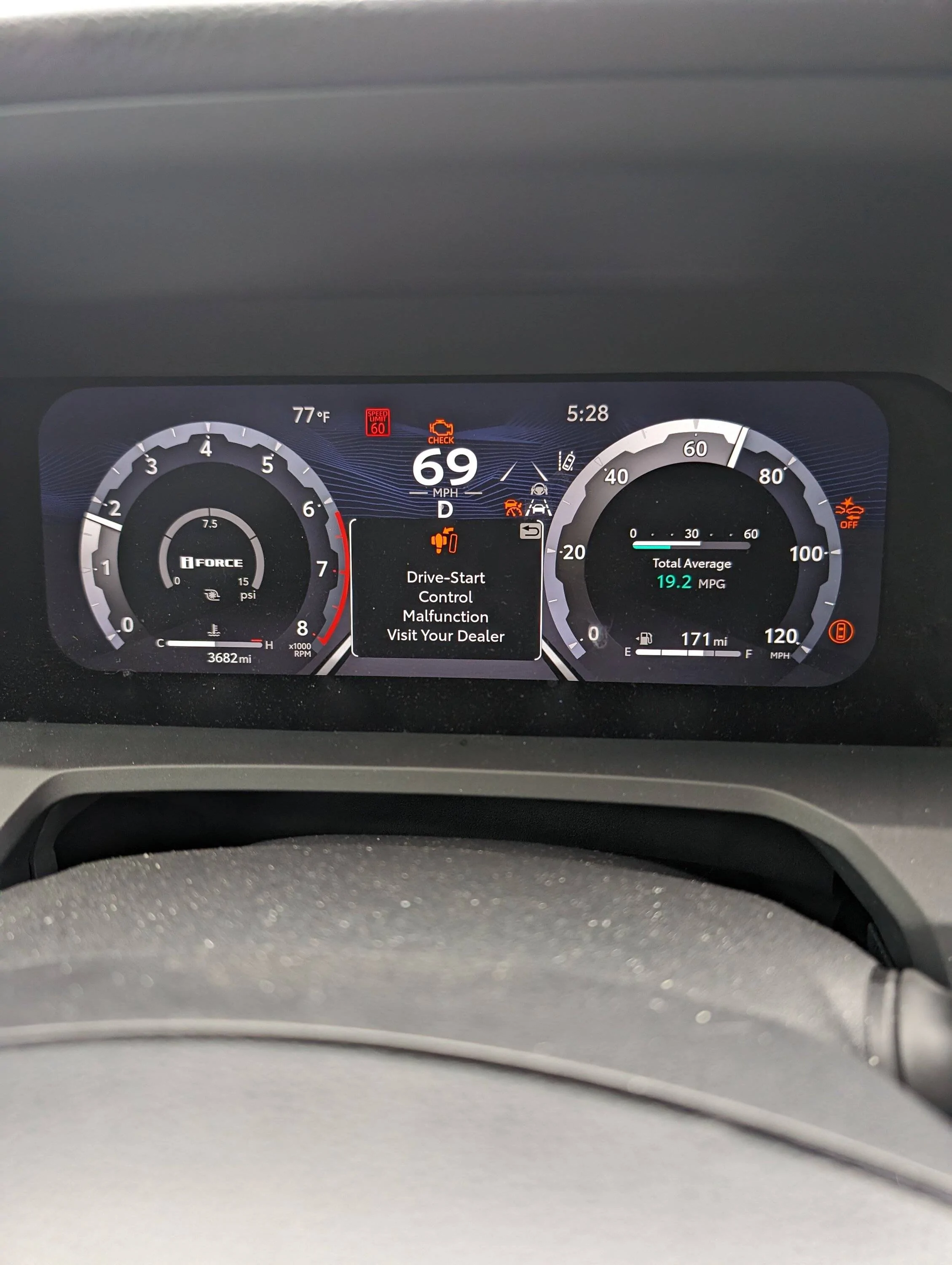

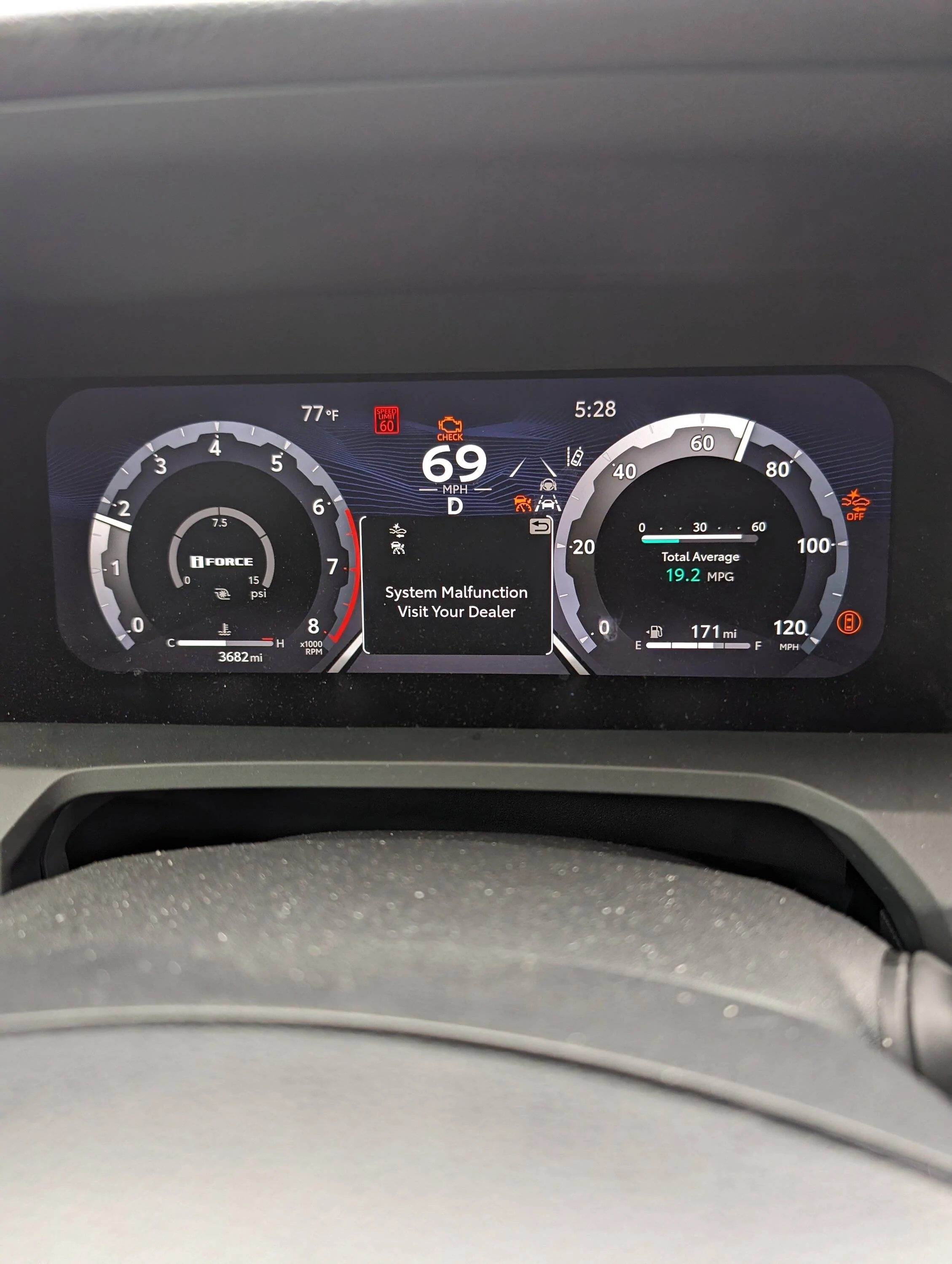

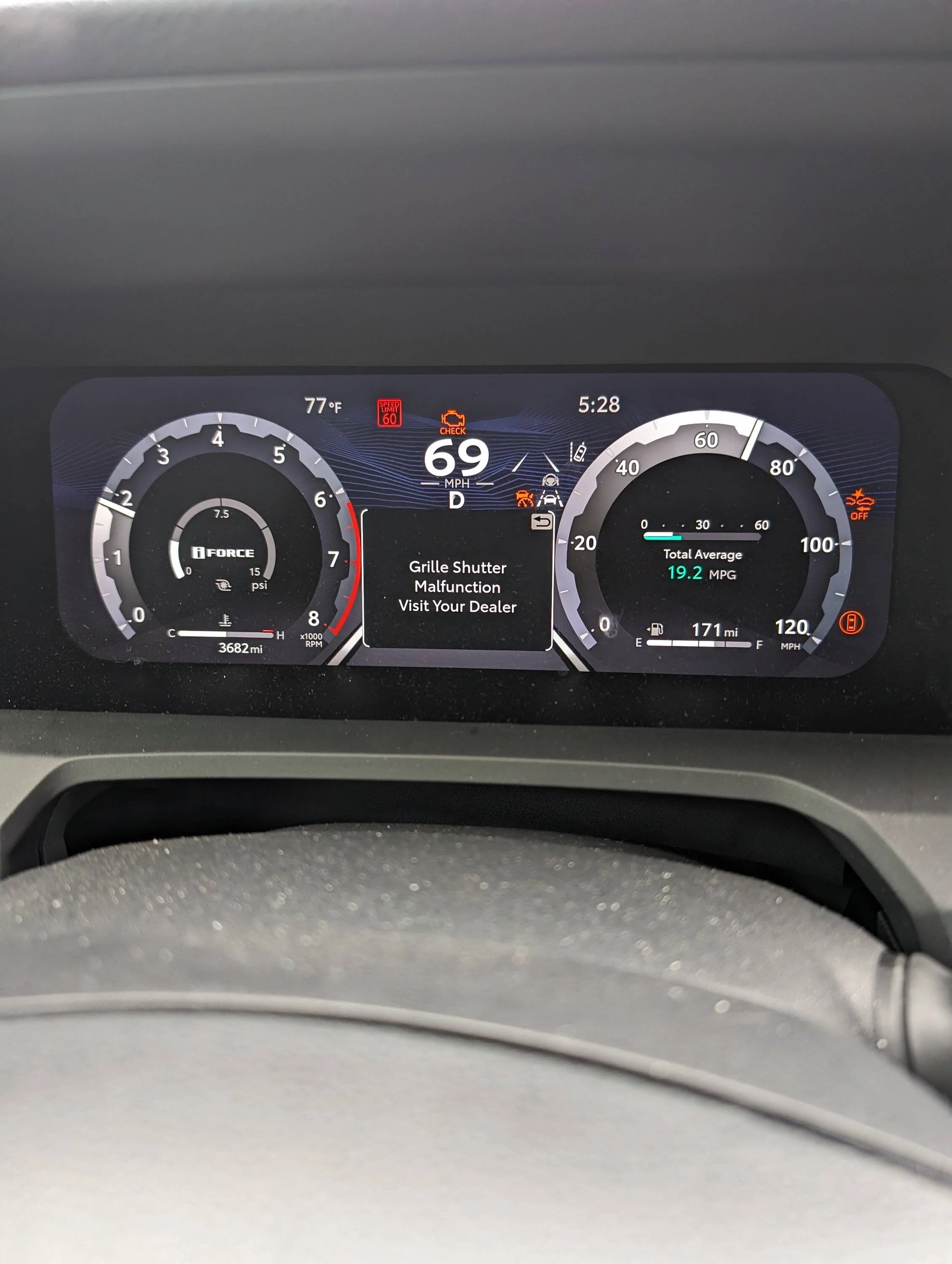

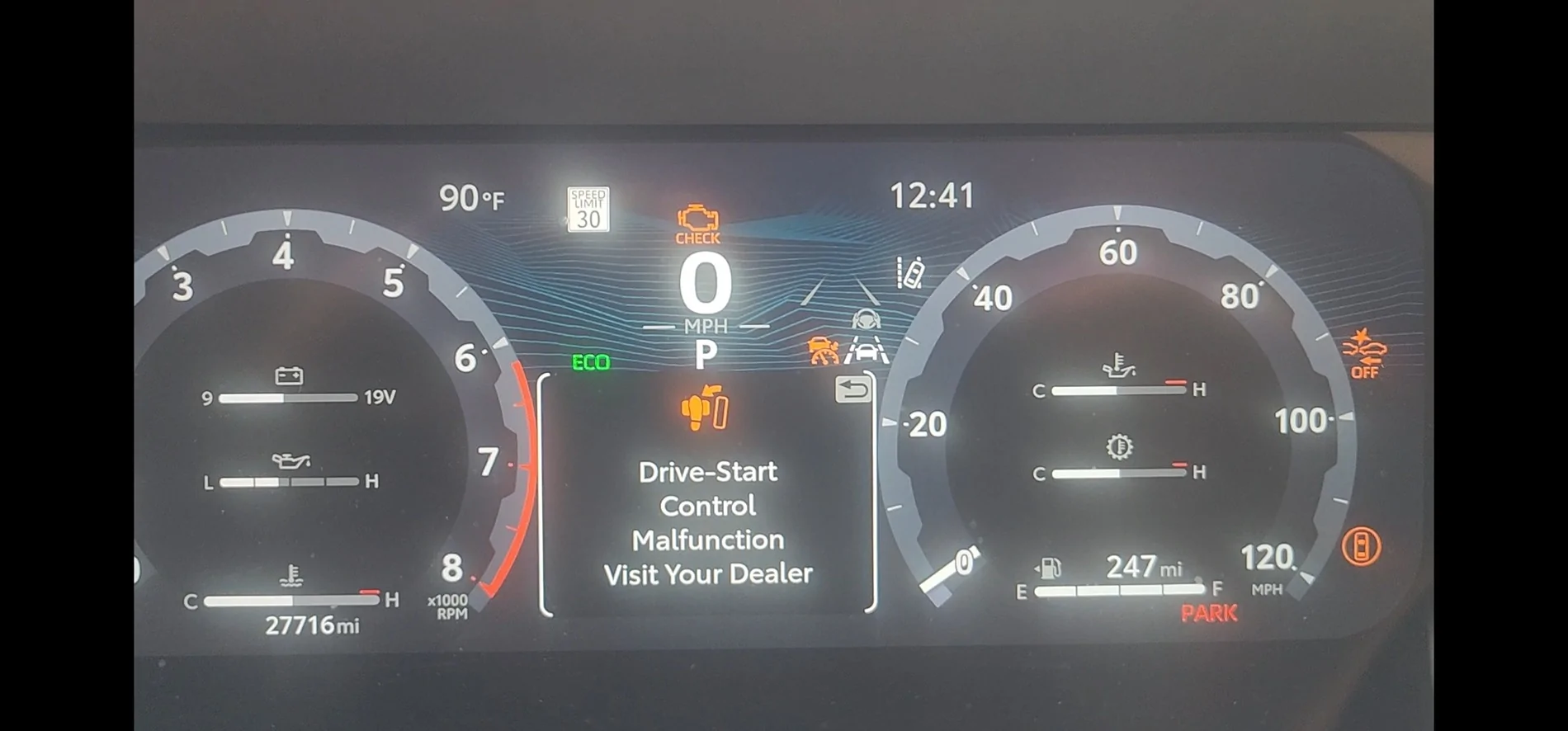

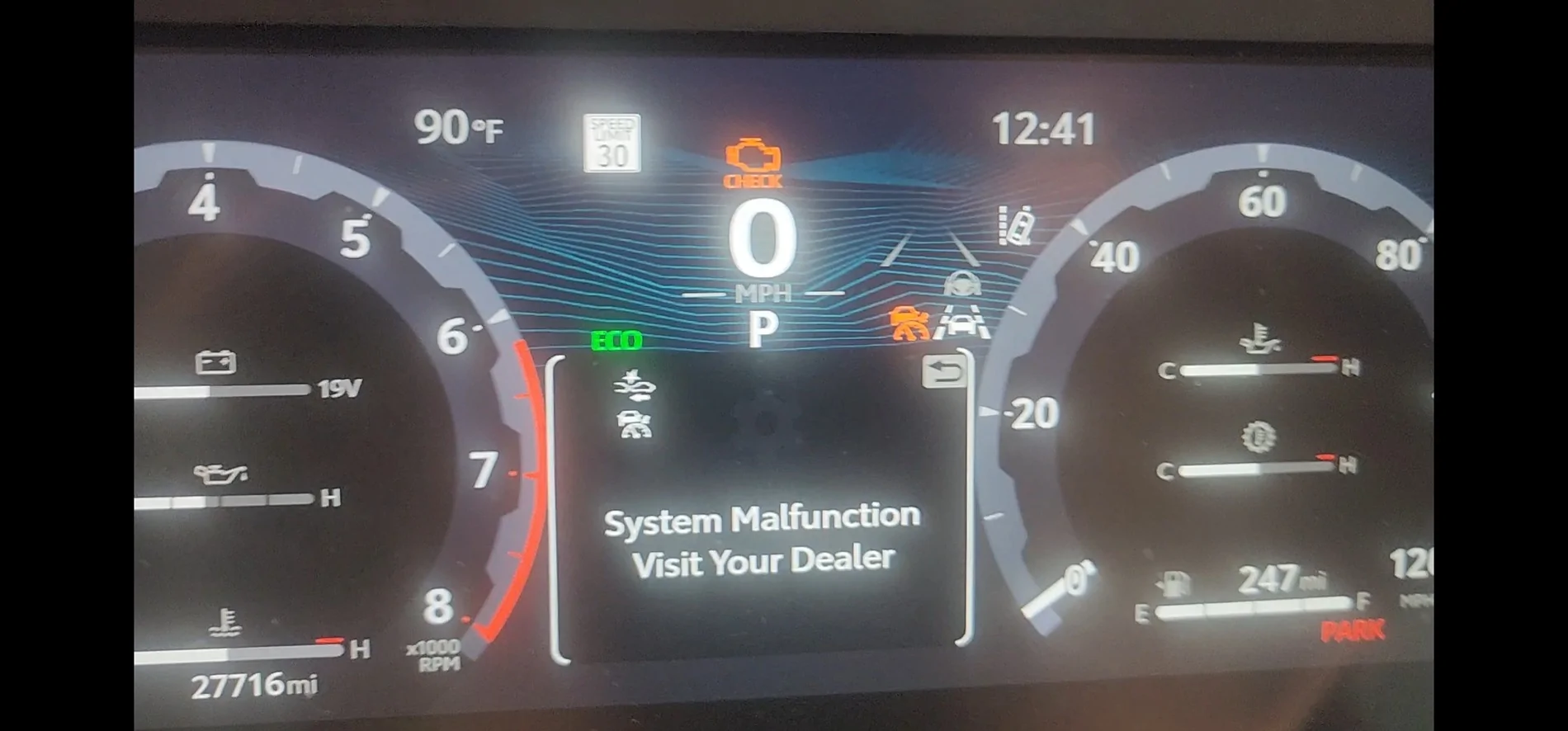

I was on a road trip and started my car after filling gas. The check engine, grille shutter, drive start control, and system malfunction lights alerts went off. I check my grille shutters and they were open. I ended up driving the car home with no issues or limp mode. The only thing that didn't work was the cruise control and active lane assist.
Supreme Toyota in Hammond told me there were similar issues with the 2022 tundra when it came out and they think they know the fix. They placed me in a new loaner car and have been fantastic so far.
I've had no issues prior to this and am loving the truck. Hope there is a fix soon.
Mine just did the same thing.. 3700 miles. Was on road trip of 400 miles coming home.. Stop 10 miles shy of home and filled up and when started up got the same thing.. Supposedly later production model, built mid Sept or so.. Frustrating..
havent called dealer becuase it is weekend.. and you cant scroll though the gages to check engine temp or oil temp..

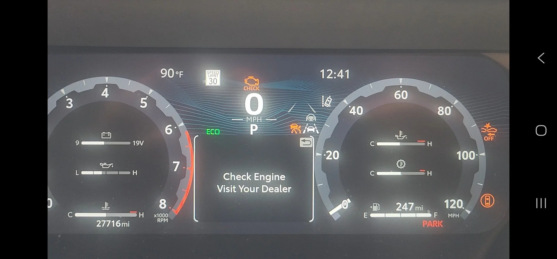

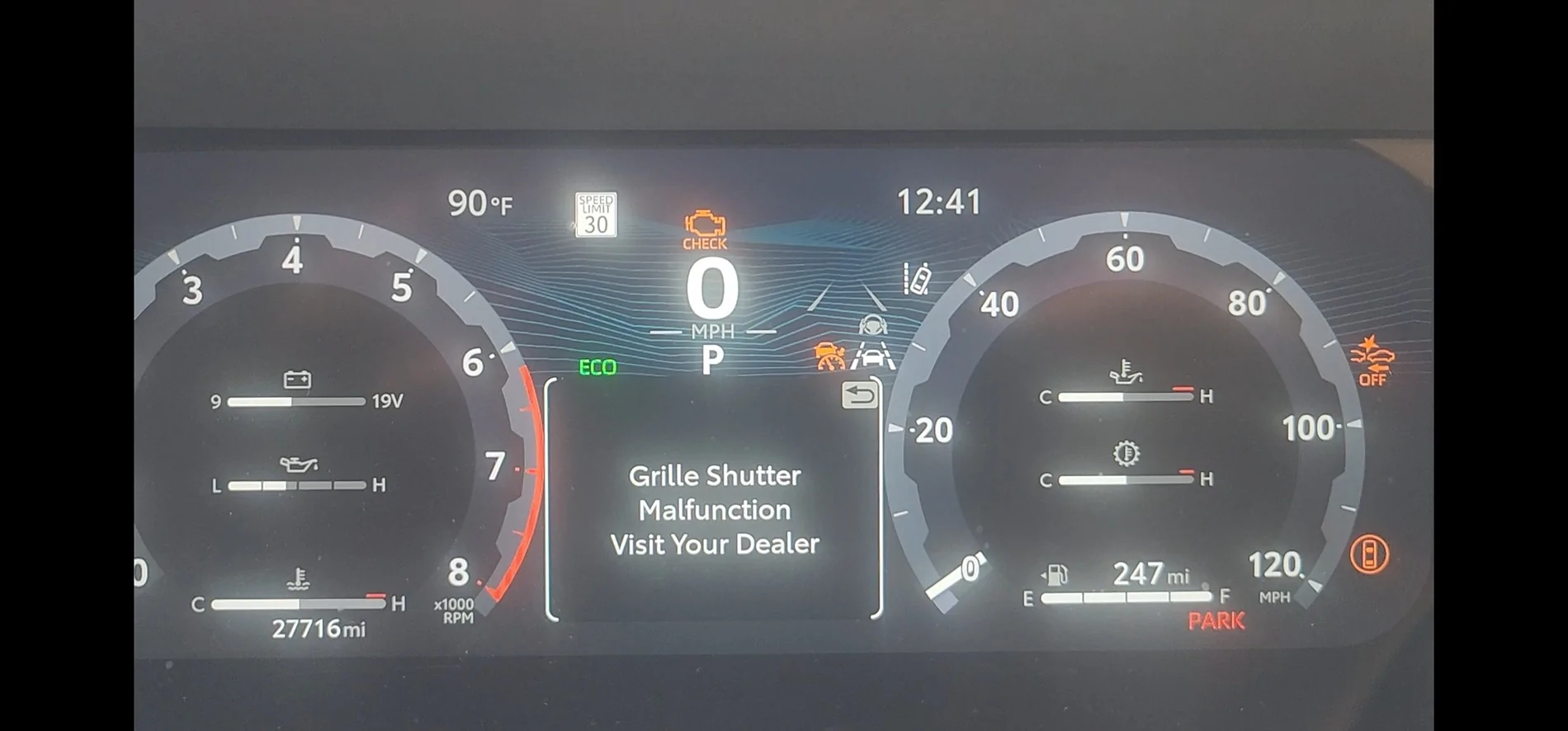

I installed an aftermarket TRD Pro grille and foglights in my SR yesterday, simply removed the grille shutter and reinstalled it - no water involved at all - and am now getting the same failures. I have an early build 24 so this tracks with the defective modules.

Had same issue after replacing grill. Found out one of the connectors wasnt fully seated. Pushed it in and it has worked ever since

At the time of the install I did not, but I have since to attempt a "reset" and it does not have any effect.
I disconnected mine and cleaned it with QD electronics cleaner, still no joy. Have a dealer appt Friday now.

I've seen issues like this if you don't disconnect the battery beforehand. Something about not disconnecting the battery but unplugging the sensors makes it go haywire.
