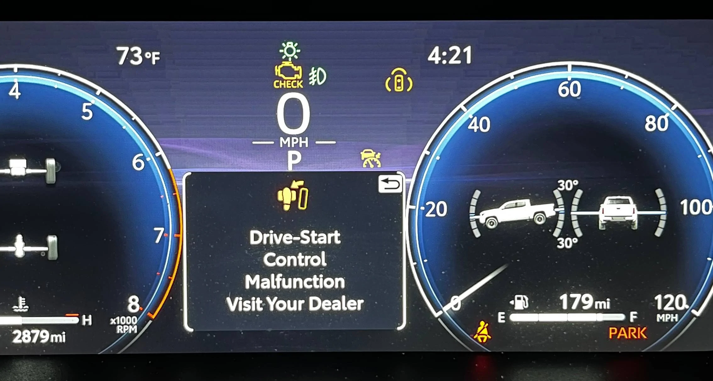

Welp, it was my turn. It's not like I didn't know it was going to happen. The error switches between grill shutter malfunction and drive-start control malfunction. Truck has 2,800 miles on it.

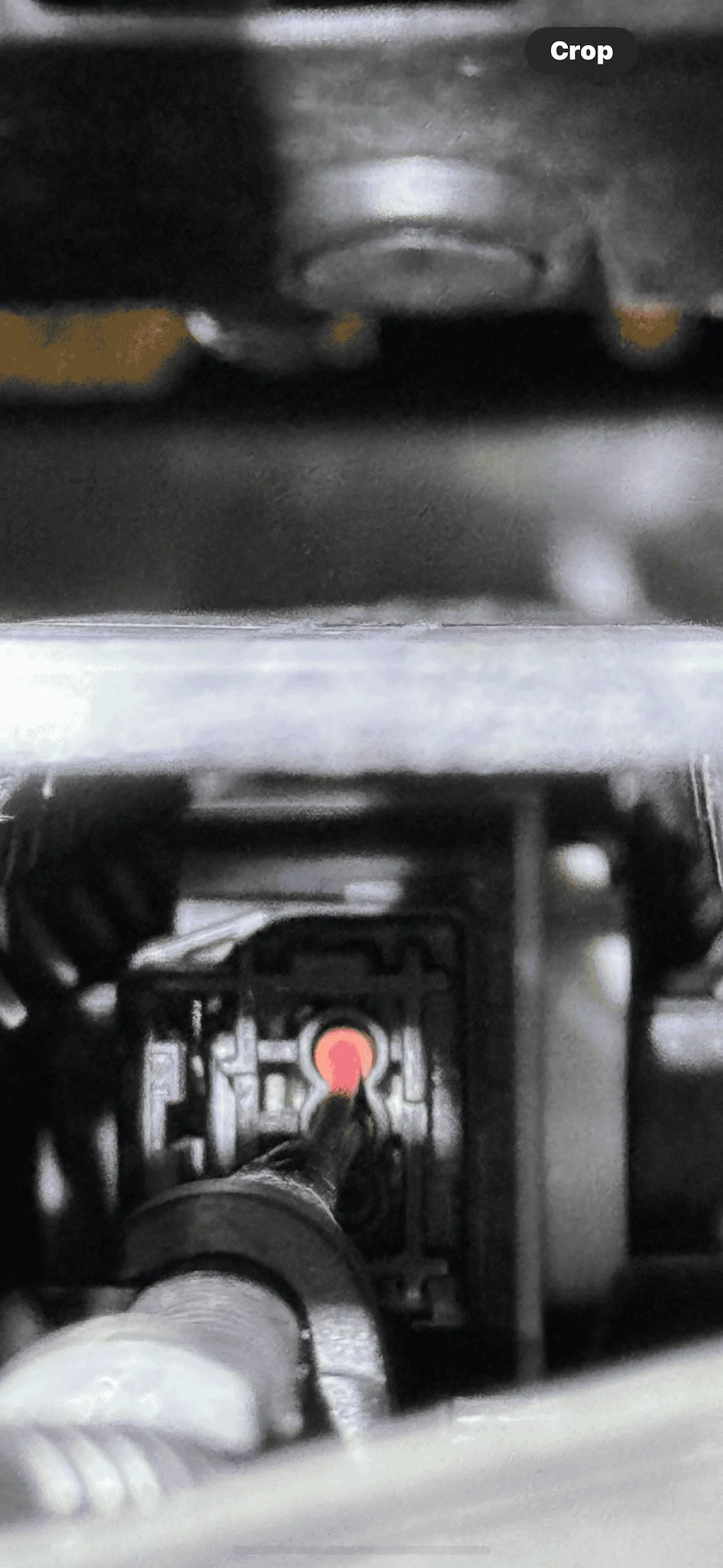

If it is the connector for the actuator, it is not watertight...you can see it if you look down in the center of the grill shutter there is an opening because the actuator is in the center. About 6 inches down you can see the top of the connector with the wires going down into it. I got a long q tip swab and packed the top of the connector with dielectric grease. Don't know if if will help, but we will see. I also dabbed a bit around the connector seams in the front of the grill.
Here is a picture of the connector.
