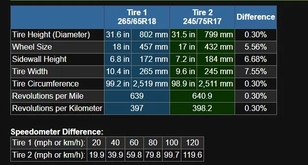

The spare wheel/rim is nothing special. You can mount another tire on it. The tire on it is a 245/75 R17.
With that said, I pulled it and bought the same rim in 18” and mounted the same tire I put on the truck (bought 5).

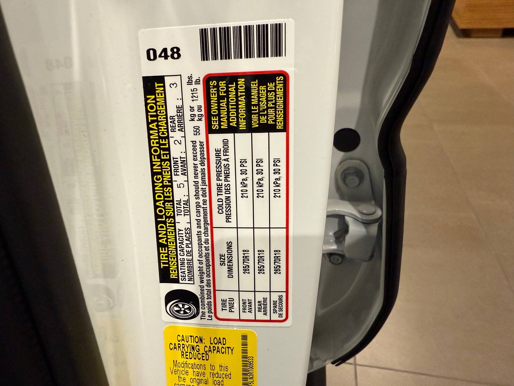

The white door jam sticker should say what size your spare is

For reference. Some Tacos do come with a full spare. This was off a Trailhunter.
2024 Tacoma TRD Sport spare tire wheel size? IMG_2470
