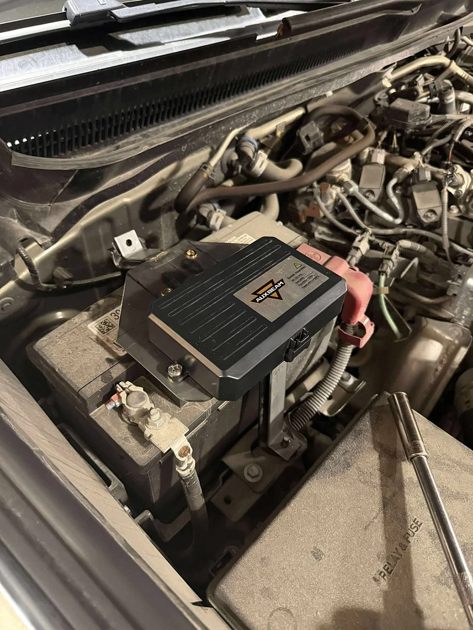

Will eventually have to install a switch panel into the truck as i add more lights. Couldn't necessarily find a reasonably priced mount for the tacoma and didn't want to drill holes in my fuse panel lids so came up with this design. Designed it for my existing auxbeam kit that i took out of my frontier.
I went a bit overboard with rivnuts and also have some rubber bumpers i need to install on it just for vibration resistance.

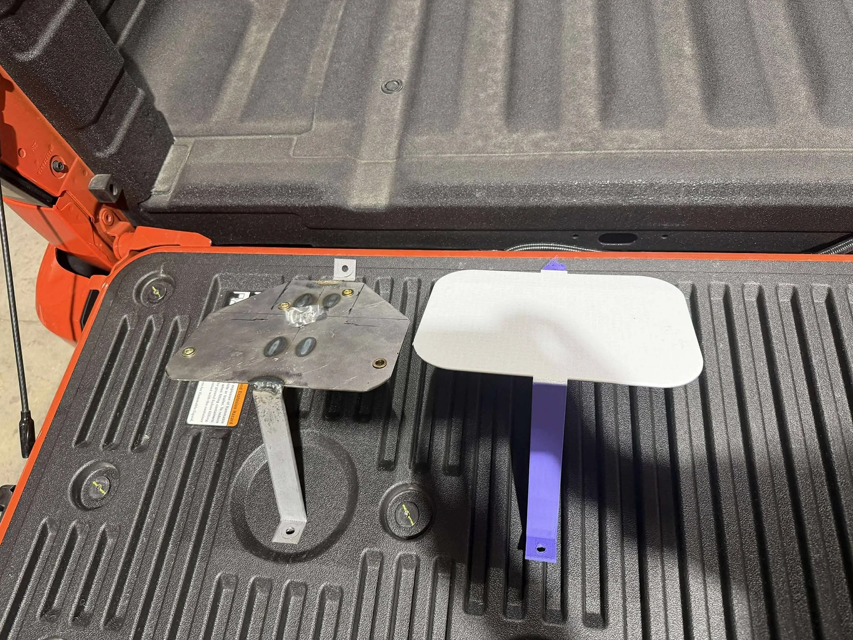

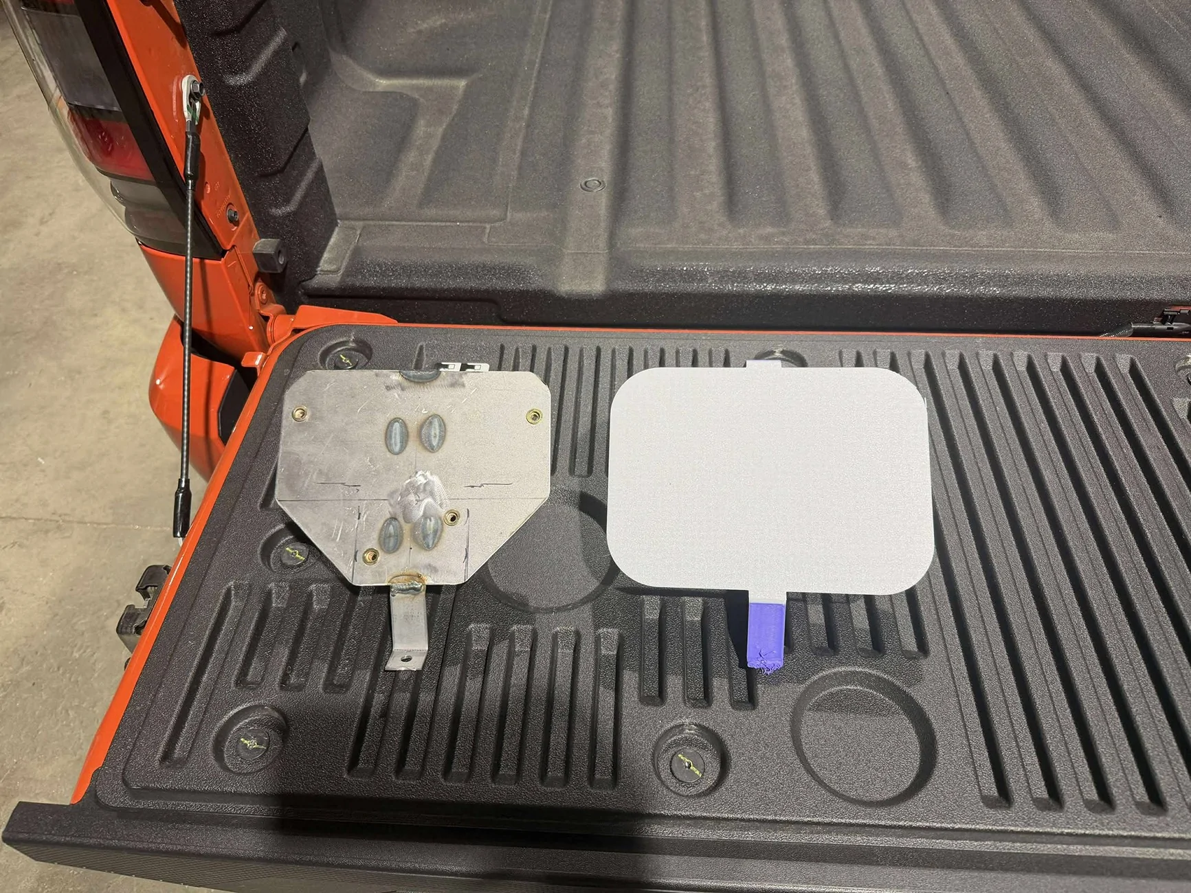

Here's a couple photos of the universal tray design that would allow for any fuse panel to be mounted. Made it wider for the D Switch from Diode since their fuse panel mounting points are pretty wide.
