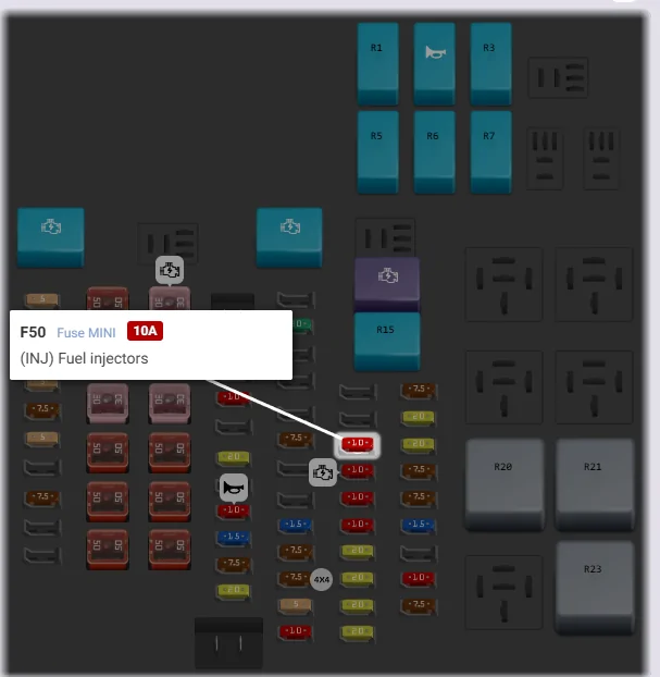

I found one video that said to use fuse F50 (INJ / Fuel Injectors). However, when I used that as my tap point for the Auxbeam, my engine shut off while the truck was running (thankfully it was parked).
From what I’ve read, a lot of people are instead using an ACC-style fuse like ECU-ACC, USB, or an ignition/accessory fuse rather than anything tied to the injectors or critical engine systems. Also seems like the add-a-fuse that comes with the auxbeam kit isnt able to fit the mini fuse from the truck.

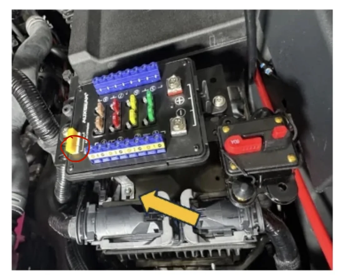

What I did was add a butt connector to the provided ACC wire and extend the cable that connects to the Auxbeam. It should be the red wire. I believe the wire is about 16 or 18 gauge. I got the wire from AutoZone or Advance Auto, but either size should work.
I added a circle to the area I was talking about in the picture of the Auxbeam wire.
Then I ran that cable through the firewall using a coat hanger and routed it to the passenger-side fuse box. I attached it to a fuse tap and used two fuse in the provided fuse tap. I used USB 1, which controls the front USB ports.
I would choose a fuse that doesn’t control anything important. You don’t want to use anything that controls the ECU or any major vehicle functions.
