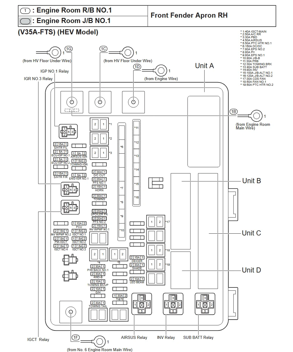

I’ve been wondering the same thing and I found this video on the install. I
I know SDHQ has a relocation kit they sell but that’s ~$1100
I also found this video that uses the back most post instead. I did check with a multimeter and it seems like ALL of the posts have constant 12V power running through it. I wonder which would be the best to tap into?

For everyone here, I'm trying to find a Tacoma version but this is the Tundra's setup. If someone can help interpret that would be great! But 1C is the post that the guy with the Trailhunter used and 1F is the one the Tundra guy used.
