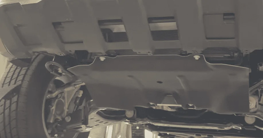

When you take off the chin spoiler, it exposes the TRD Sport skid plate which has a lip on each side that are normally blocked by the chin spoiler. I could easily see those edges catching air and making some noise. It's why I haven't pulled my chin spoiler. I want to try seeing if a TRD Offroad plastic skid plate, which bends up at the front, will work.
You can see the lips on the right & left side of the skid plate in this picture:
You also want to make sure that you put the chin spoiler's mounting bolts back in to prevent the felt wheel well liner from catching air. I would even look at moving the felt wheel well liner to the inner side of the front bumper and add a buckle washer/nut to keep it in place.
