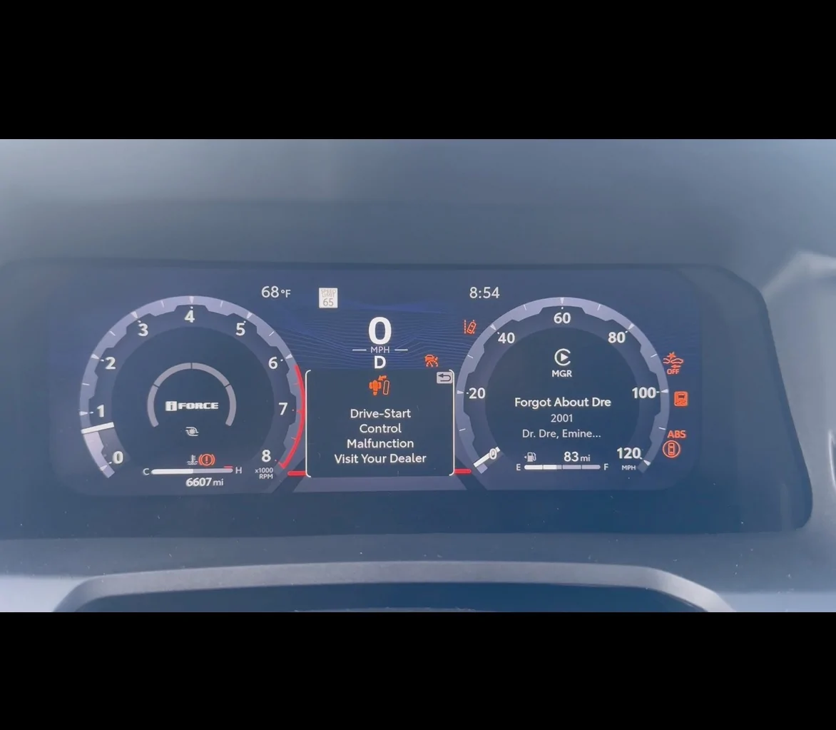

So They recalibrated everything and now they're telling me that it's the speed sensor. They're saying that my truck needs a longer one. Has anyone had this issue?
A longer one? Because of the lift? Smells pretty fishy!

I took it to the shop that did the lift but they don't want to cover it because the problem didn't occur till 1 week later. My local Toyota dealer doesn't want to cover it either because they blame everything on the lift.

Never heard of a short speed sensor. Did they mean shorted out or damaged? That would be a problem. Either damaged during install, which would have immediately been a problem, or a freak rock bounced up and caught it?

So finally after 2 weeks my truck is running warning light free. Turns out that my drivers side abs speed sensor was loose and it was rubbing against metal. It made a small cut in the wire. I took it to a local repair shop and they soldered the wire as temporary solution while I get the new one in.
Toyota dealer wanted $1,150 to replace the ABS Speed sensor.
I just ordered the part for $221.from Toyota and local shop will install it for $89.
if you do a lift in your truck make sure that your AbS Wires are secured properly
