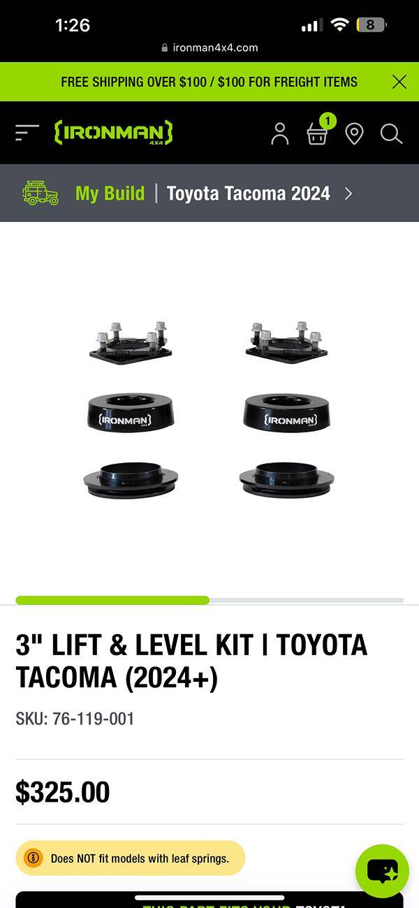

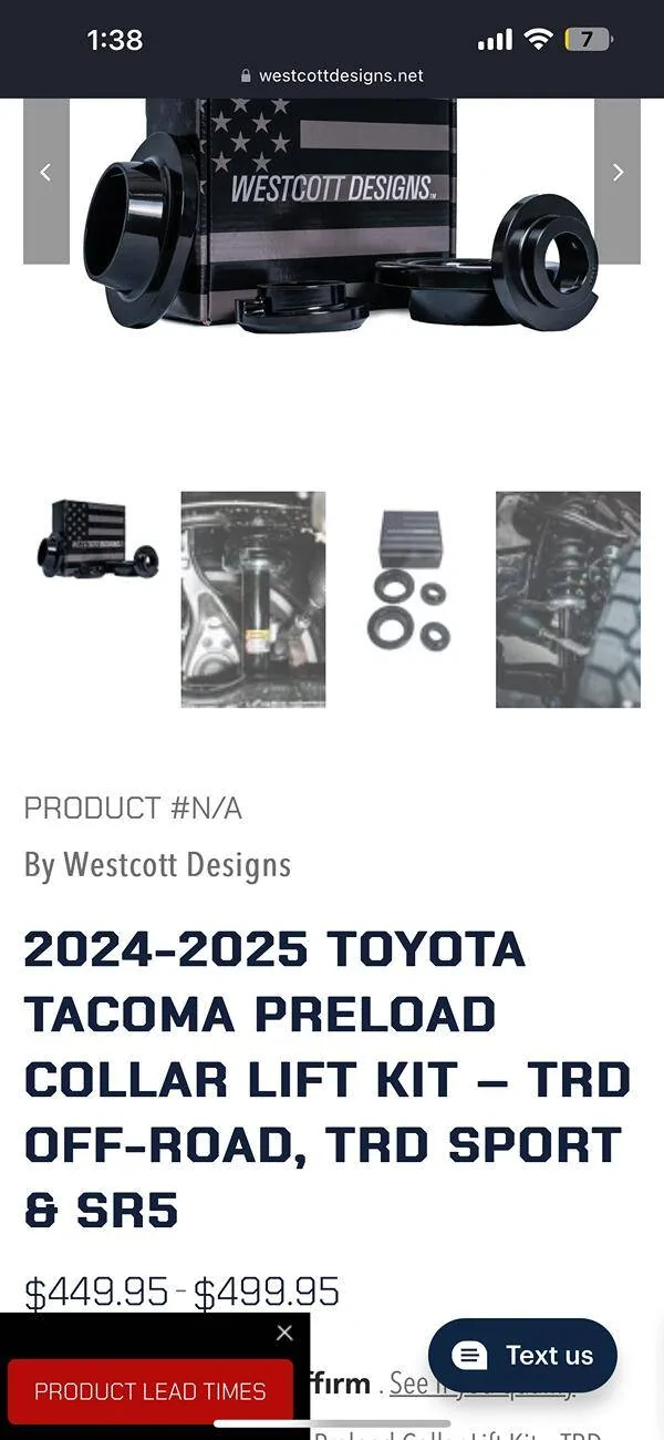

Hey guys I was looking into getting a preload collar lift and level kit and found out Ironman off-road makes a new lift and level kit. I’ve seen a lot about their foam cell shocks but nothing about their coil spacers. Everyone seems to be going with the Wescott designs spacers but they have less lift. Any advice on which to go with ?

Yep, I also did the Ironman level kit. Ride is good, install straight forward. It's more lift, less money, less wait. I'm happy with the Ironman kit and would recommend it.

Hey Brandon - we're ready to take care of you and your Tacoma. Thanks for considering our Lift and Level kit!

Because not everyone knows that preload collar lifts increase spring rate and reduce travel - which is why Toyota doesn't do their lifts that way.
OP said he didn't know anything about Ironman coil spacers. Looks like they're a combination of strut spacers and preload spacers. I believe the Wescott is preload only. No one else said anything about these differences. Don't know what his or anyone else's knowledge of suspension design/trade offs is. But I guess we don't want to discuss things like that here.

FYI: according to westcott, their product reduces travel by 1/2 inch if you are equipped with stabilizer disconnect, which I am. So, I agree, all new parts are the ideal way to go from an engineering stand point. From a practical standpoint that considers cost and real world, I think the right solution is a little more.... individual, you might say.
