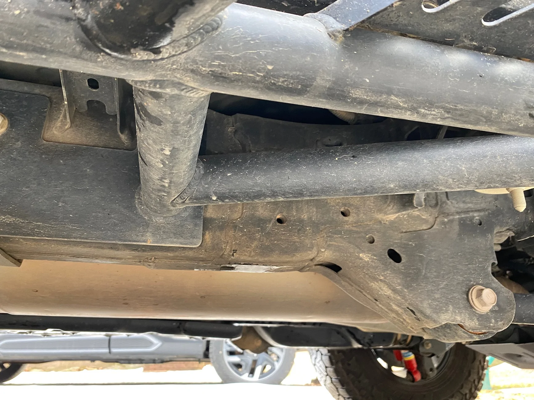

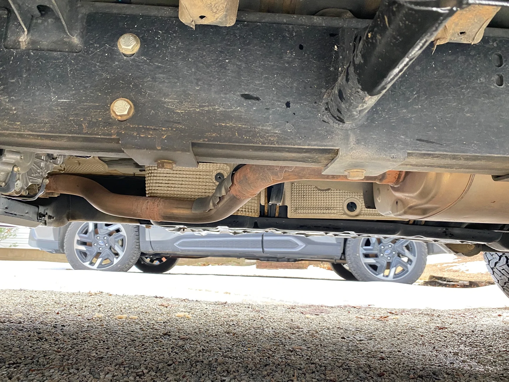

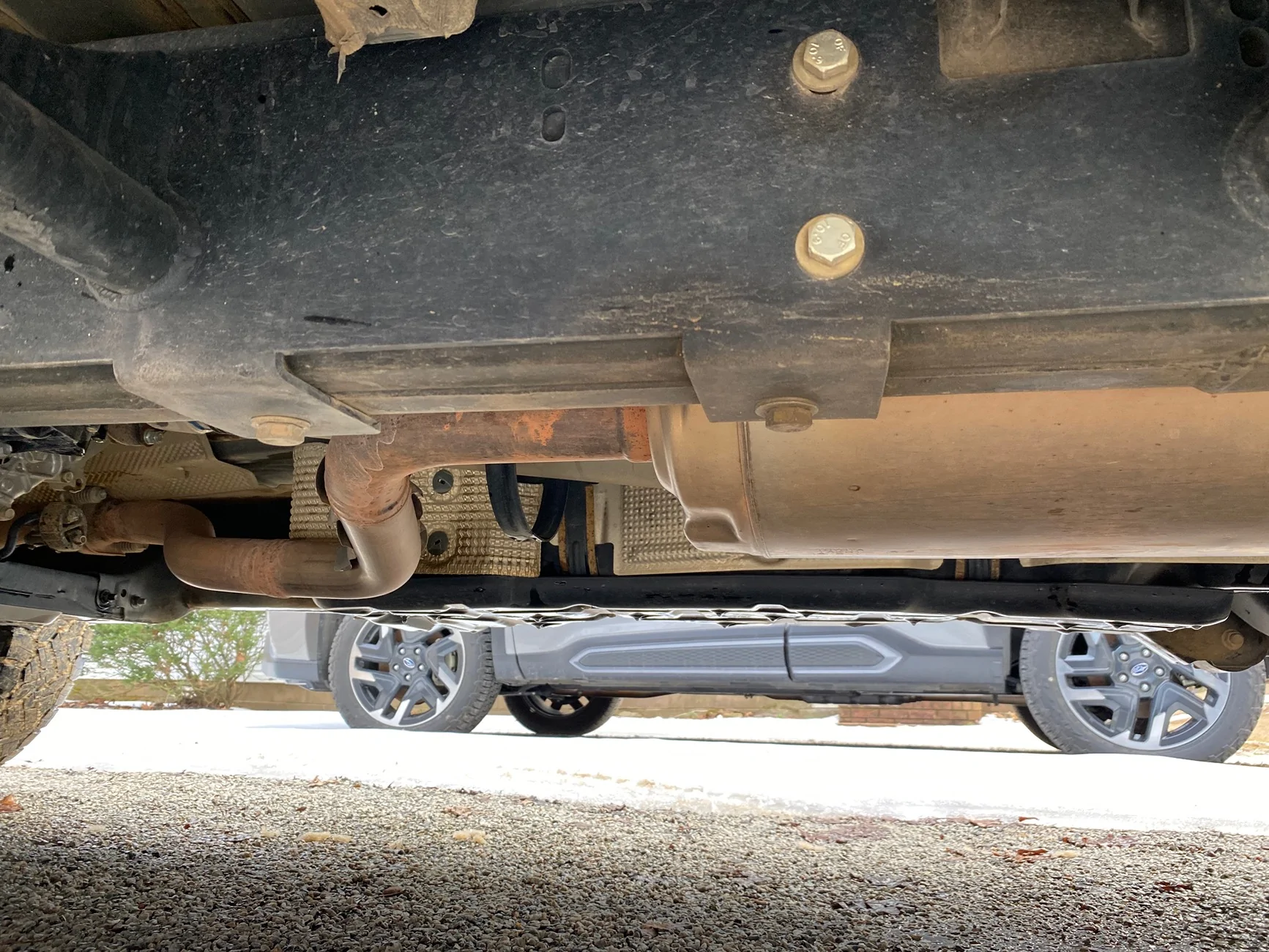

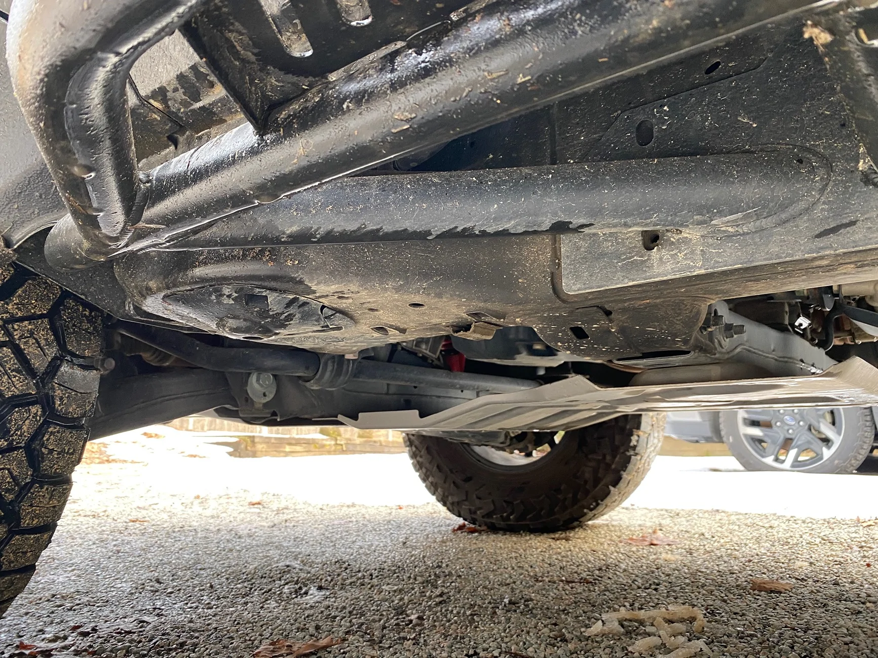

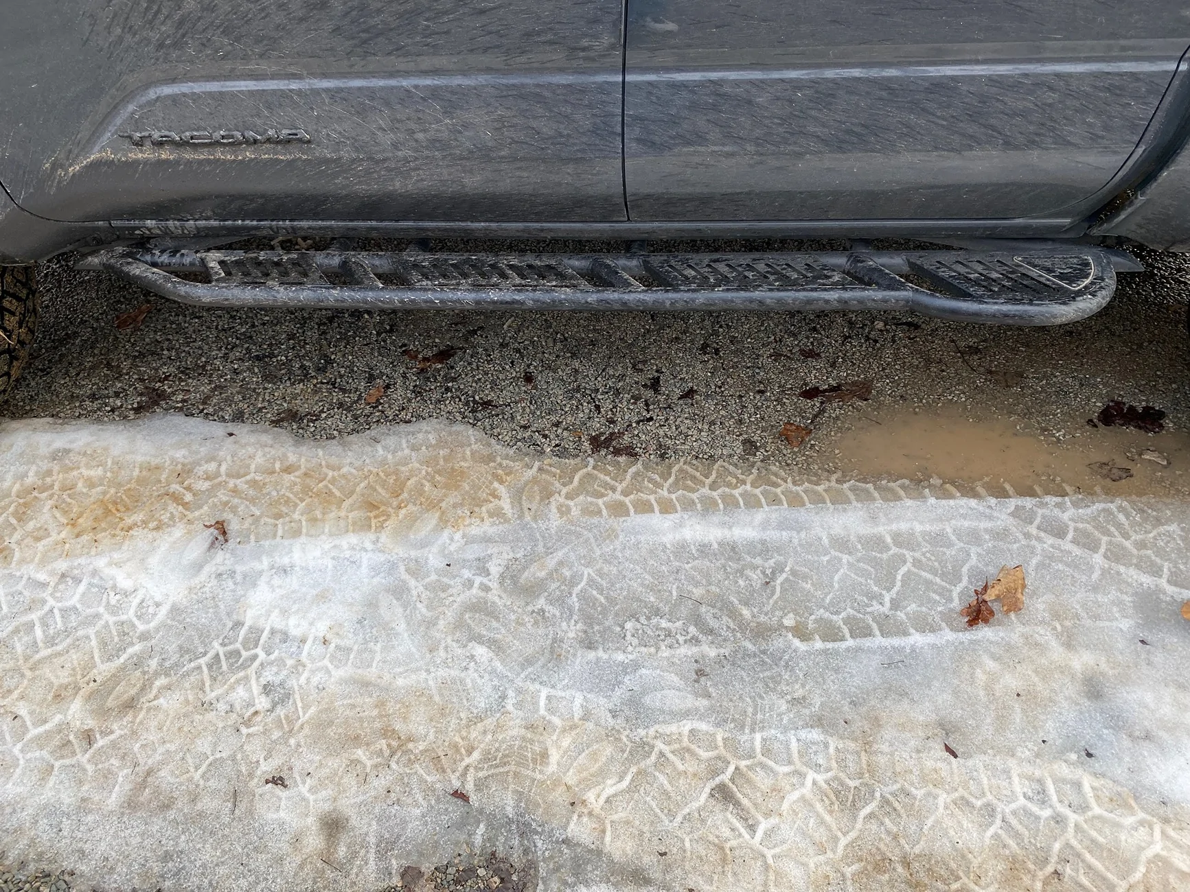

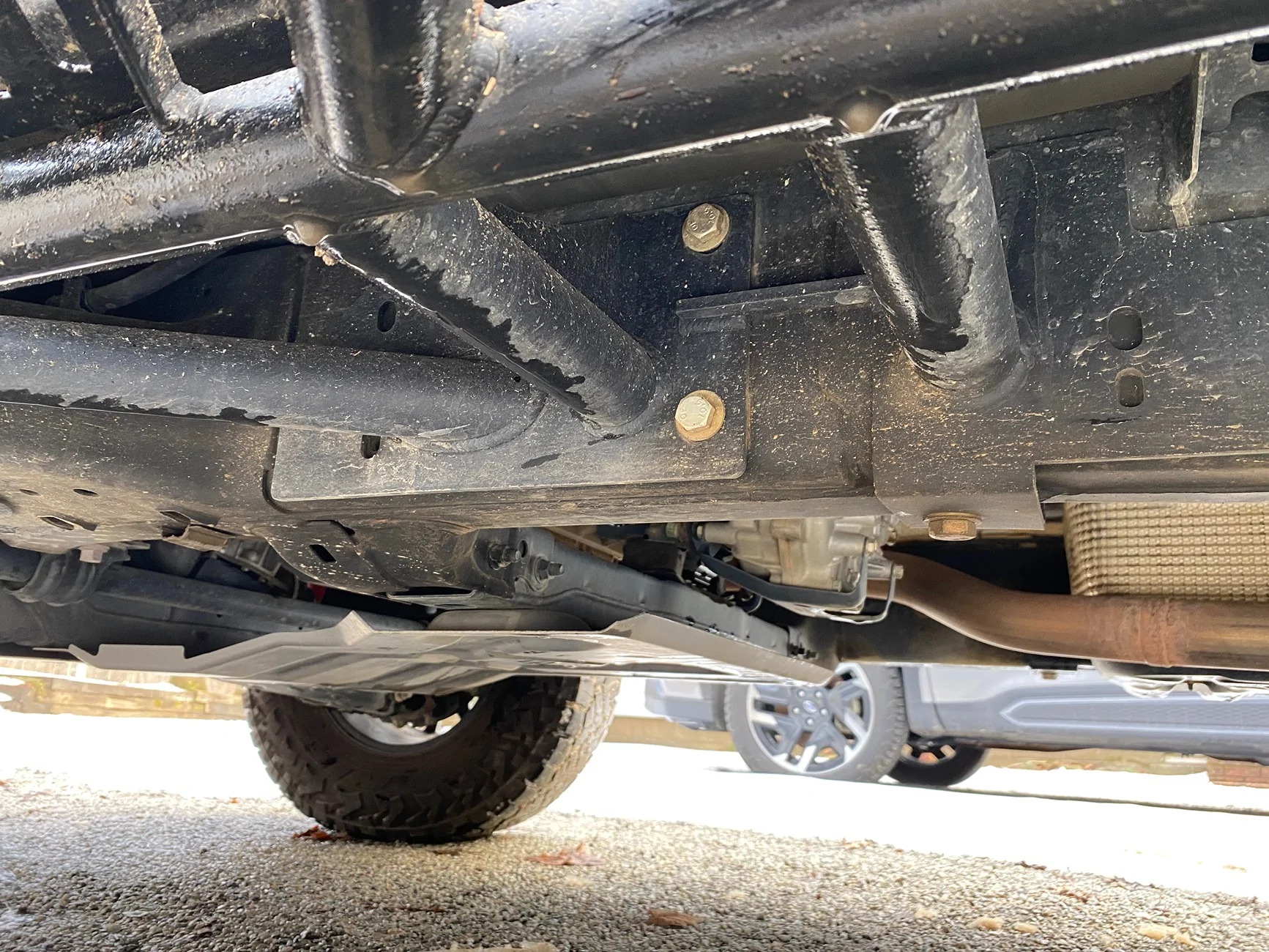

Sorry about the filth, we are recovering from the winter ice storm. Here’s pictures of the sliders.
