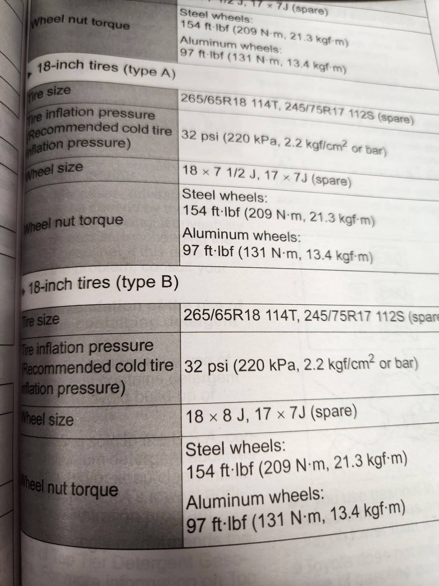

I have a TRD Sport 6MT and I am reading through the owner's bible and was wondering what wheel size do I have, the 18x7.5 or the 18x8?
Looking to get a spare wheel...

Local dealer stated using VIN number that they are 18x7.5 Type A....
Where to find that size with bolt pattern?
