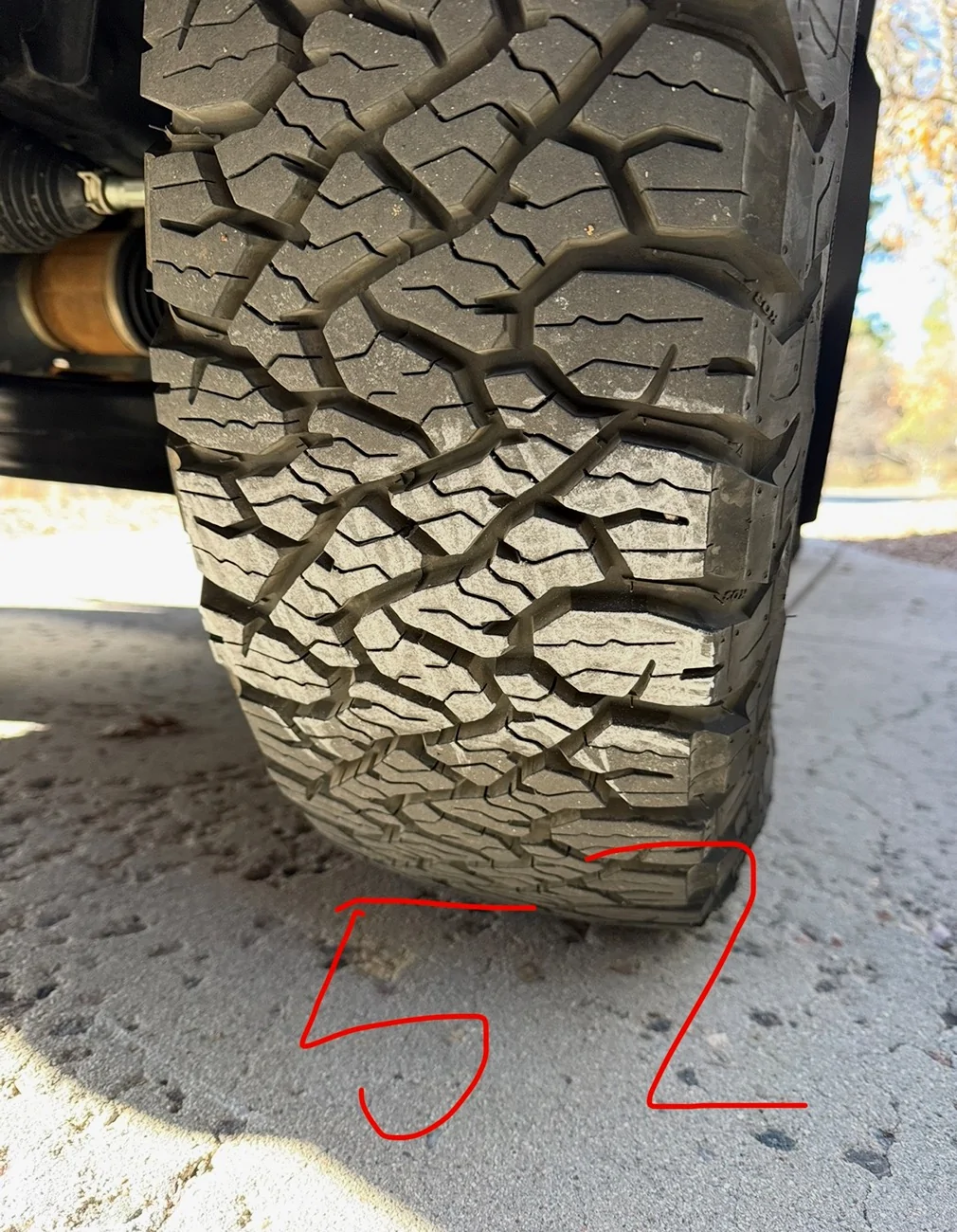

Update on the chalk test for the E-load KO3's: there was no significant difference between 35psi and 50psi for the chalk pattern. I was trying to find the upper limit to get any change in the chalk test. I took it around the block at 50 and it was every bit as teeth-rattling as y'all have been complaining about. Since I saw no difference in the chalk test I'm taking them back down to ~32-35. I'm not sure if the increased sturdiness of the E-loads meant less significant change in the chalk test at different psi or if I screwed it up somehow, just thought that was weird.
You should plug your tire info in here
https://tiresize.com/pressure-calculator/
It sounds counterintuitive but E rated tires need more pressure for the same load and size as SL rated tires. They can't shed heat as effectively as SL rated tires due to the extra plies so in order to manage that heat you reduce flexing by increasing PSI.
