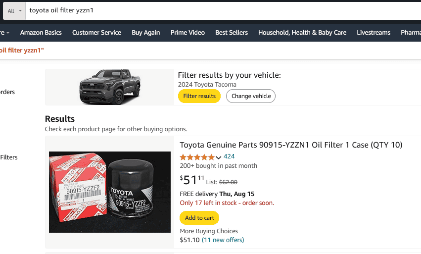

I'm going to visit the dealer parts dept and find out what the Toyota OEM 90915-YZZN1 filters cost per each at the dealer. Also if 90915-YZZF2 are equivalent as is indicated on the AMZ website link per below. That'll take a few days but I will report back. My best guess at this point is Toyota OEM is best, though Amsoil filter might otherwise be the best per that ChatGPT output. Sigh.
https://www.amazon.com/s?k=toyota+o...yota+oil+filter+yzzn1,aps,98&ref=nb_sb_noss_1
