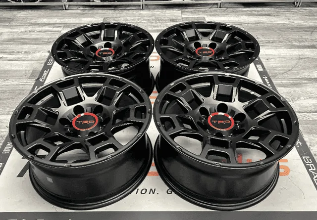

Im thinking it should fit the 24Tacoma
Wheel Size: 18x9.0J -Bolt Pattern: 6x139.7 -Offset: +15 -Bore: 95.1mm -Finish: Matt Black.
With lots of poke. Rim will stick out 59 mm farther.

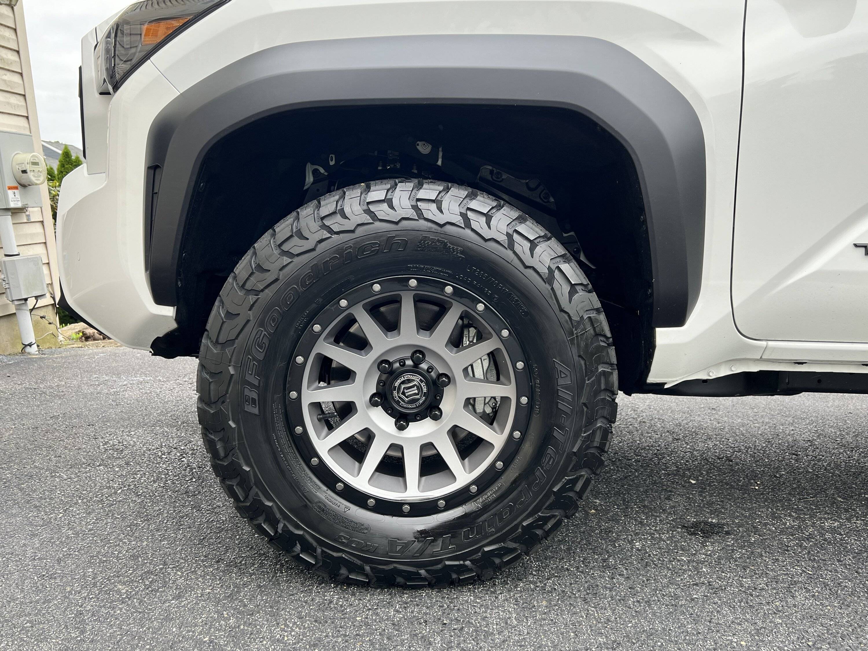

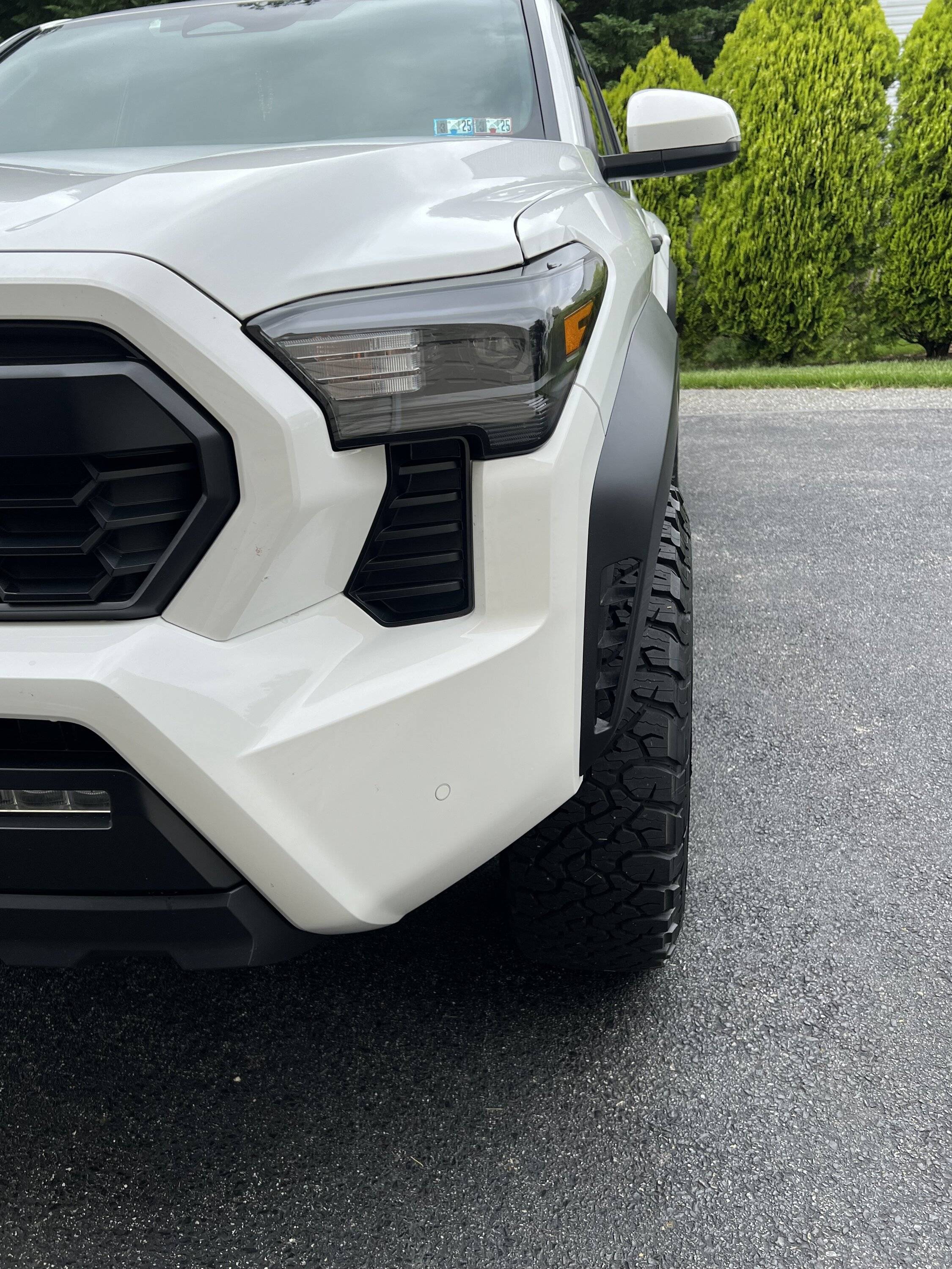

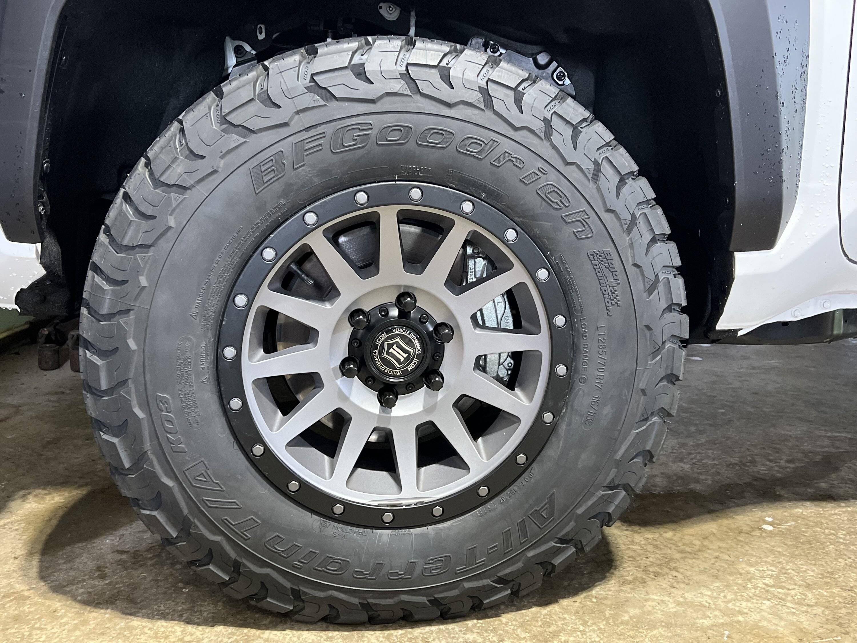

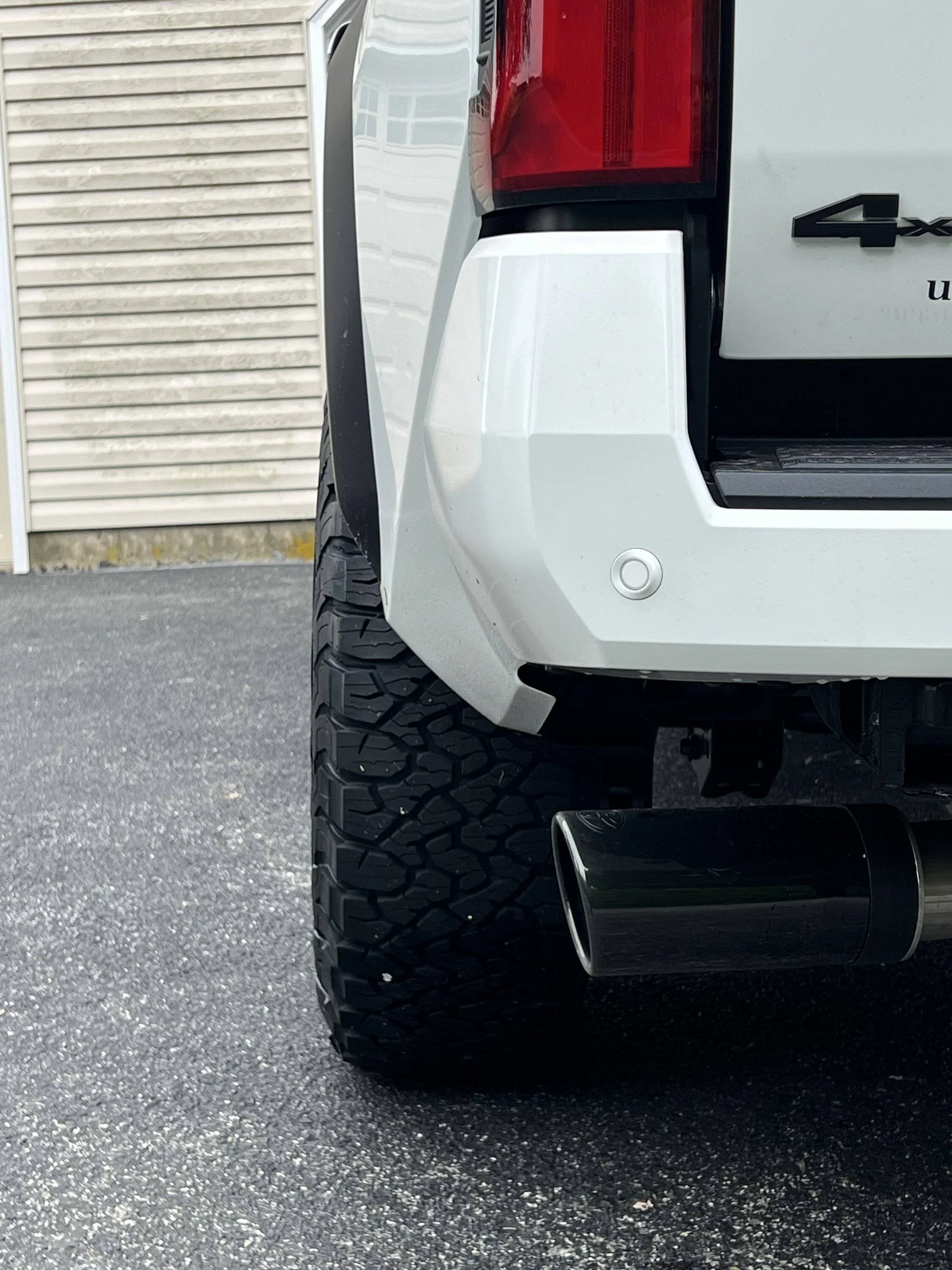

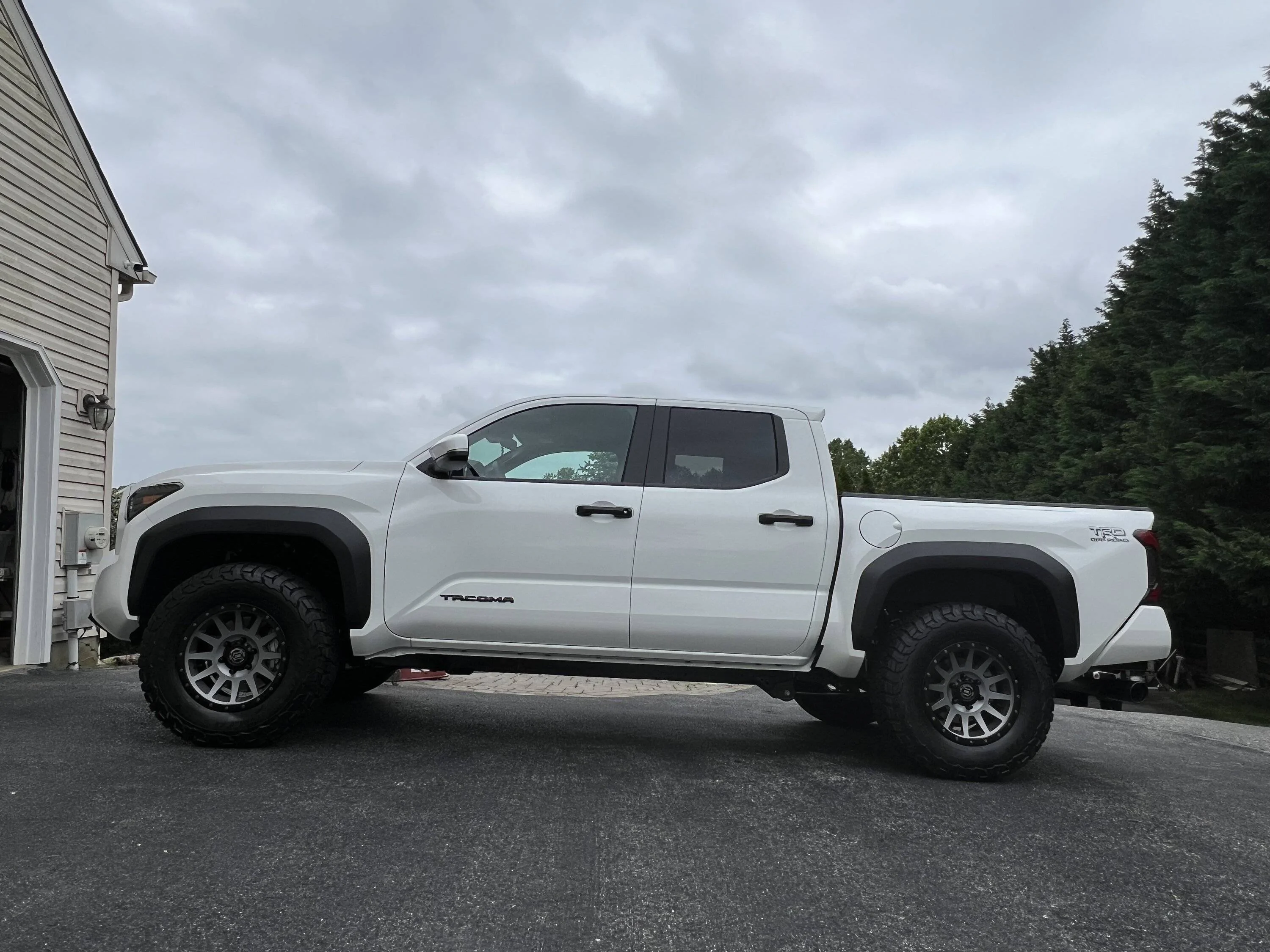

End up with Icon alloy
285X70X17 With K03 and Hubcentric Icon Alloy Titanium Compression 17X8.5 +25 Offset With stock suspension.
