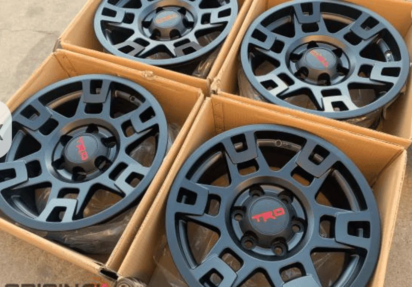

Sorry do not know much about wheels but I do not like the wheels on my 4G TRD OR due to the machined ring. Would these work on a 4G?
The are 17x8 with 5mm Offset 6x5.5 bolt pattern
2024 Tacoma Will these wheels fit on 2024 Tacoma? 17x8 with 5mm Offset 6x5.5 bolt pattern 1711318171709

I am not the wheel and tire expert, I will let them chime in. I will say, though, that I have done a ton of reading the last 2 weeks trying to decide what to do for my TRD Sport, and I think your problem will be the 5mm offset. I think that might make your wheels and tires poke out quite a bit.

One last thing to consider is the lug nut issue. It is addressed in this LINK. Gen 4 Tacoma has a 14mm 1.5 stud which is larger than the 12mm 1.5 stud on the gen 3. Congrats on your new gen4 Taco.
