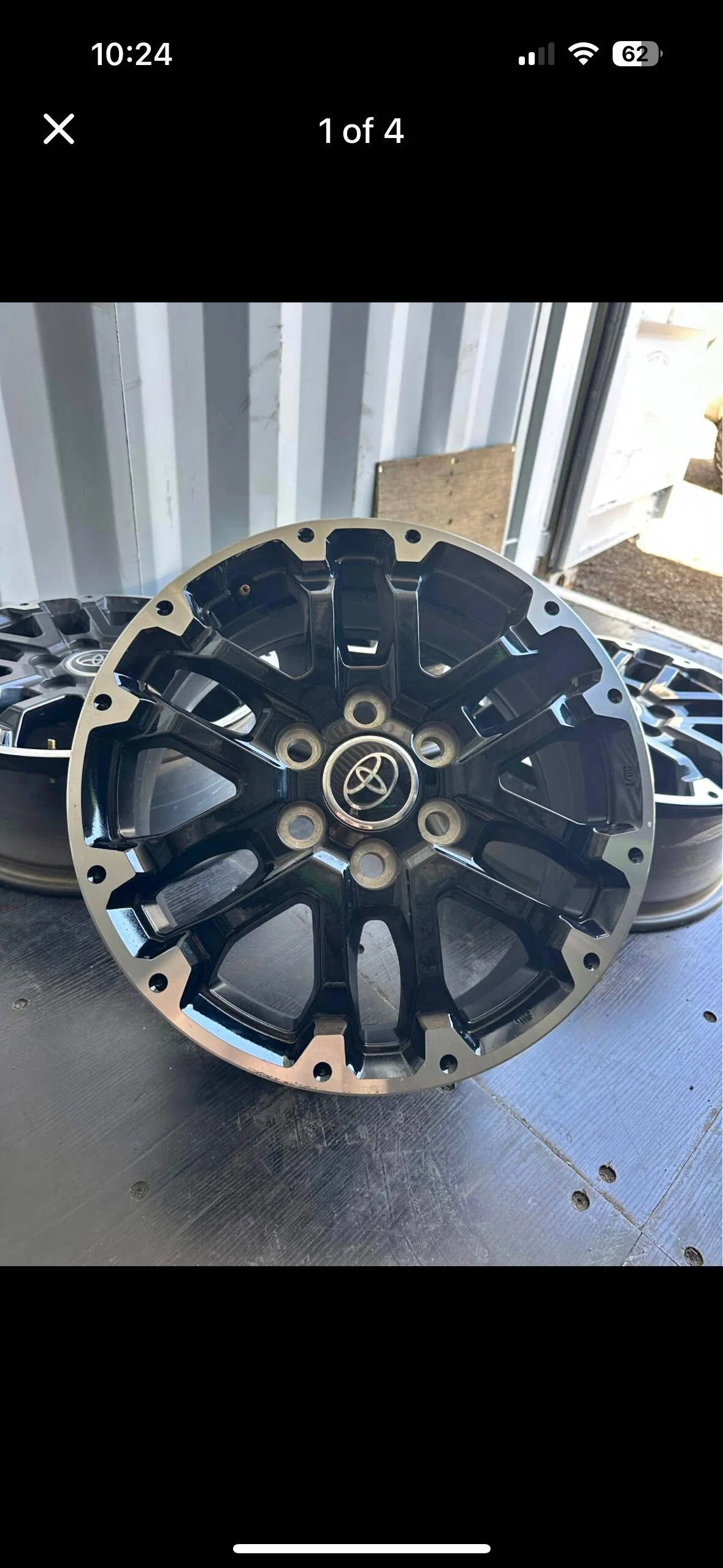

I’m searching marketplace for winter wheels (yes, I know, sad in the summer), and came across these. I’m not sure if they fit, I’ve seen some Tundra wheels mentioned on some forums, but I don’t know what to look for. They’re 18” and fit a ‘21 and up Tundra.

I hear ya buddy, wheels and tires are a crap shoot lol, luckily the boys here are helpful , hang in there sombody will chime in

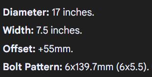

Stock TRD OR Wheel Specs:

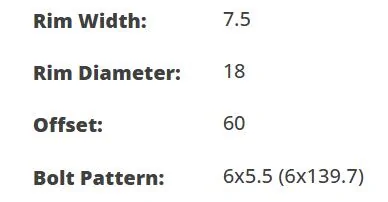

These wheels seem to have these specs:

It should fit, as I recall the SR5 wheels having a 60 offset. I've seen other people run tundra wheels on their 4g tacoma as well. I'd just caution against running too thick of a tire lest they rub on your control arms (not that you'd be maxing them for running a winter tire). Good luck and if I'm wrong I'll refund you the amount you paid for this reply . :wink:
