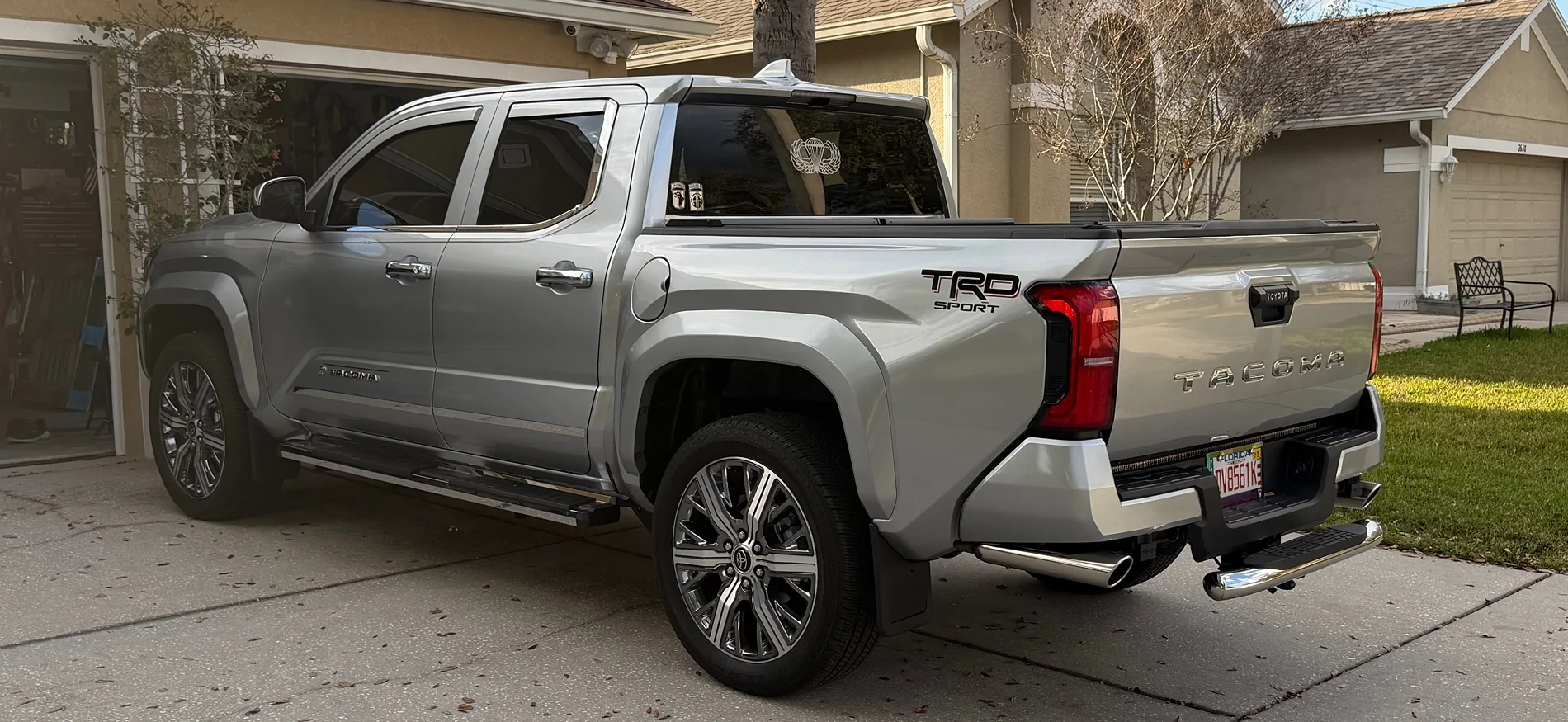

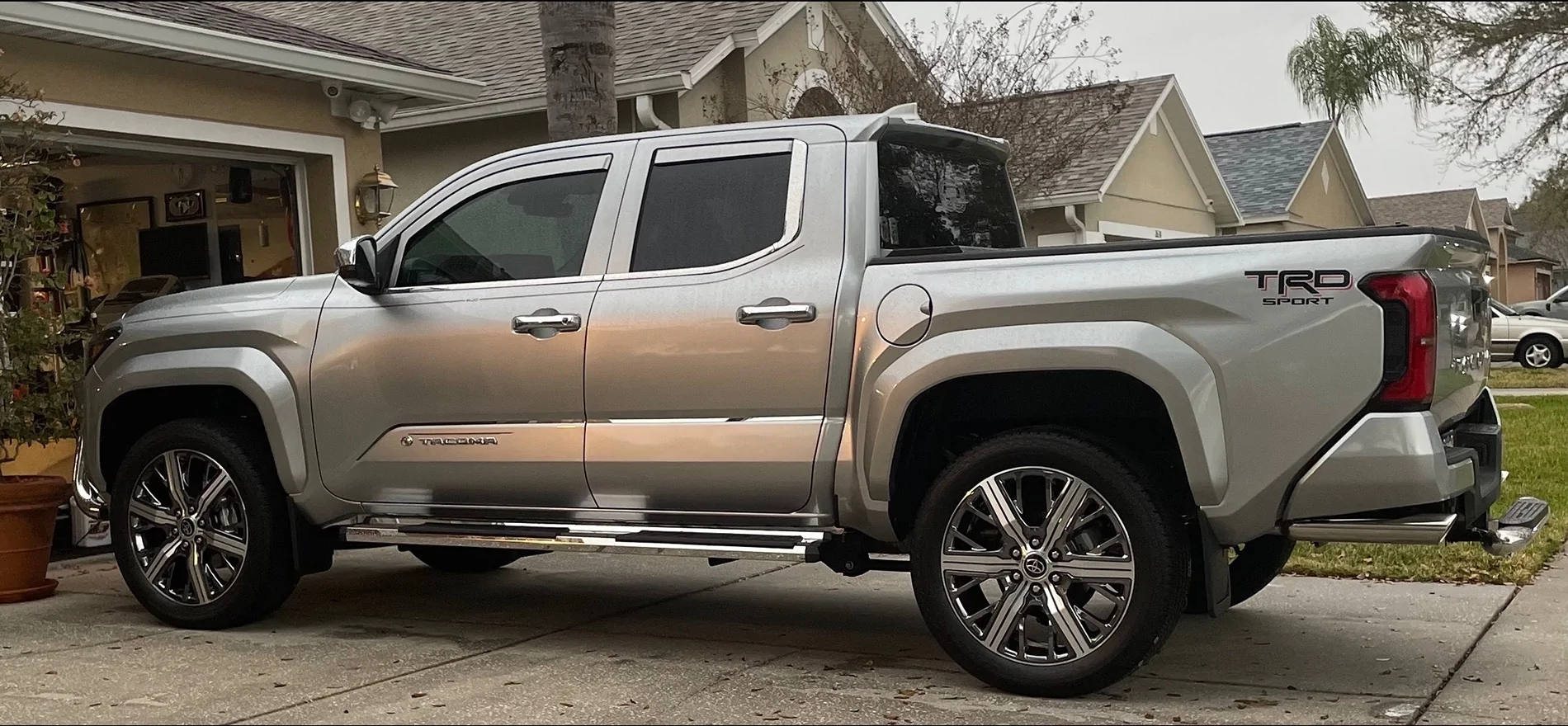

Tundra 22 inch Capstones are a perfect fit for my 2025 Toco. TampaBay Toyota confirmed the fit, and they ride the same as the original 18s. I’m a happy old Dude today. Thanks much Droid for your input.
