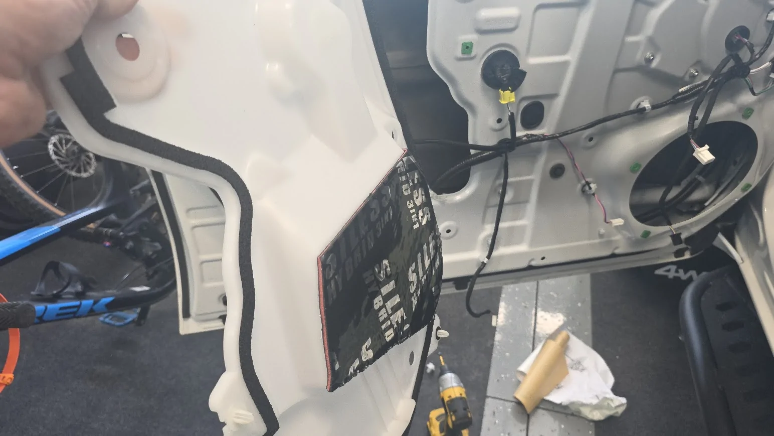

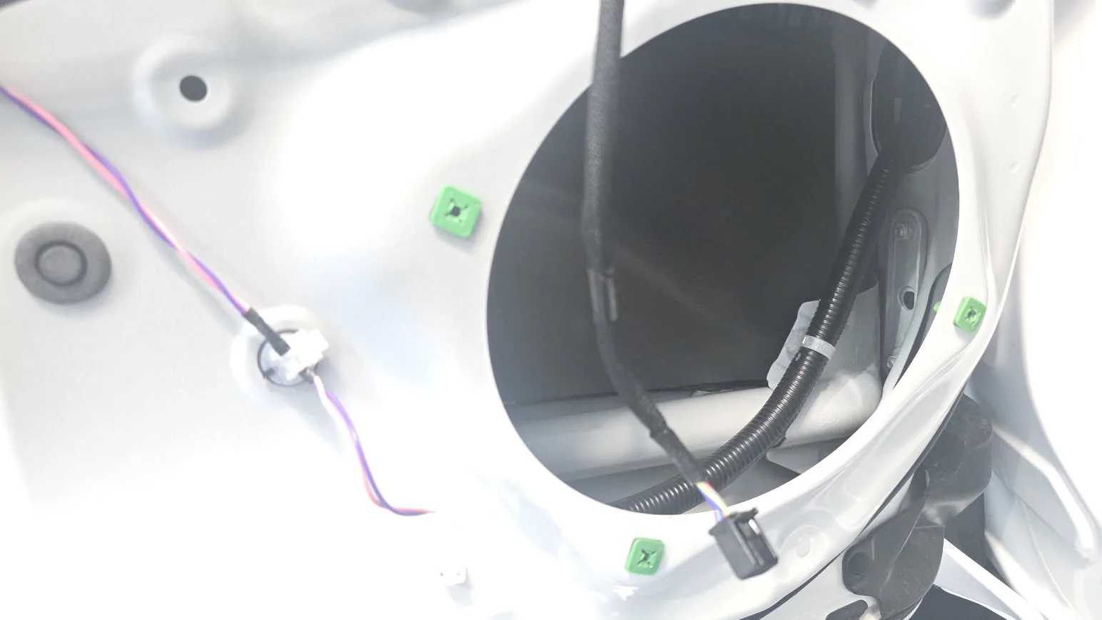

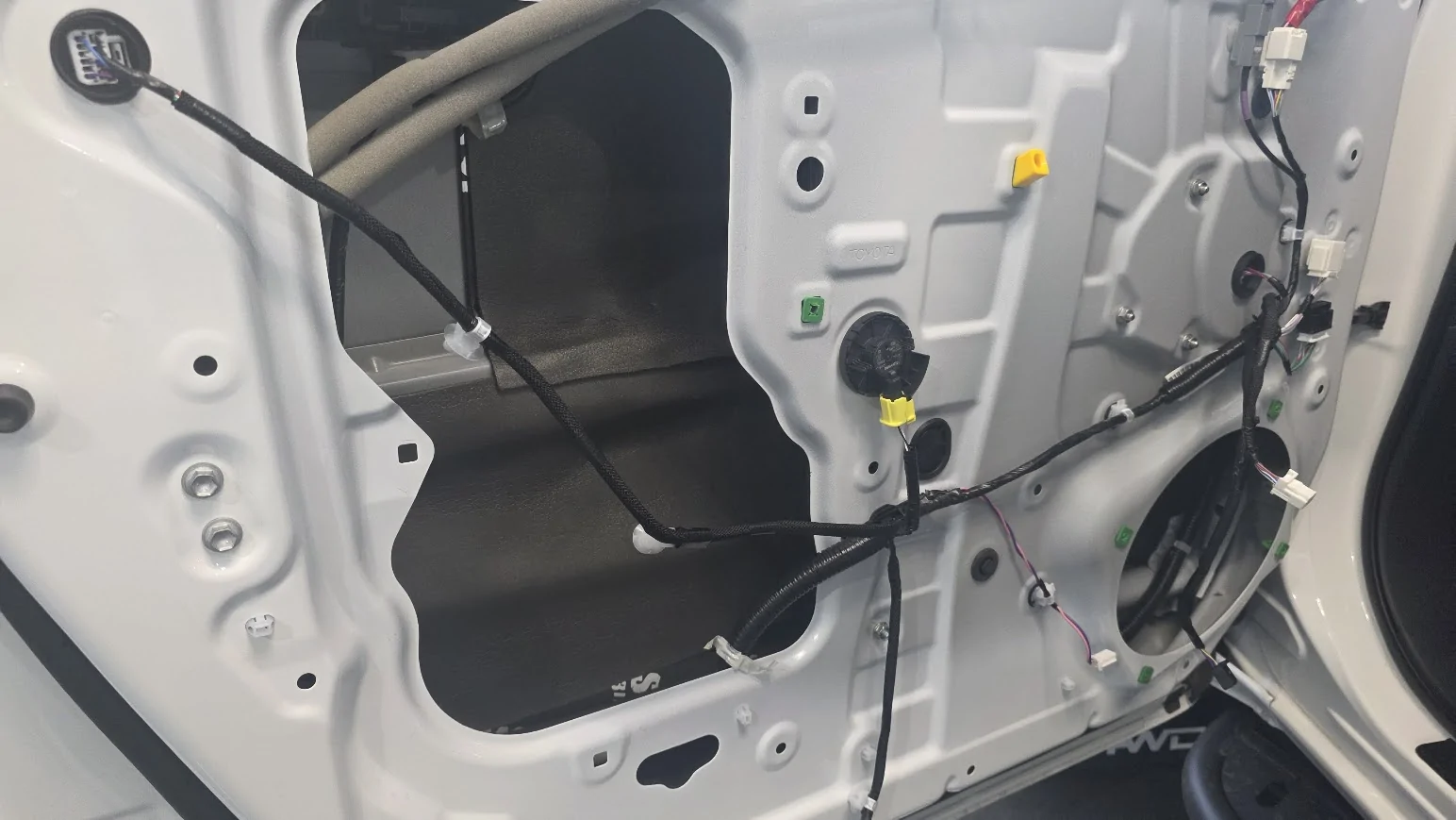

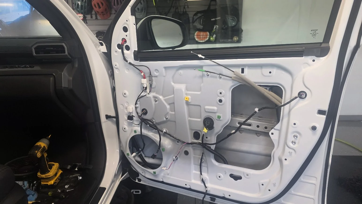

I didnt take great photos of the doors unfortunately. But they are typical to most door panels for removal.
At this stage I only did the outer skin of the door. I find this has the largest impact on road noise and improving the sound from the door speakers (biggest bonus). 4 full sheets of the 3 layer deadener and then I cover that with the closed cell foam (here: https://www.amazon.com/dp/B07B75PD8B?ref=ppx_yo2ov_dt_b_fed_asin_title&th=1).
Typically I would also had a foam ring to seal the door speaker to the door panel for a drastic improvement in midbass, however Toyota already did this from the factory.
The result of doing the doors I noticed a slight decrease in road noise, but a nice boost in sound quality from the doors. I will do the same treatment to the rear doors. This leaves the roof, back wall, floors and front inner fender to do.
