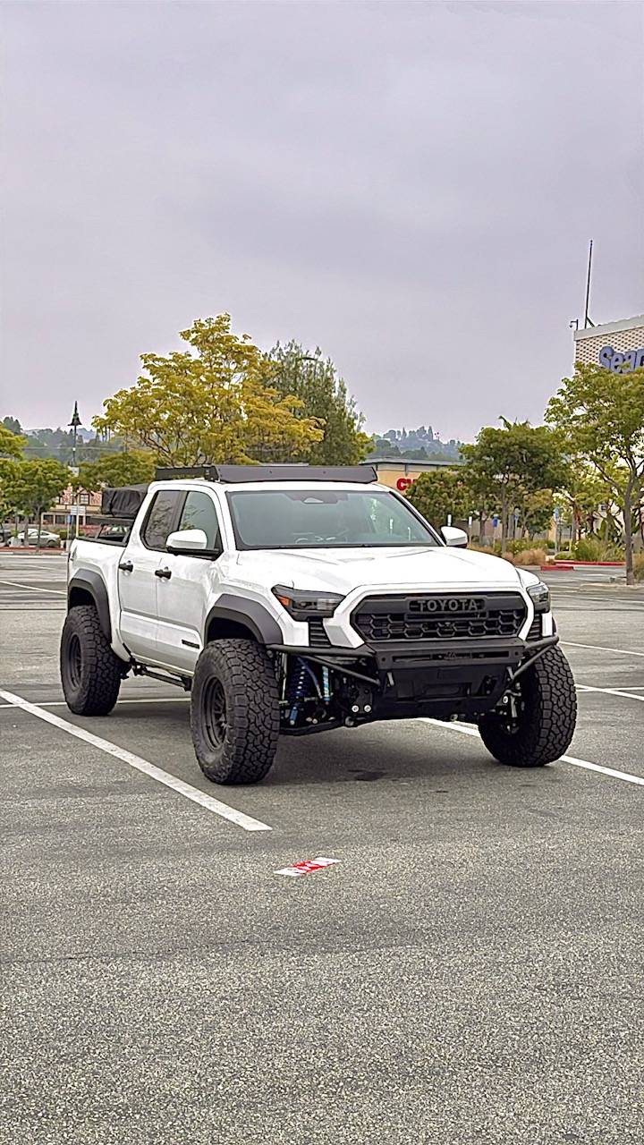

I'm really loving how this build is coming together so far. I'll be removing the roof rack, bed rack/RTT, and going with a GFC, install date 8/21.

Nice truck! Do you have any pictures of your truck with the SSW wheels before the long travel kit? I really like the look of those wheels.

Thanks. Looks like you don’t have much room for uptravel without smashing the fenders. New fenders on the list of things to do?
That last picture is a bit deceiving because the rear is jacked up all the way from when the Toyo's were being mounted. I am waiting on the front axle shafts before going on a proper break in trip, then again once the GFC is on and the set static weight is on the rear. After that the shop will fine tune a bit more, and if needed, probably do some fender trimming (trying to keep that OEM + look and not resort to fiber glass).
