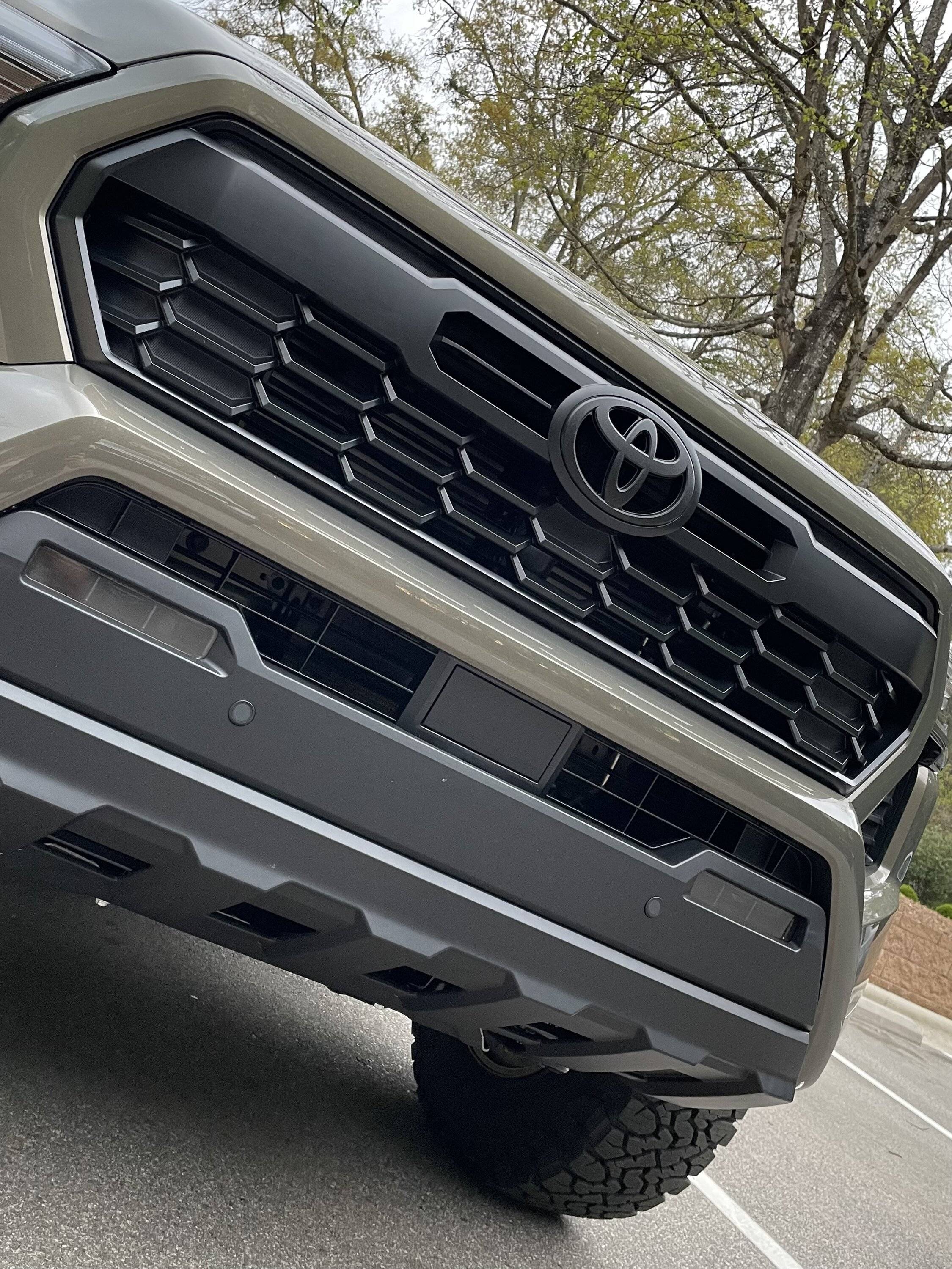

Derped the front emblem! Was hoping to track down the black overlay from Toyota but it’s not yet available. I had a can of Plastidip laying around so decided to black it out! Five coats plus a top layer of glossifier and it turned out great! So much more stealth! The second photo nicely shows the fog lights smoked with Xpel film.
The emblem was very easy to remove without even removing the grill!

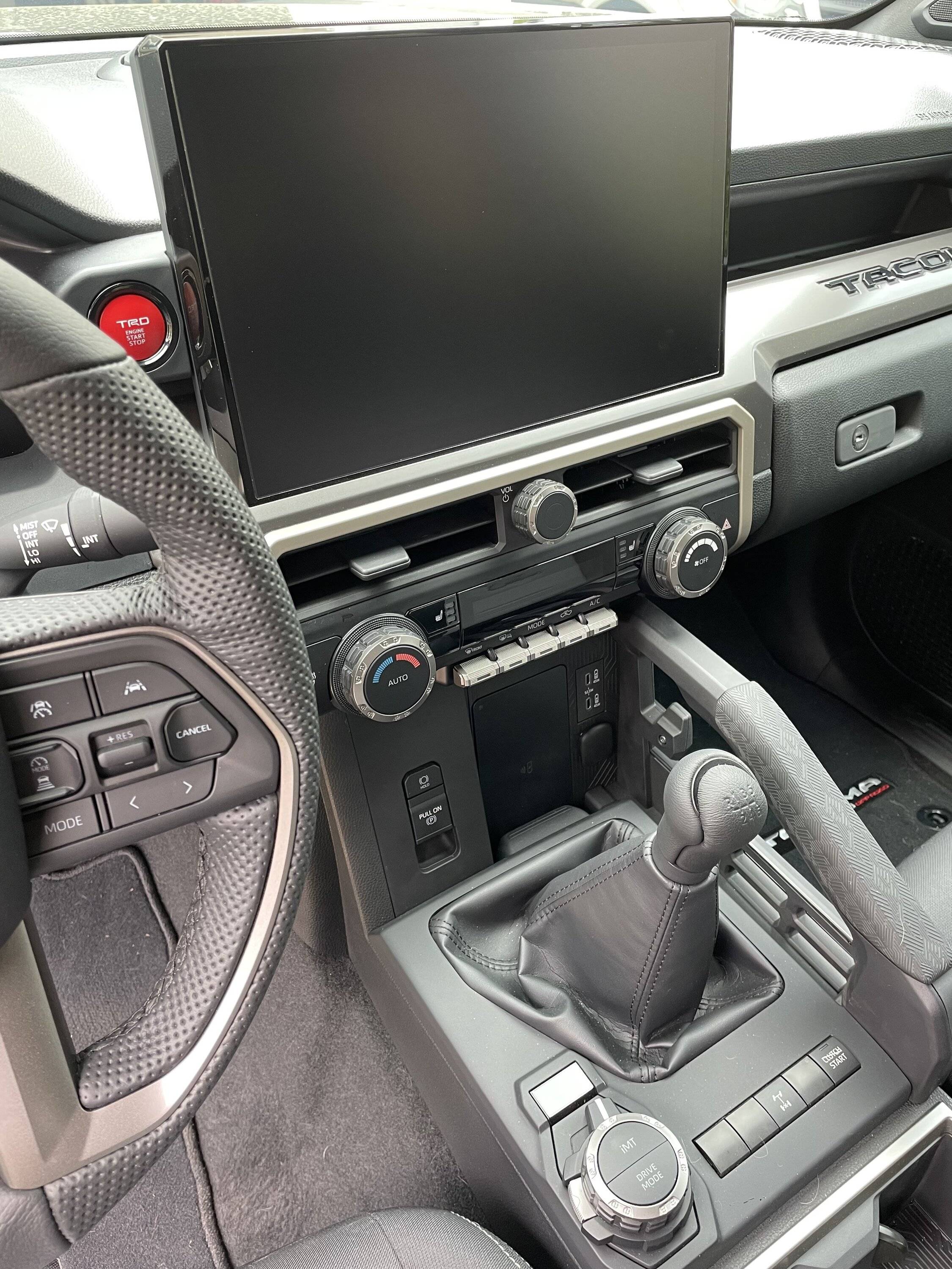

Installed the Screen Protech antiglare kit. Only the film for the 14” multimedia screen is antiglare. The kit also comes with pieces to protect instrument cluster, the hvac screen, the heat seat buttons, the blanks below (cooled seat buttons on premium package/Limited), and the 4x4 selector screen. The kit comes with everything needed to install successfully. I opted for the optional spare just in case but didn’t need it. I have it for sale in the marketplace on this forum If anyone is interested.
It took a few attempts to get the instrument cluster film centered but in the end it worked out great with no defects. It’s important to be sure you have ample spray solution both on the surface you are applying to and on the entire back surface of the film.
I am very happy with the result. I intentionally took the pic below when it was bright out so it is clear how well the antiglare works.

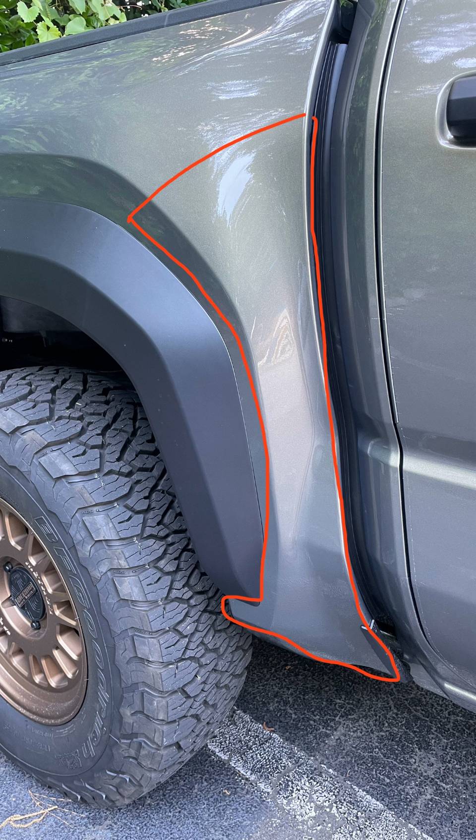

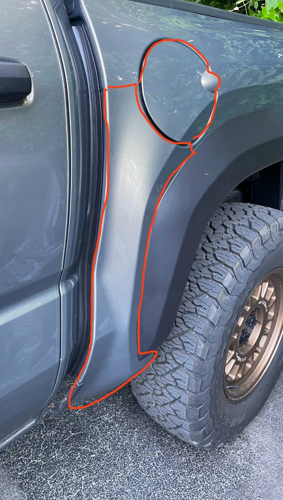

After seeing several posts on the forums and FB of wider offsets and excessive rock chips, I decided to have Apex Filmwerks (Apex NC) add some protection to these wide hips. He removed the small piece of PPF that came on the truck and replaced with Xpel covering the most likely impact zone
Traced to location of the film so you can see where it’s placed.

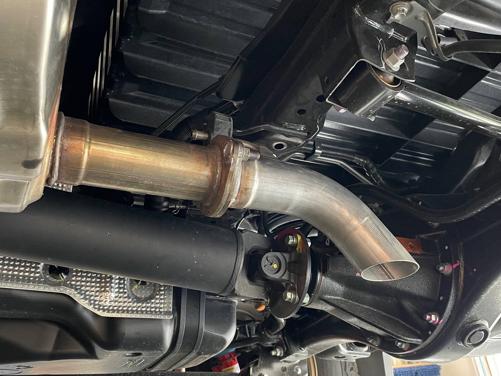

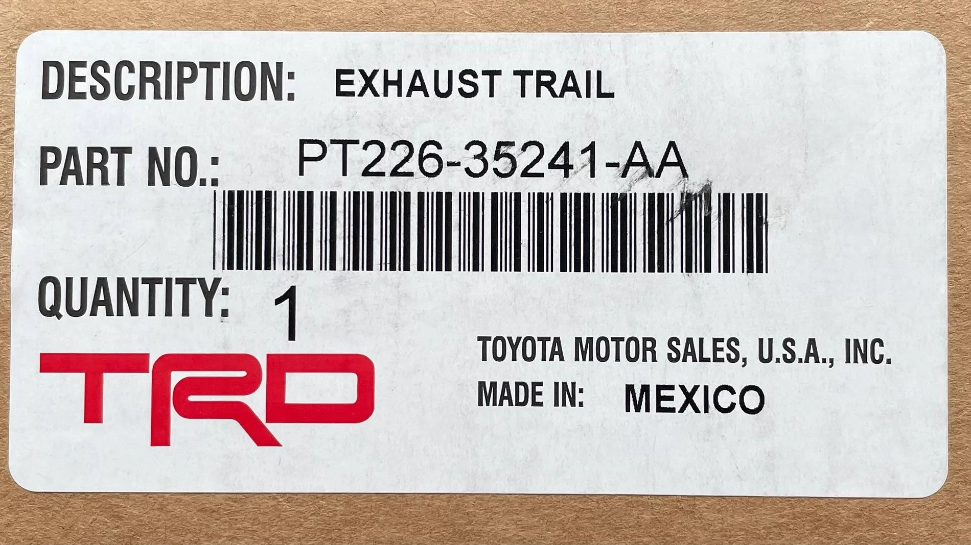

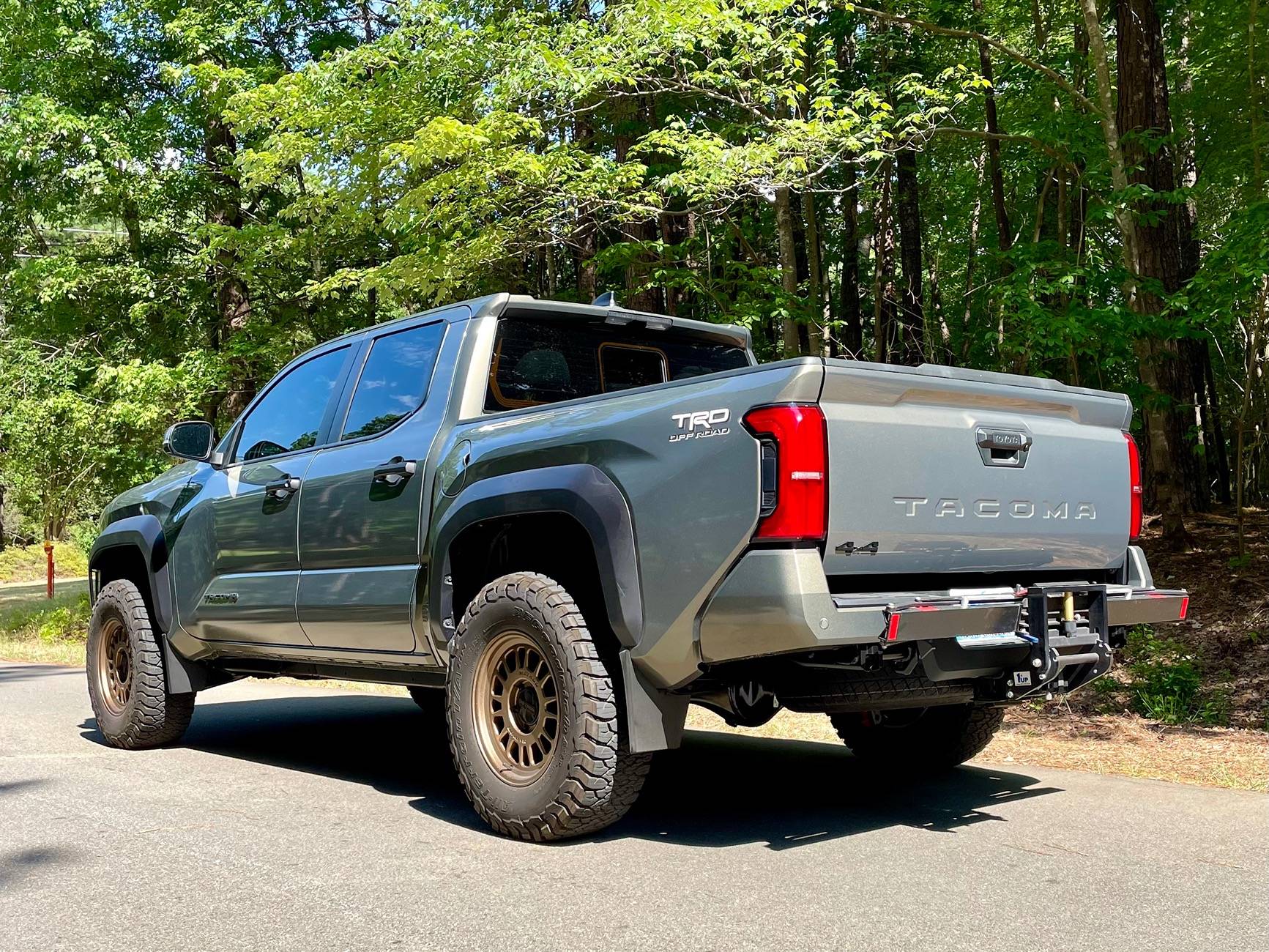

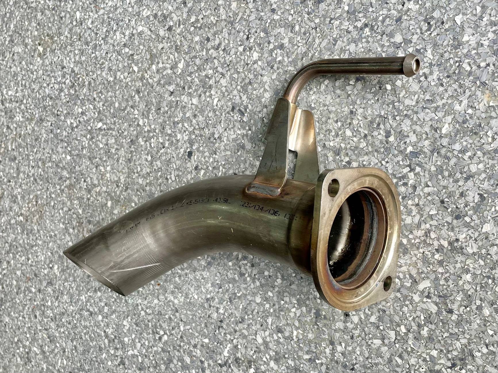

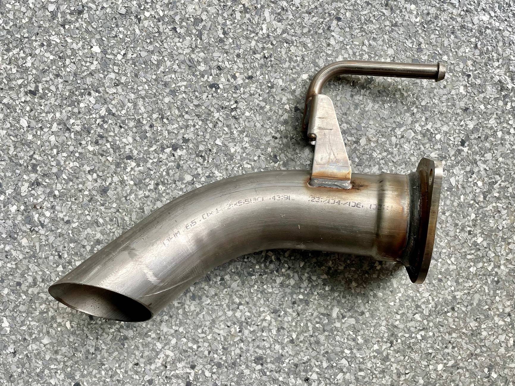

Ordered a “trail pipe” from my local dealer’s online parts site and received next day. Cost was $104. Install was easy but did require slightly jacking the back up to maneuver the old pipe out.
Happy with the clean look. Slight drone at idle but otherwise very little difference in sound.

Very tasteful upgrades. Very similar to what I’m about to do. My 6foot oxide will be here next week. Did you see what a muffler shop would cost first? 104 is not bad if you install yourself. Did you ceramic coat after the Ppf? Still debating that as well as tinting the moon roof.

Thanks and awesome that you have one on the way! With a newborn just arrived didn’t have time to go get quotes but my guess is $60-$100 to have one made at a local exhaust shop.
I have supplies for ceramic coat, now I need to find the time to do it!
I’m very happy with tint on the sunroof. It makes a big difference, I have the shade open far more than I would it didn’t have the additional tint.

Time to take off the white TRD OR sticker

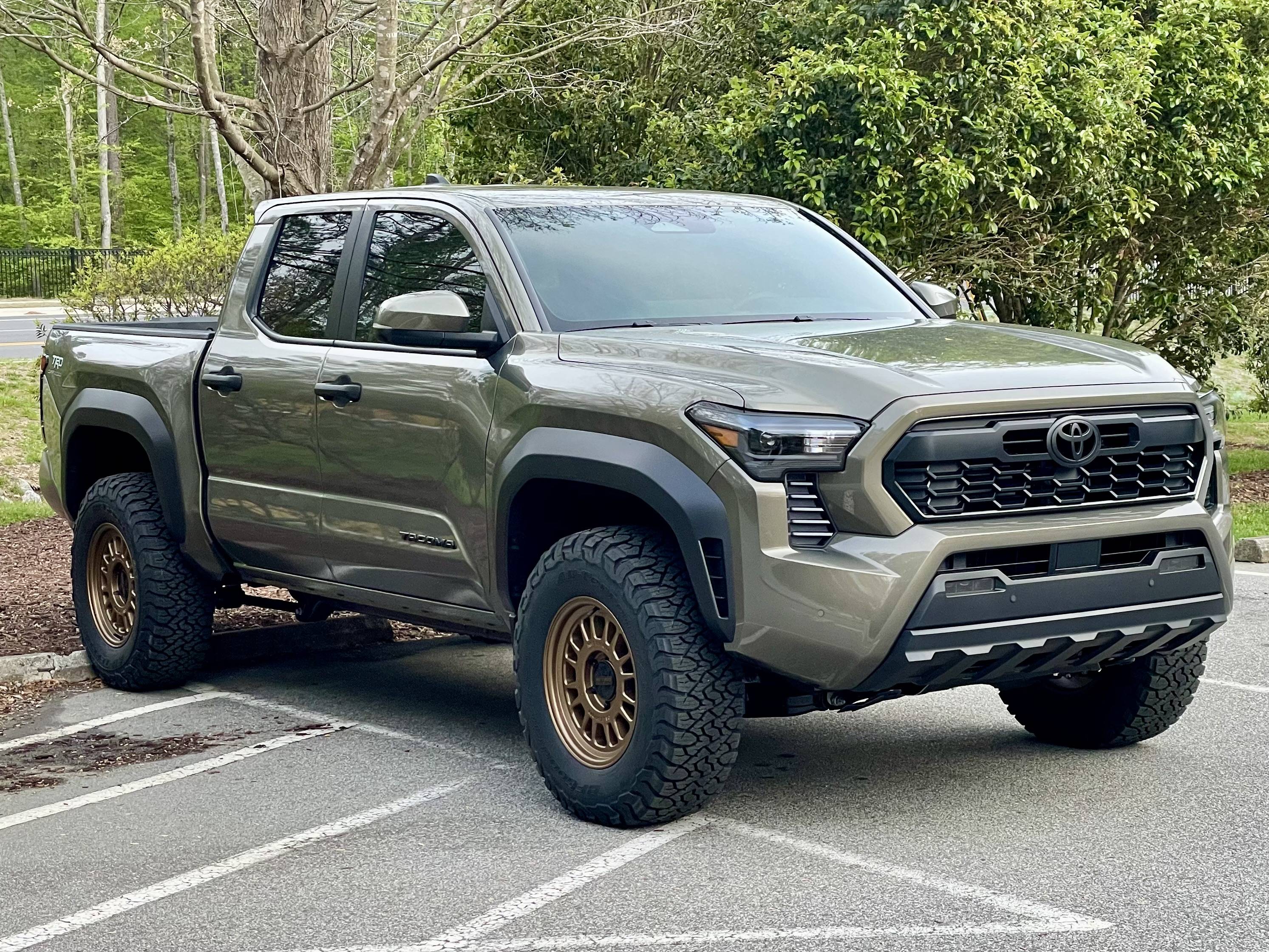

Love the 318's and KO3's! I'm thinking of doing the same setup on stock suspension and curious if you ever noticed any rubbing or if you had to make any modifications to fit the tires?

Thanks! No rubbing noticed though I wouldn’t say I put it through all suspension compression and steering angle scenarios. I did add a 1 inch spacer, not for clearance but for less rake.

What lift do you have on your truck? You say you have a small 1” inch lift or level kit but fail to mention that in the details? So what is it??? Please advise thank you

Why did you do the upper? Vs the lower only is better option because of top strut hat issues. But thank you
yes. Since I wanted a subtle front lift and it avoids spring compressors (I installed myself).
