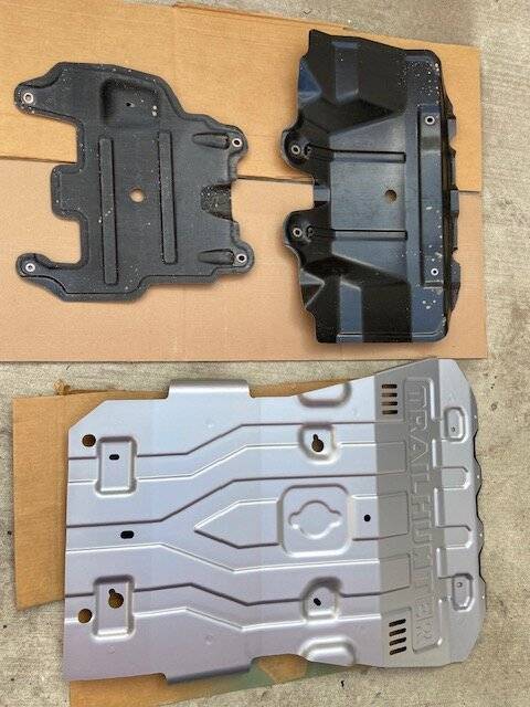

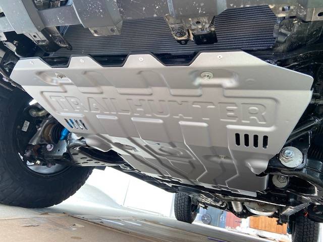

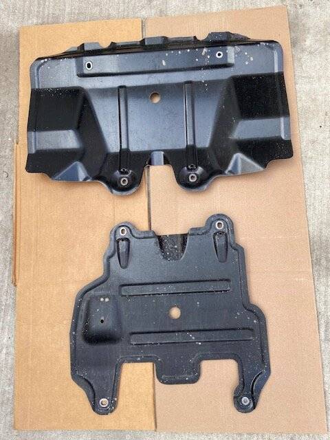

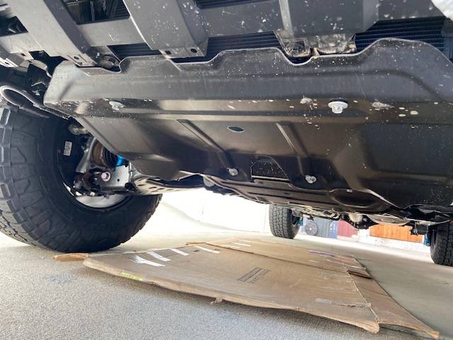

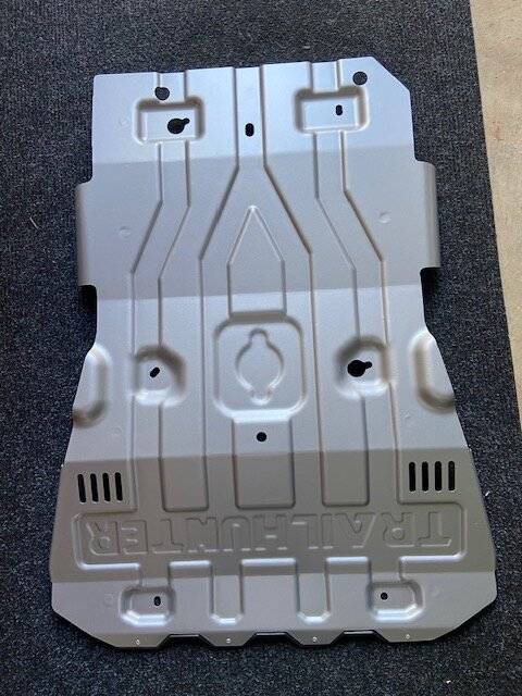

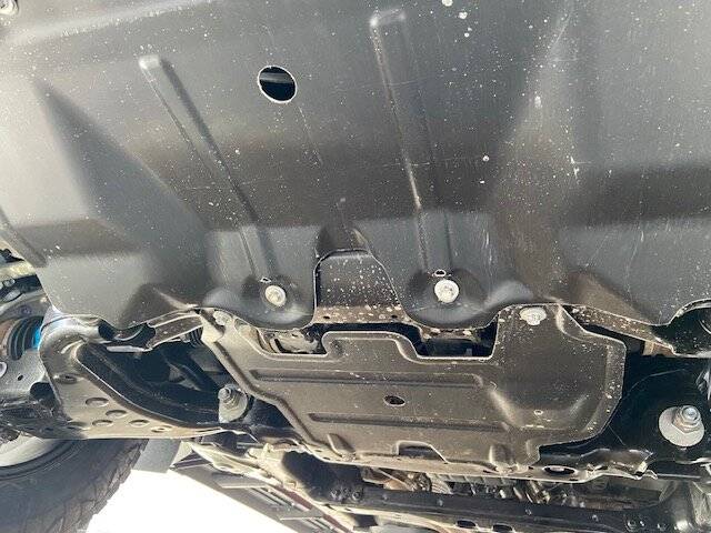

I decided to install my recently purchased Toyota OEM Trailhunter steel skid plate on my Tacoma TRD Off-Road truck today. The factory skid plates are made from a composite material. After a recent 130 mile over-landing trip I will feel more confident taking my Tacoma off the beaten path in the future.
It took me less than 30 minutes and the only tool required was a 12mm socket and ratchet.
Toyota elongated two of the bolt holes with slots to make installing and removing the skid plate easier for future oil changes. Toyota, kudos for that move!
I found the best price at Hendrick Toyota North Charleston:
Front Skid Plate - Steel
Part Number: PT228-35240
1$318.60
Subtotal$318.60
Discount (Nationwide Free Shipping)-$154.16
Tax$0.00
Shipping & Handling$154.16
Grand Total$318.60

I bought a Trailhunter skid plate too, and am more than pleased.
Plan A was to cut an access hole so I could slip a tube into my Fumoto oil drain valve, but the metal is hardened and is a great surface for dulling drill bits. Fortunately, it's an easy task to take it off and re-install.

Funny, I was thinking about using the same valve but the removal procedure seems pretty quick. Just remove 4 12mm bolts and loosen the last 2 with the elongated slots.

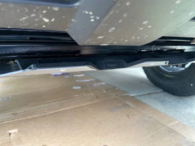

Made the same upgrade, love the little easter eggs of the old Yotas and it seems pretty quality. I would like to make note for future upgraders, if you have the sway bar disconnect option, the trailhunter skid will sit on top of the swaybar's steel skid and bolt in. I don't know if this is how it was intended to interface but it seems to be solid enough.

I believe you still need to remove the skid plate to access the oil filter.
Yep, and if you get the trail hunter transmission skid plate too, it will replace the sway bar skid plate and use its bolts, in the same front bolt holes, and two in the back. (At least I don't think all 3 steel skid plates will fit at the same time.)

I'm guessing the OEM TRD OR skid plates were installed to save some weight and cut costs.

I changed my Off Road to the TRD skid plate. It’s considerably heavier than the stock one I took off. May be a hassle at oil changes when truck is older and I have to do them myself, but that’s years away.
I’ll try to post a pic. Very happy with it.
