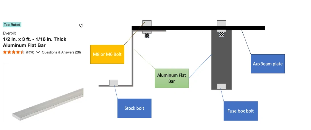

Switch Mounting Location
Next, I needed to decide where to mount the switch. I chose not to drill into or mount it on top the fuse box. Instead, I found an opening next to the second fuse, in front of the driver.
To create a mounting bracket, I went to Home Depot and purchased a 3-foot piece of ½-inch aluminum. This gave me enough material to bend and mount the plate that came with the switch.
I cut the aluminum in half and bent both ends into a Z shape using a large vise, which allowed me to securely mount the switch plate without drilling into the vehicle, and I used the mounting plate that came with the 8-gang switch.

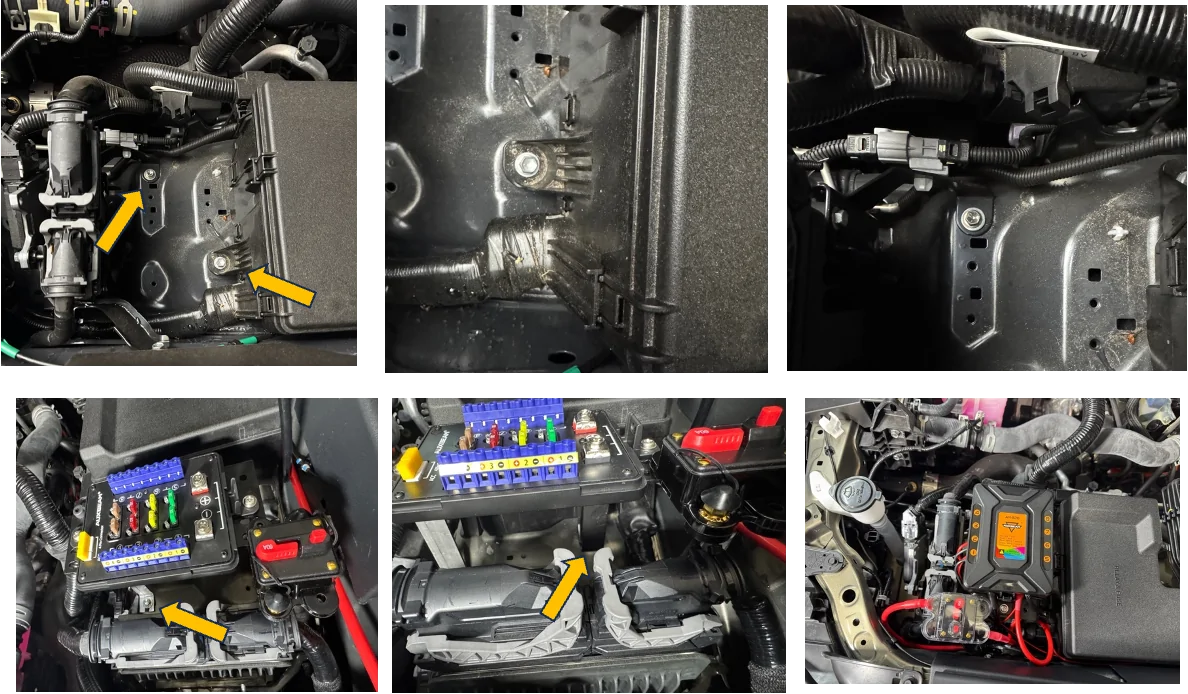

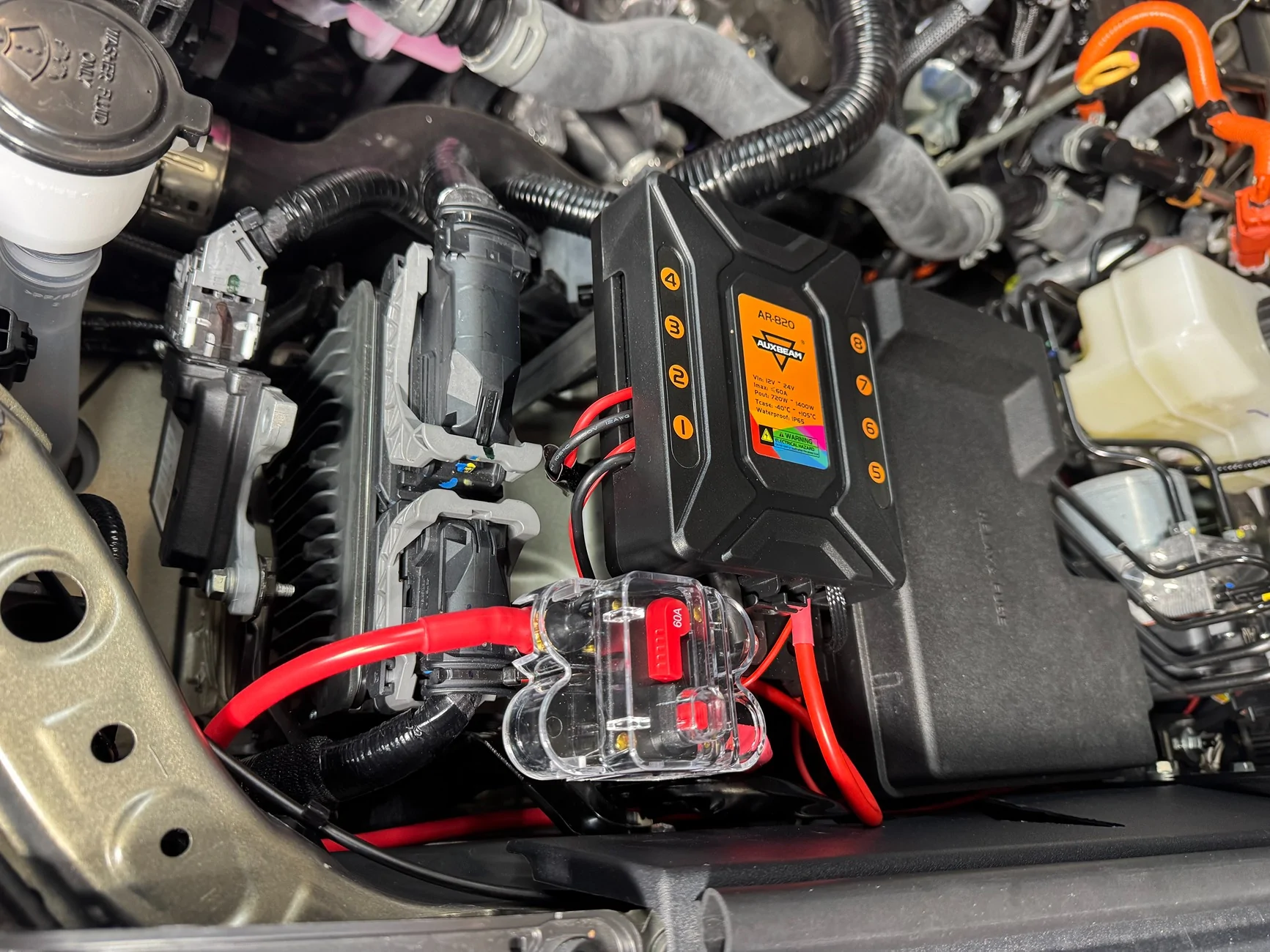

⚠ DO NOT CONNECT THE CABLE TO THE BATTERY AT THIS TIME, and disconnect the negative terminal from the battery. Be careful with your wrench when removing the bolt. If you touch any metal, you will get a big spark. Just from experience.
Purchase a six-gauge battery cable. Approximately 11 feet is required; however, Amazon only sells the cable in 15-foot lengths.
Purchase heavy-duty copper wire lugs sized for six-gauge cable and the appropriate battery terminals. The lug size used was 6 AWG – 5/16 in (M8).
Mount the power distribution plate and the AUXBEAM control panel before cutting the cable. This ensures the correct cable length.
After the mounting locations are confirmed, measure the required length and cut the cable to size.
Strip the insulation from both ends of the cable, exposing enough copper to fully seat inside the wire lugs.
Install the wire lugs onto each end of the cable using a heavy-duty crimping tool. A proper crimp is required for a safe and reliable connection. If a suitable crimping tool is not available, one should be purchased.
For added durability and corrosion protection, apply heat-shrink tubing over the crimped connections.
Route the completed power cable from the back seat area toward the front of the vehicle.
Pass the cable through the firewall using an existing rubber grommet to prevent chafing.
Continue routing the cable into the engine bay, securing it away from moving parts, sharp edges, and heat sources.

ACC Fuse Tap Extension
Extend the ACC fuse tap included with the switch system using 14-gauge power wire.
I used a voltage tester to check the fuses in both fuse boxes under the hood. The engine-bay fuse box contains circuits that are either continuously active when the truck is off or inactive when the truck is on. As a result, it does not provide a suitable accessory (ACC) signal. It’s possible that I may have overlooked a circuit during my testing process.
Route the ACC wire to the fuse boxes located under the glove box to obtain a proper accessory-powered source.
I chose to use the USB 2 fuse. If this fuse blows, it will only cause charging issues for the port. This is why I decided to use the USB 2 fuse as the accessory (ACC) signal.
The fuse tap has two fuse openings; install two fuses. When I use just one fuse, the USB-C port does not charge while the switch system is on. After adding two, I resolved this issue.
