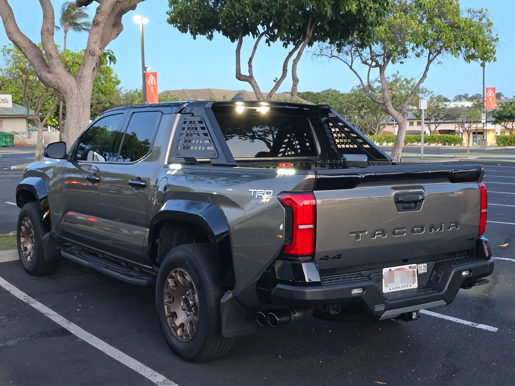

Wanted to thank all of you in this thread for figuring out the bed scene lighting installation. One of my favorite mods so far. Been using my key fob more to unlock so I can see it light up as I walk to the truck. I even turn them on sometimes when driving to light up the blind spot and look at them in my sideview mirrors. Highly recommend!
Couple pics at dusk:
2024 Tacoma Bed Cap Scene Light Installation 20260802_192223(1)
2024 Tacoma Bed Cap Scene Light Installation 20260802_192254(1)

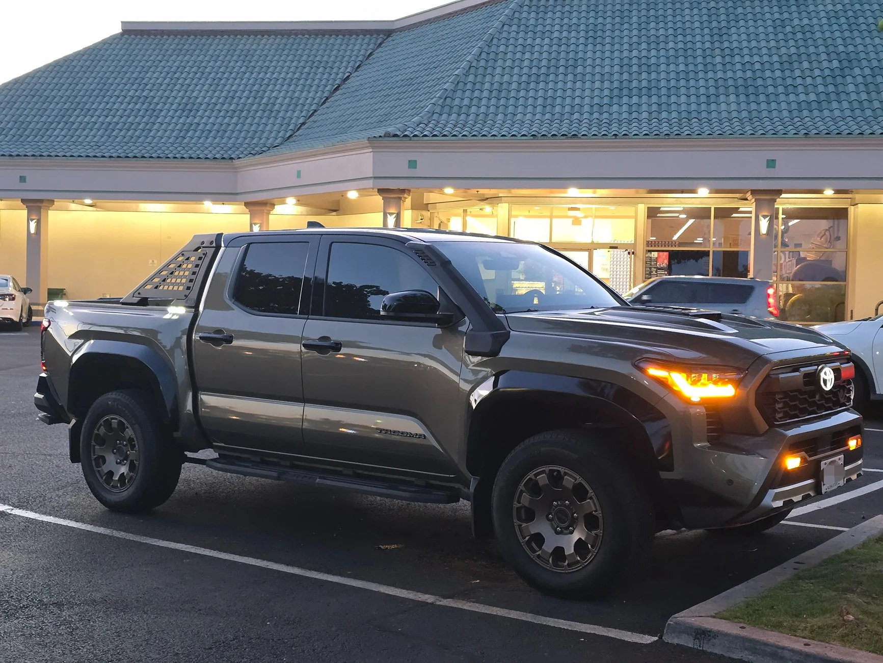

Nice! You got more angles of your truck?
Aside from the photo I just uploaded in the edit of the previous post, not too much pics showing the tire "poke". If you want more pics of how it sits now, I've only got a couple pics of it in my driveway and one more from tonight. Was admiring how it looks with the ARB sport bar, I've always liked the look of it and finally got a deal on FB marketplace for 400 USD!
2024 Tacoma Bed Cap Scene Light Installation 20260731_135815(1)
2024 Tacoma Bed Cap Scene Light Installation 20260731_150248(1)
2024 Tacoma Bed Cap Scene Light Installation 20260731_150233(1)
2024 Tacoma Bed Cap Scene Light Installation 20260731_150303(1)
2024 Tacoma Bed Cap Scene Light Installation 20260802_192247(1)
