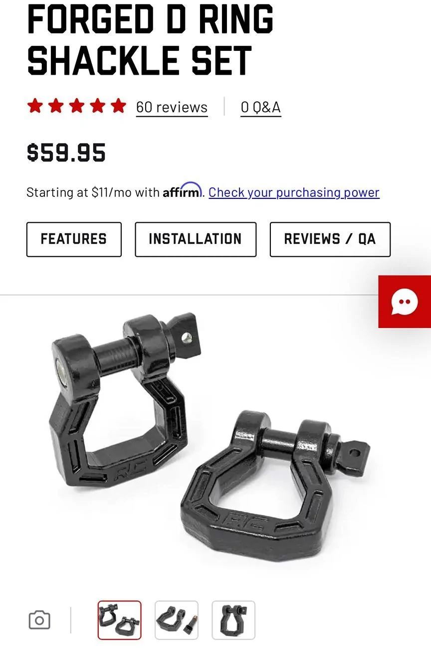

I just received these as a gift for my birthday. I’m looking under my 2024 Tacoma and don’t see any attachment points. Is there anything I need to add to get these on properly? TIA
I had the same issue. I want those type of recovery shackles but like soupy1234 said you have to have the right setup on the frame. I haven't seen anything that would work for those yet.

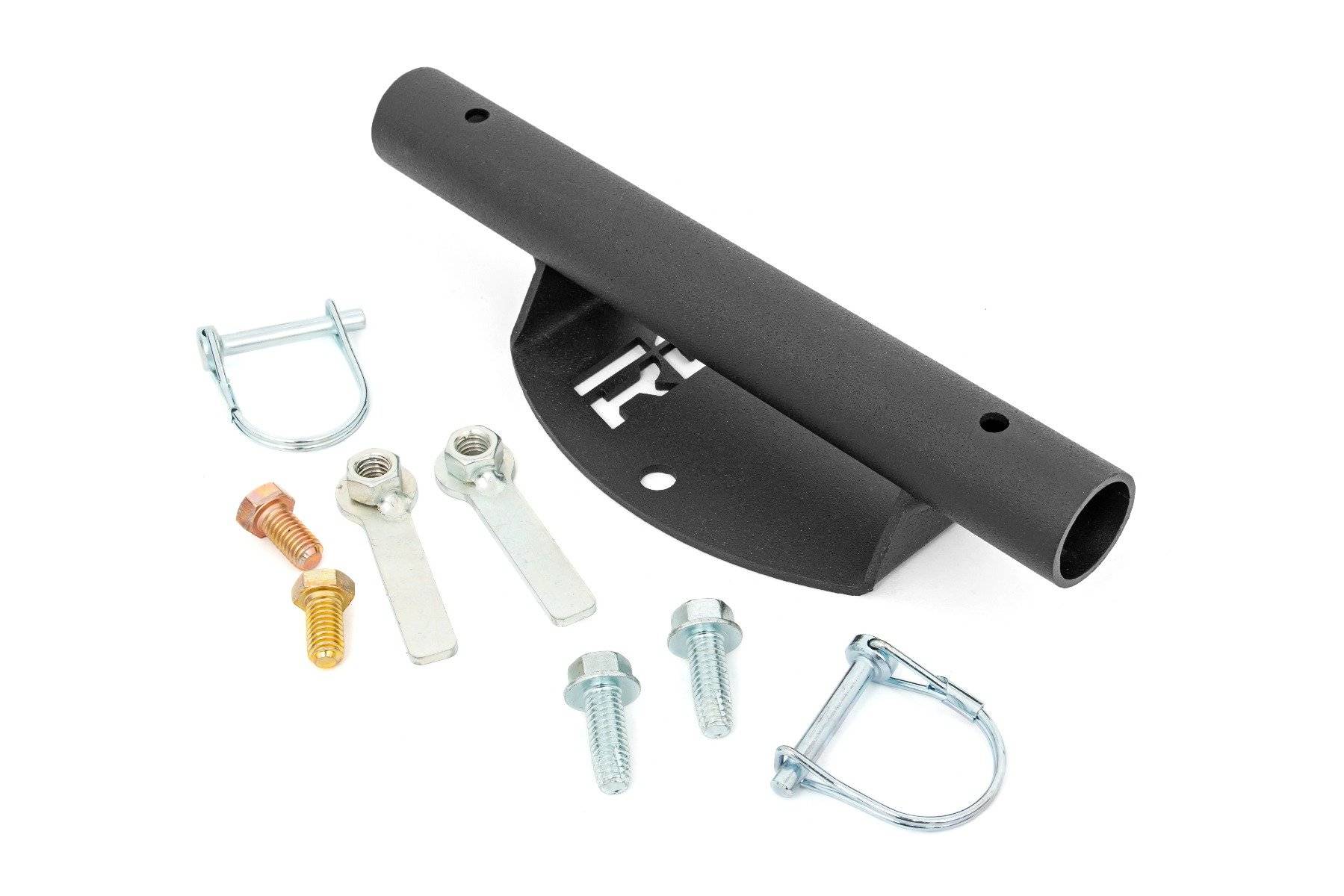

If you don't want to spend a bunch of money on recovery points for now, you can get a hitch receiver recovery point. This one is just the first I found on Google, there are lots of others. Many will already include the D-rings so you might have to hunt for one that doesn't.

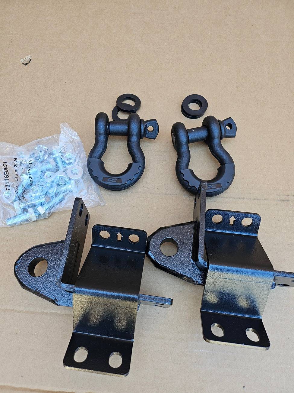

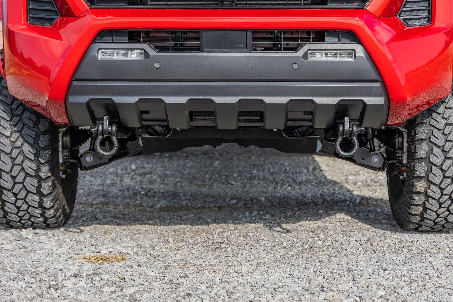

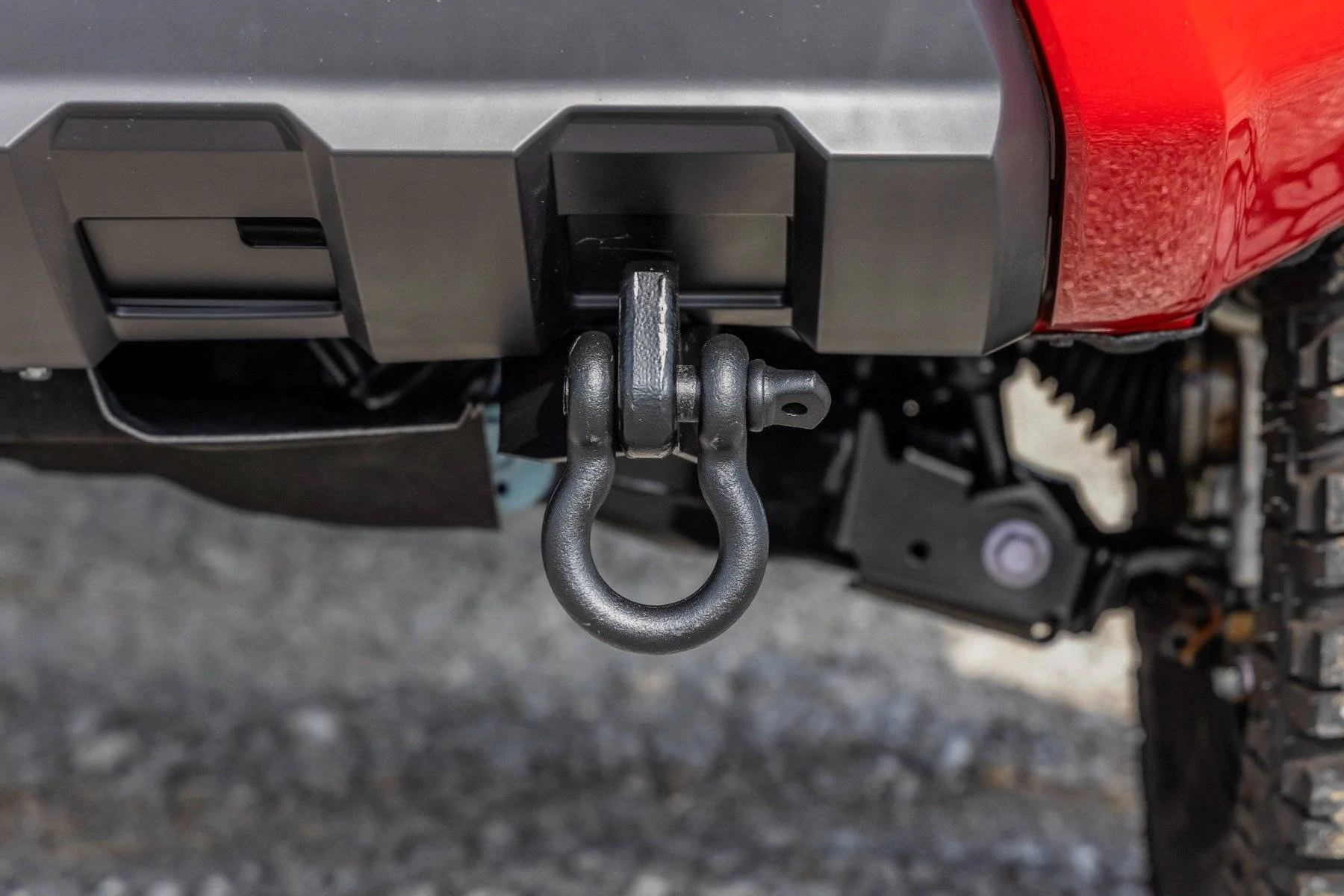

I went with the Rough Country kit and they are solid for the price. They offer front and rear.
Just looked at their site. Down towards the bottom they say It doesn't fit TRD off-road
StreeTaco
Sep 16, 2023
551
721
TN
2024 Tacoma TrailHunter
Hopefully they meant TRD Pro.. OR is the most common trim

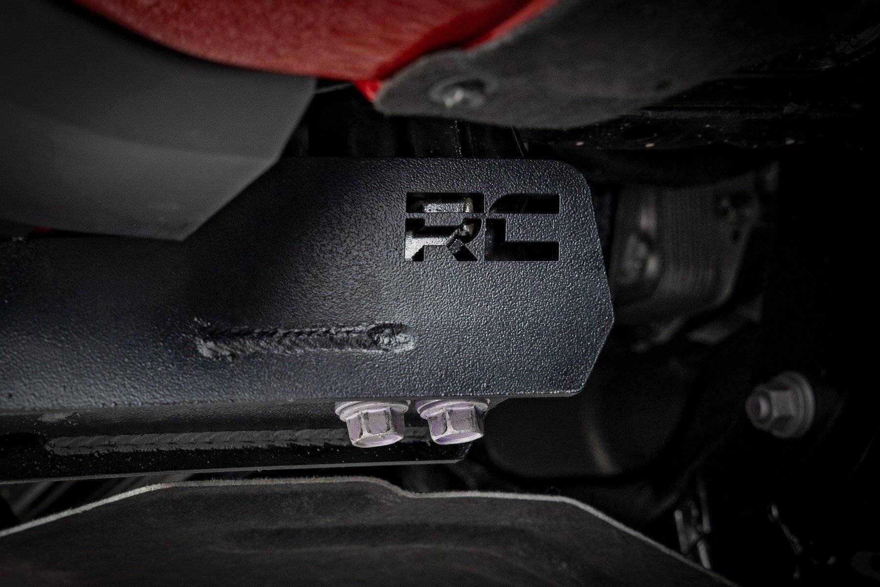

  • Easy, bolt-on install using factory mounts under frame with no cutting.
  • Center mounts made from 1/2" Steel.
  • Mounting plates constructed using 1/4" Steel.
  • Wrapped in 7ga steel with laser cut RC logo.
  • Laminated design for added strength.
  • Accommodates shackles or D-rings with 7/8" pin diameter.
  • Mounts to frame horns behind front bumper for added support.
  • Durable, black powder coat finish.

Rough country makes a rear shackle kit that I installed. I upgraded the shackles it came with and went with something like yours. Their front shackle kit does not work with the OR trim because if the front cross member. I had to return them.
soupy1234
May 3, 2024
266
192
Show Low AZ
2024 Tacoma OR Long Bed

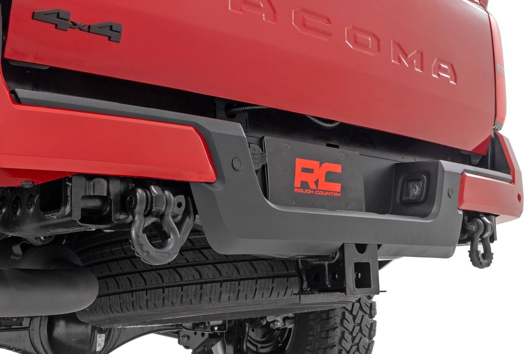

Fronts don't fit Off-Road.
Rears do not have that restriction.
Not sure I like the way they mount by using brackets around the bumper frame.
If anyone has actually seen the rear set, how thick is the metal?
Edit: never mind, I see it says 1/4 inch.
