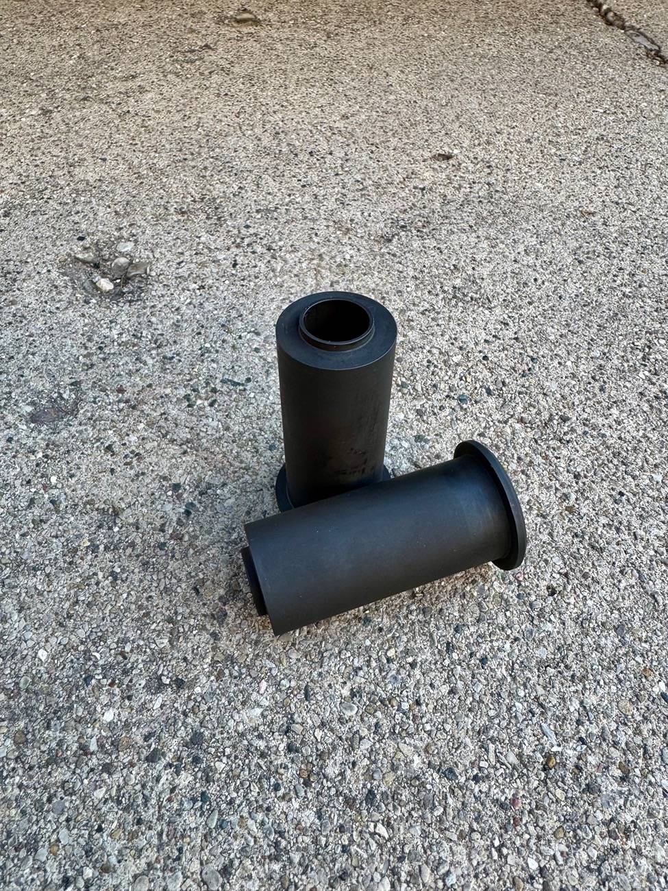

The pins worked out great. Stainless steel 17-4PH with a black oxide finish. The fit was perfect.
I have 4 more pins if any TRD Sport nerds are interested.
Hello,
where can I purchase 4 of these sleeve? My truck does not have them & I would like to install the ARB recovery points. Thanks for your help.
Not a Sport nerd, but an SR5 peasant. I'd appreciate the pins, if they're still available. DM sent

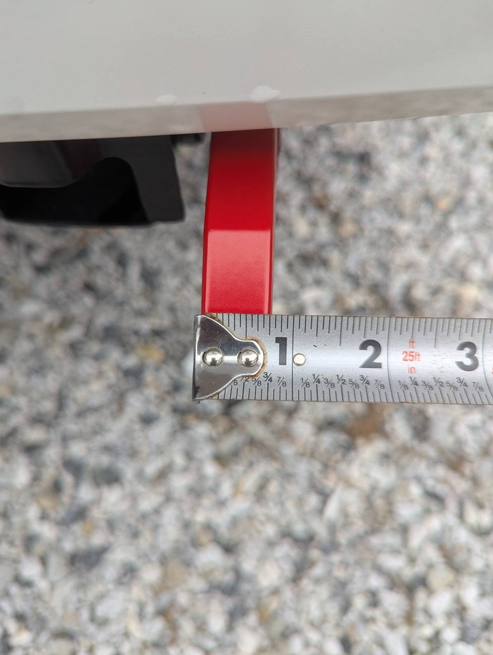

Hey guys, can anyone with the arb recovery points tell me the thickness of the recovery portion thats sticking out?

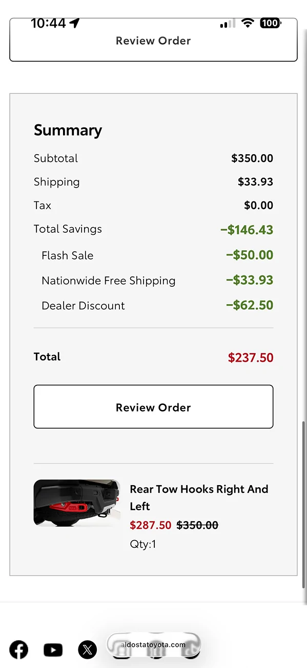

Take advantage today if you want your hooks; there’s a flash sale this weekend. I just got mine.

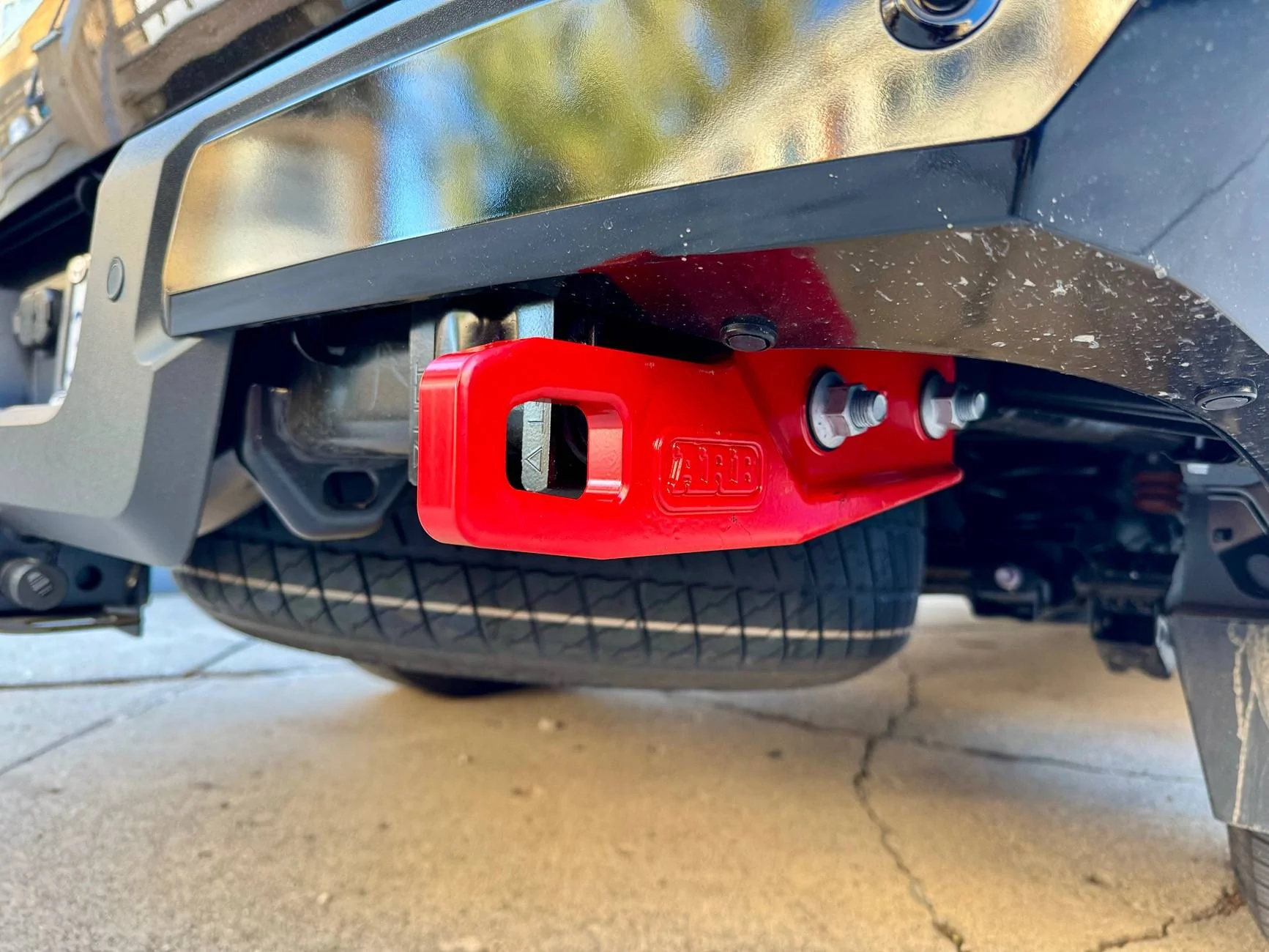

2024 Tacoma Install of ARB Rear Recovery Points on the 2024 Off Road Premium IMG_1175
