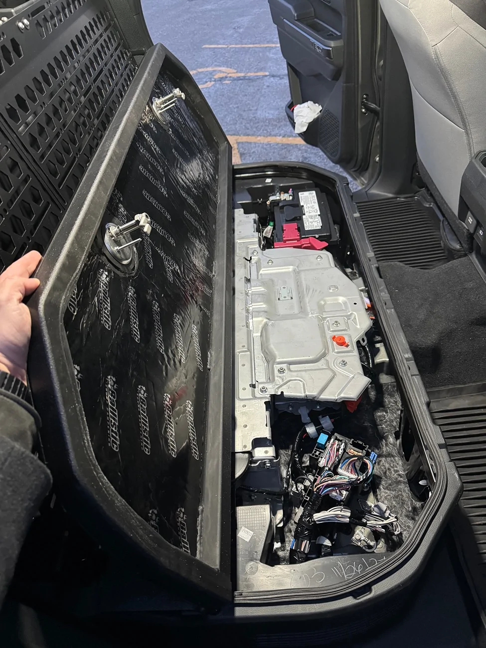

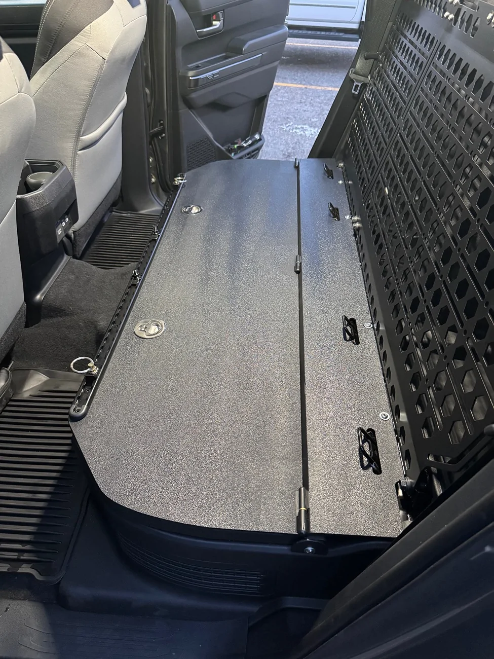

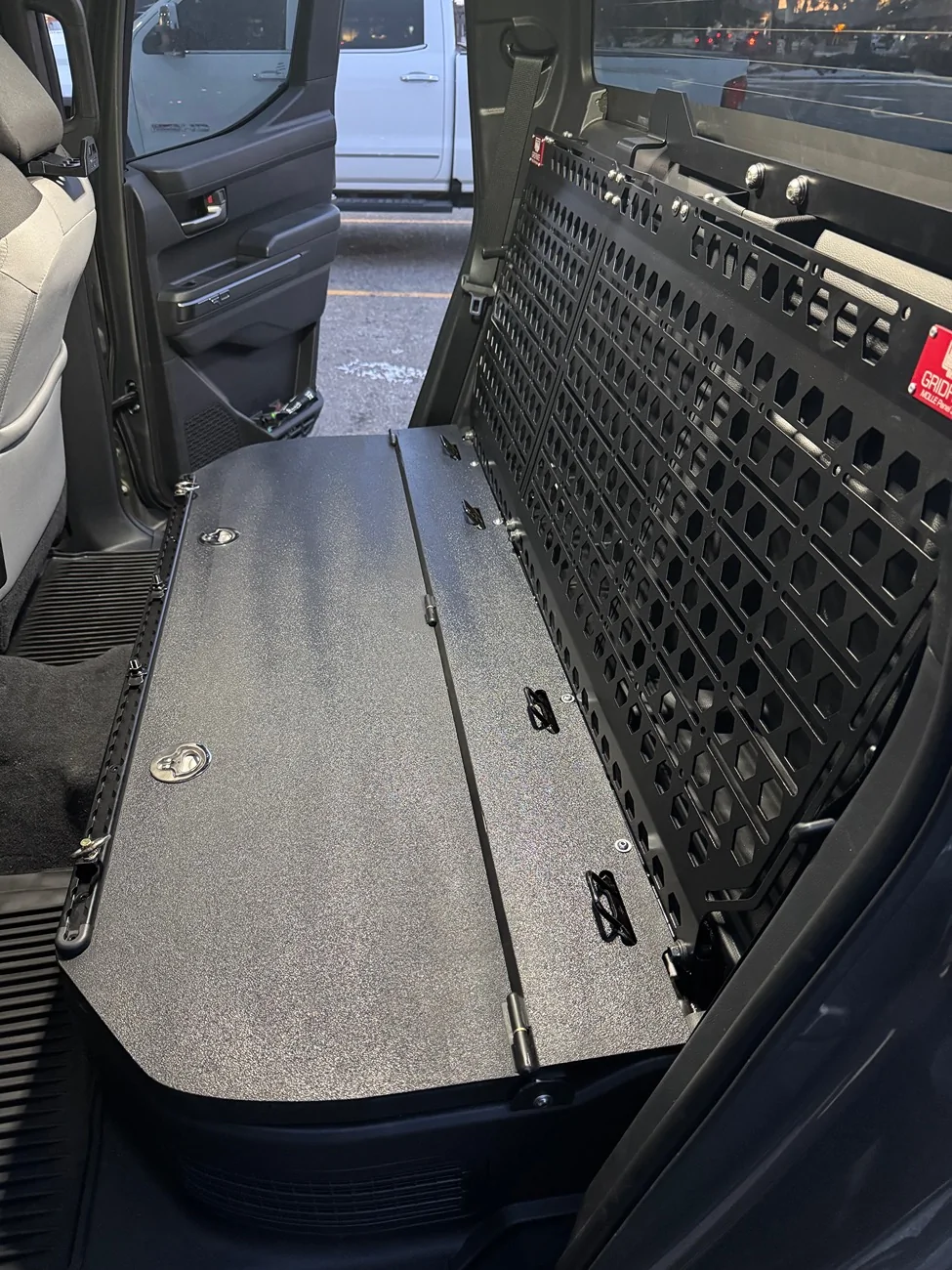

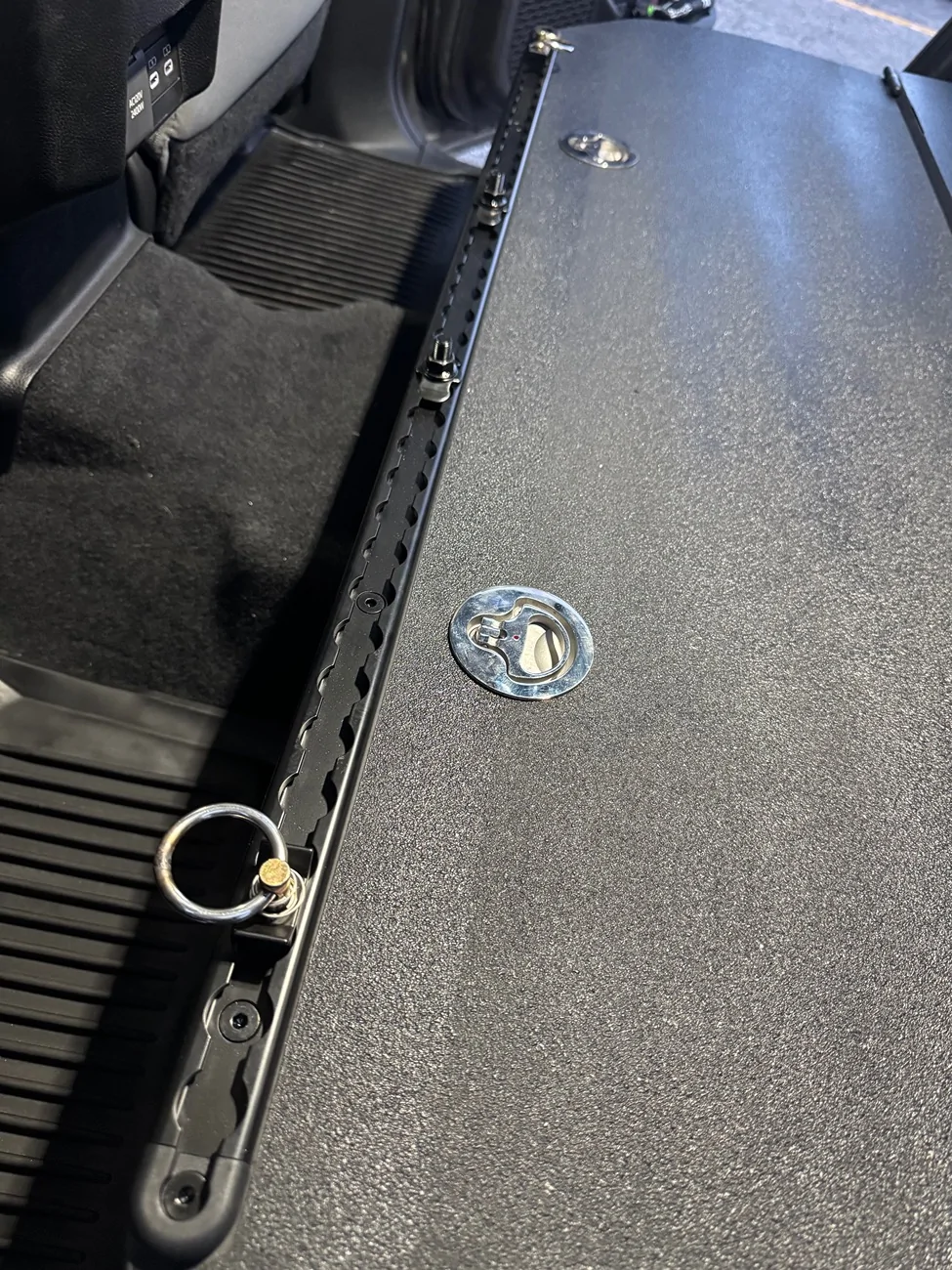

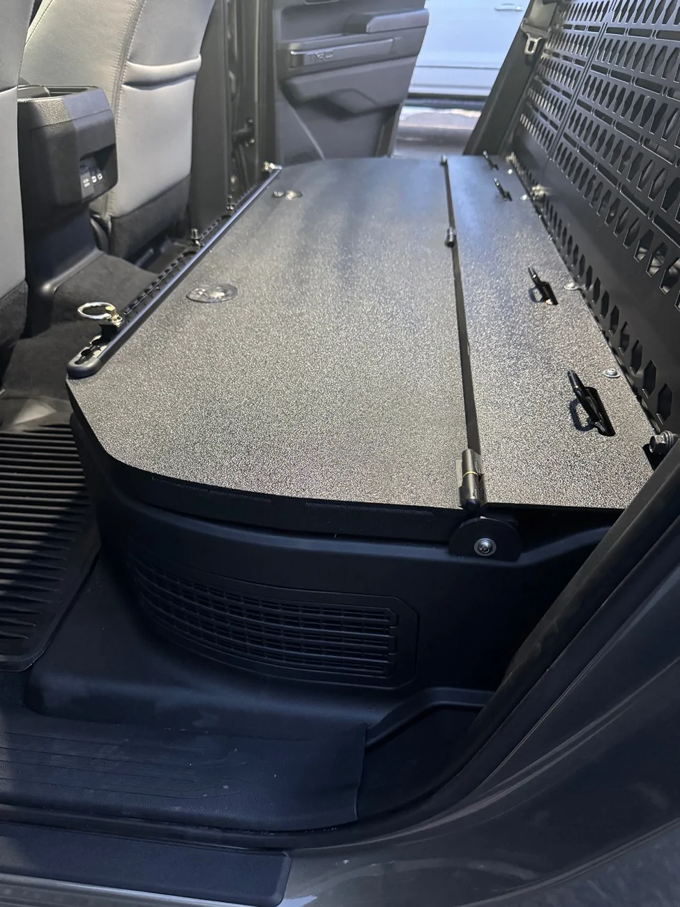

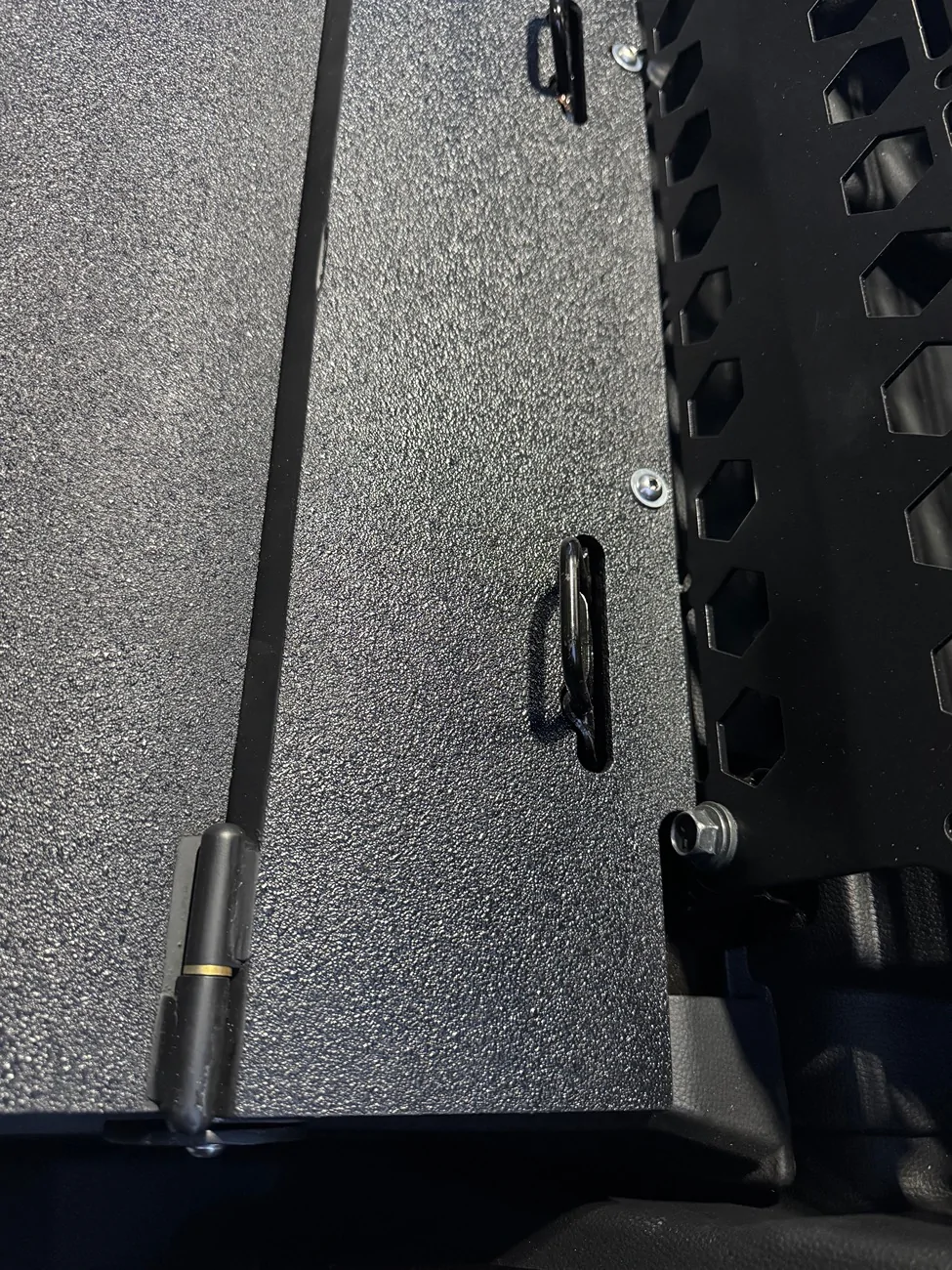

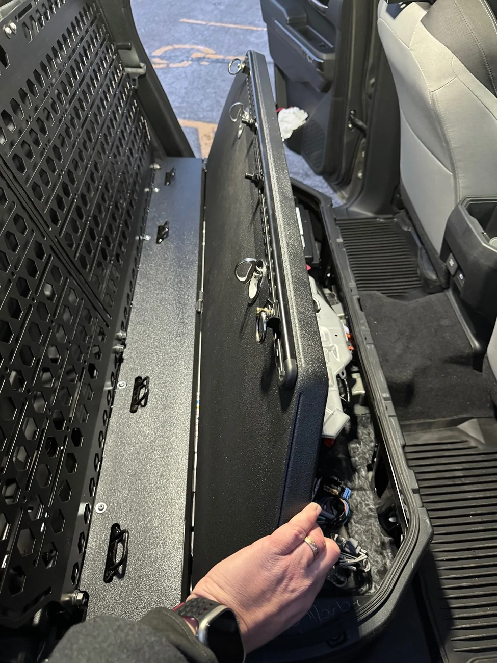

So I’m working on my Tacoma build, I have a 2024 TRD OR Hybrid. Latest and greatest addition was this custom made rear seat delete.
My boy Dakota Bush, over at KDR Industries in Billings, MT, made this custom platform. The platform is a two piece design running on hinges for easy access to the hybrid battery. The platform has a built in L-track and retains the use of the four backseat anchor points for tying down gear. It locks to the backseat frame, has sound mat for the road noise, weatherstripping for stability, and was finished off in bedliner material for grip. This thing is stout and exactly what I wanted for my build.
If you're interested in one of them, reach out to him below. He kept all the dimensions and can reproduce it.

Great photo lay out, and good info. My dogs are small so I just lay the back seat backs down and use a solid kydex sheet across the back to cover and hold items in the space available. The only thing missing from your photo's is how the upper corner of the back panel on the driver's side is secured. I am able to secure the passenger and middle of the sheet, but not that corner. How'd he do that?

That looks really well built. How much does it weigh?
The ONLY thing that I would change, which you can DIY, is to cut down the excess length on the latch screws. I know you can't see them when the panel is closed but it still bothers me. 😂

This one is pretty stout. We were discussing using aluminum for the panel, but I went with 10 gauge steel for rigidity and cost. I’m sure you can cut the weight with aluminum, but it wasn’t the most important part to me and I wanted it to be extremely rigid and durable.
Yea, I noticed those bolts too. I’ll probably trim them up for aesthetic purpose.
I’m pretty sure it’s just resting on the preexisting platform. It was fitted specifically, but I can look and see what was done.

I want,
But it probably insanely $$$ to ship that to Canada.
It’s definitely worth reaching out to Dakota, I would go with an aluminum build instead of 10g steel. It will help with weight and there may be a freight option 🤷🏼‍♂️

I did send and e-mail already and ask for aluminum...
How hard was it to fit the SXTH Element panel since they keep mentioning it is not compatible with the jbl sound systems,
I havent order them yet.

I don’t have the JBL system in my hybrid, I’ve heard from other people they will fit with the JBL it’s just a super tight squeeze. It was also a really tight squeeze for the hybrid since the back panel comes apart differently than the non-hybrid. It’s doable, just tedious.
I think it looks great once it was installed and I think it will suit my needs quite well.
