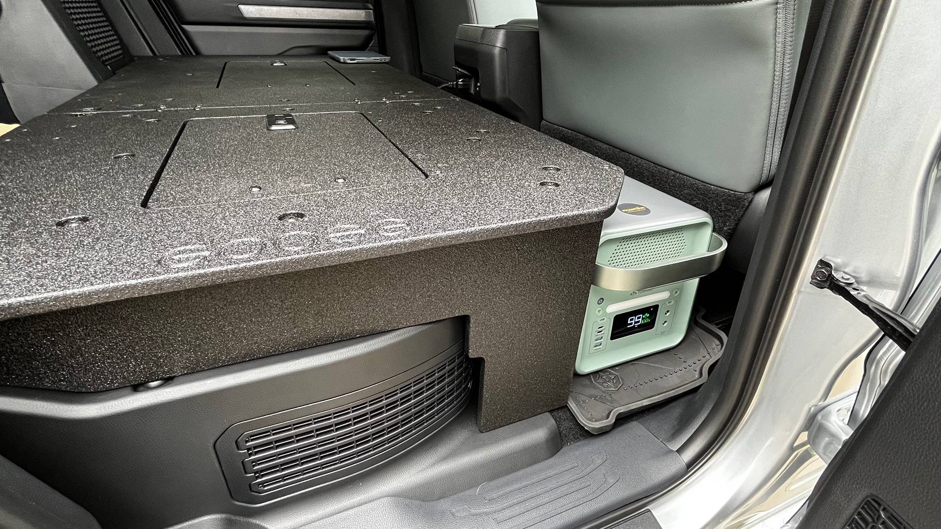

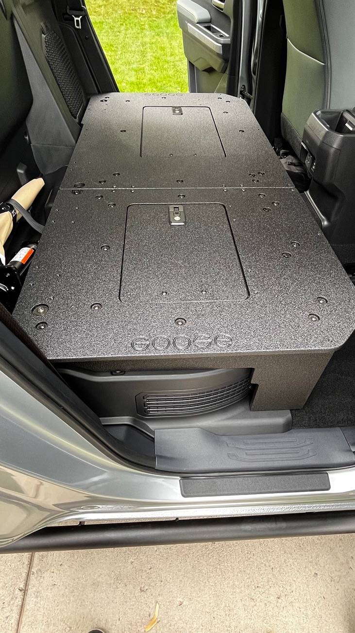

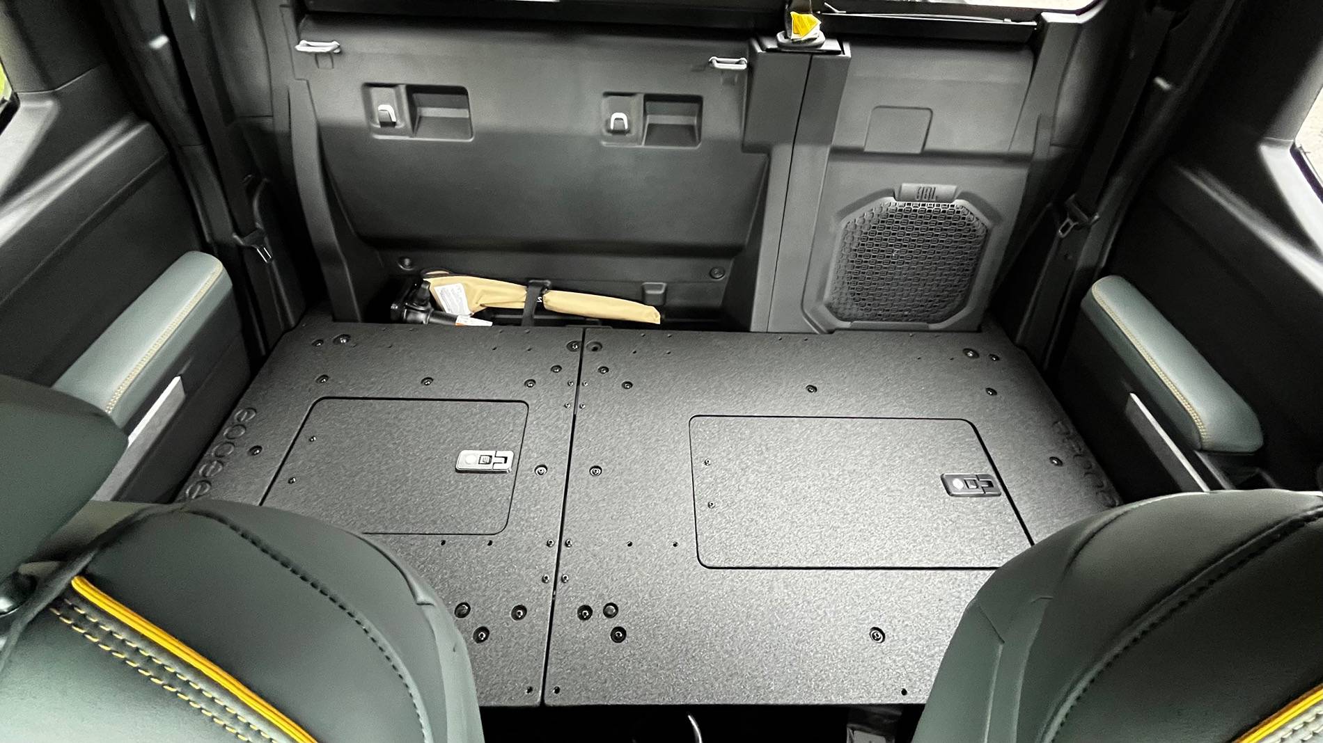

Installed Goose Gear 100% rear delete on my Trailhunter today. 5’-10” still have some solid room at the floorboard behind the seats. Can still fit a 1.4kWh SSB power station perfectly in there for most trips; the passenger seat-back snugs it into place with the rear A/C vent pointing right on it. Couldn’t ask for a better setup.
Took almost more time to wrap & protect my back seats for storage than build this kit.
Can confirm there is room under the hatches for a few light duty things like windshield sunshade, towel, first aid kit, emergency kits velcroed to the underside of the hatches, maybe stash an iPad or laptop when traveling, etc. Rigging an XPS foam standoff to isolate the hybrid guts from whatever I stow under the deck. I’d be mindful of not over packing this area, and obviously avoid putting anything wet down there or above it. No big water jugs on the deck is my rule after seeing what it looks like under the back bench of the hybrids.

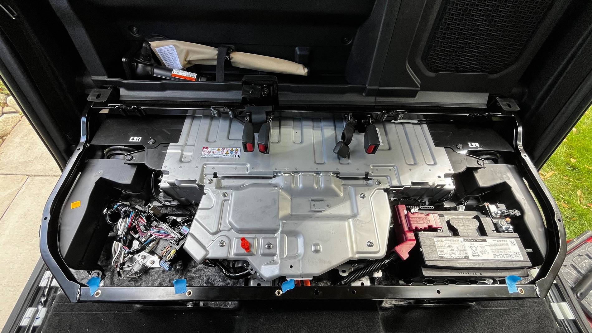

Curious what the blue tape is marking out - do you have to drill holes for this install? It's odd that Toyota didn't at least leave us a flat surface under the Hybrid's seats.... this seems like an easy aftermarket addition.

Blue tape denotes pop-pin trim fastener holes that need to get expanded to 25/64” for rivet nuts to install & secure the front end of the Goose Gear decks. That’s the only modification to the truck required for the delete kit. The underseat frame on the hybrids is leveled off (sloped for the non-hybrids) but the deck needs to be set at this height because the latch pins for the OEM seats protrude upward at an angle. Goose Gear could’ve notched around them but a flatter contiguous deck is preferred here IMO and it protects that bar which is welded into the frame I believe. It’s a really difficult piece to replace if it ever became damaged your back seats can’t re-install. The entire back seats are 4 bolts. You reuse the factory bolts on the Goose Gear system, and they provide some antiseize; keep those threads in good shape as I’m thinking I might need to install the 60 ~once a year when family or friends are in town.
Seat belts & clips + their bolts aren’t touched before, during or after this installation.

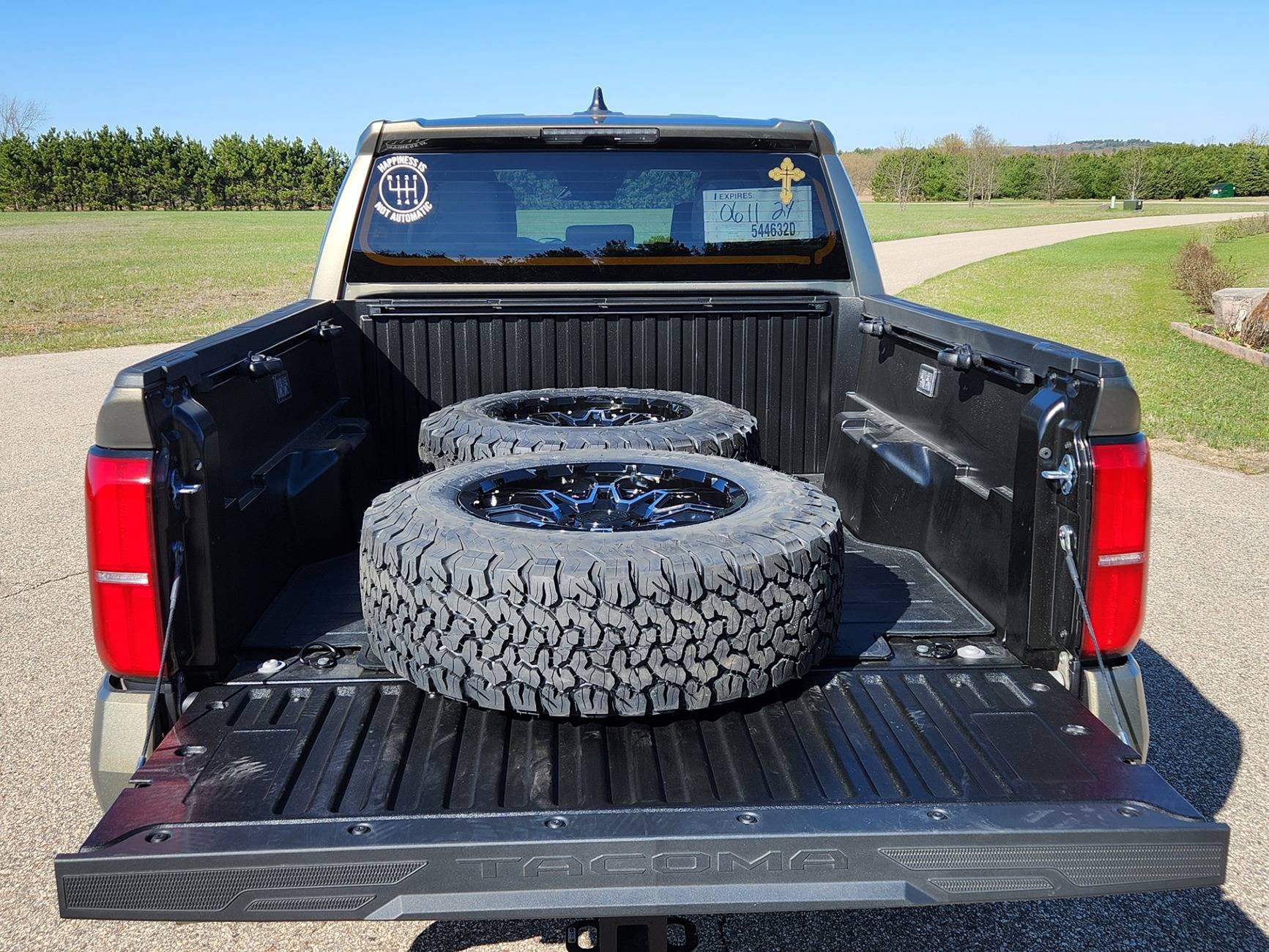

Can you fit a 33" tall tire on top of the rear seat delete?
Looking at using that as an option when I need the bed, Having a place for the spare that sits in the bed right now, when I need it.

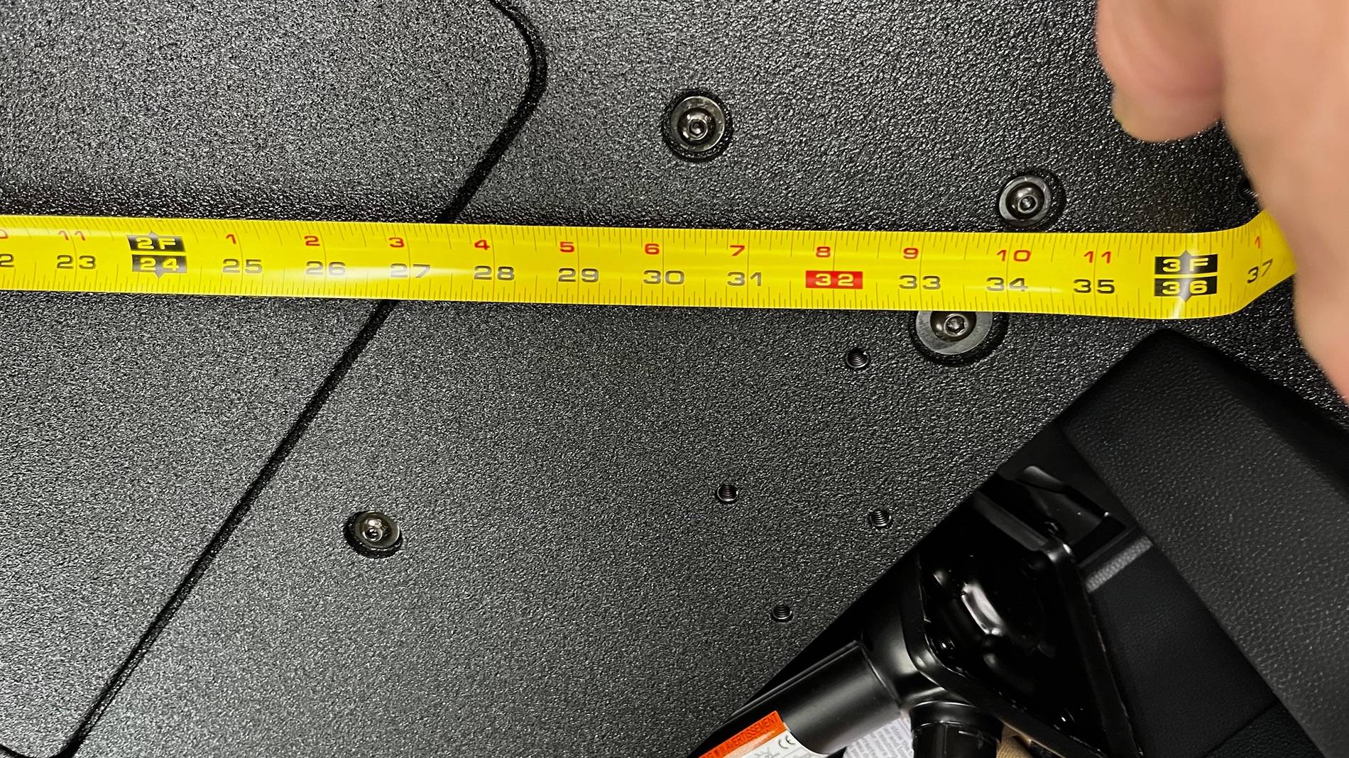

You get an easy 34" from the back of the front console housing to the back wall passenger-side corner. Move the front passenger seat forward a skosh/tilt up and you should be good to strap it down. (Mine is a hybrid, I presume the non-hybrid is a carbon copy double cab interior as far as depth of this area)

What about standing the 33" tire up and locking it in place with the seat belts, enough room?
On my SR accesscab, I used to fold the bottom seat up and drop the tire between the fold up and theb rear passenger seat and it sat nicely.

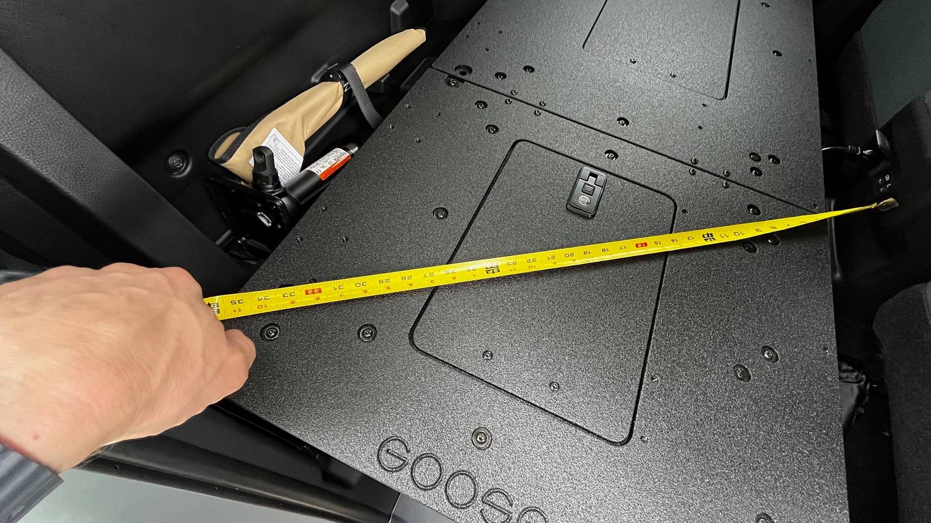

it's gonna be snug: 33" from deck to the dome light. You can tilt it back, probably need to because the back curves downward toward the window. Tire is probably too wide to fit partway into the hatch cutout. laying it flat looks the easiest. Protect the back of your passenger seat.
EDIT: FYI you can't access the seatbelt clips w/the Goose Gear delete kit so you'd have to lash that tire down to the deck somehow.

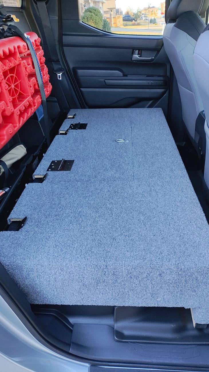

I did a hinged 40% using a machined aluminum bar between the seat bolt holes with hinges mounted off that and then a 3/4" plywood delete that flips up. 12v battery fits nicely under it. Pics at spicy.red.taco on IG, I deleted them off my phone.

I do like the looks of the Goose Gear, but my wallet would not budge. I built my own rear deck and it turned out just fine. I left the plastic tub as I wanted to use the storage bins already there.
