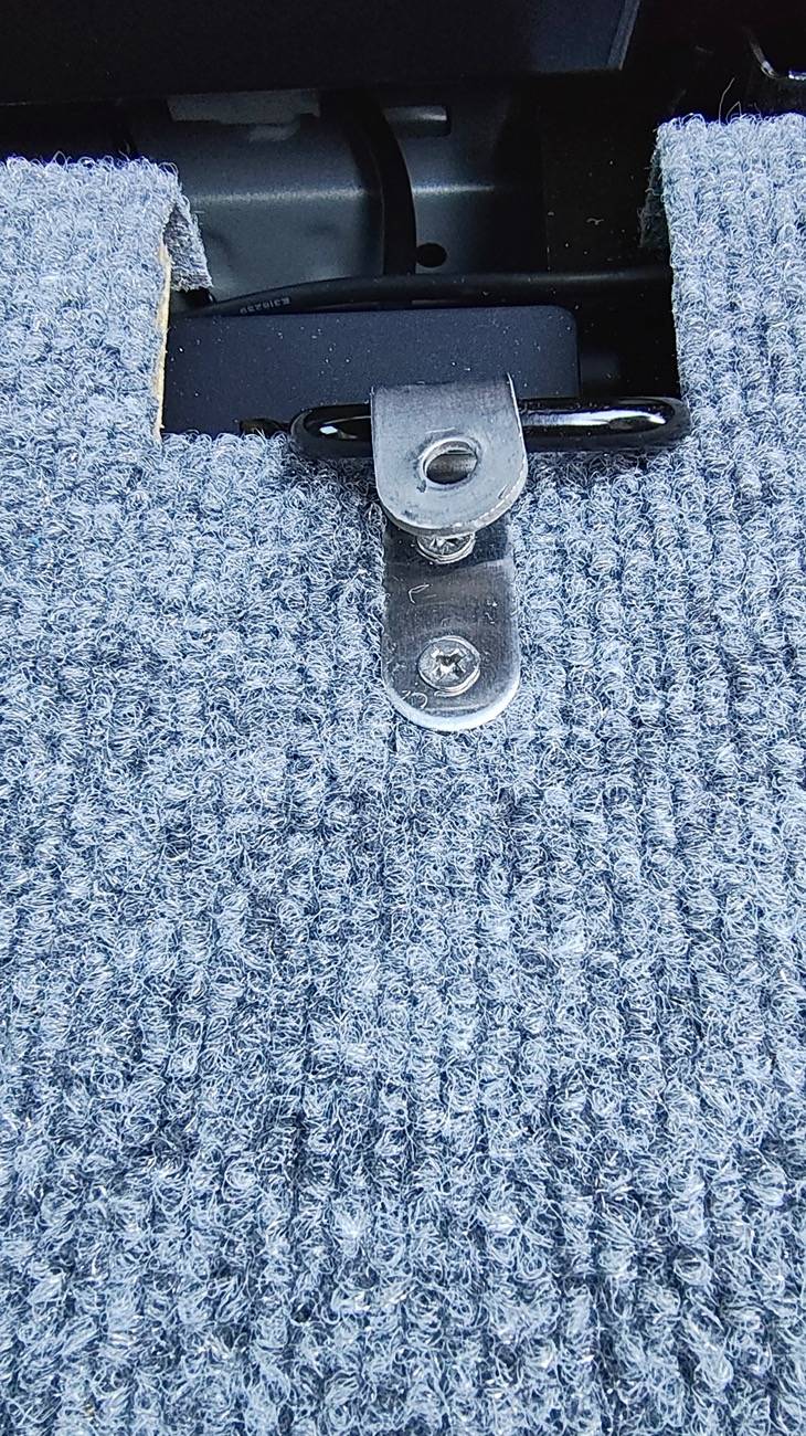

I used the seat brackets on the ends to screw down an “L” bracket to the rear deck. Keeps the deck in place. I don’t plan on removing so I bent the bracket over to secure it even more. I can take a pic but it is cold and I’m nice and warm. lol.

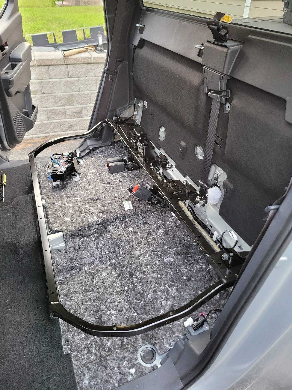

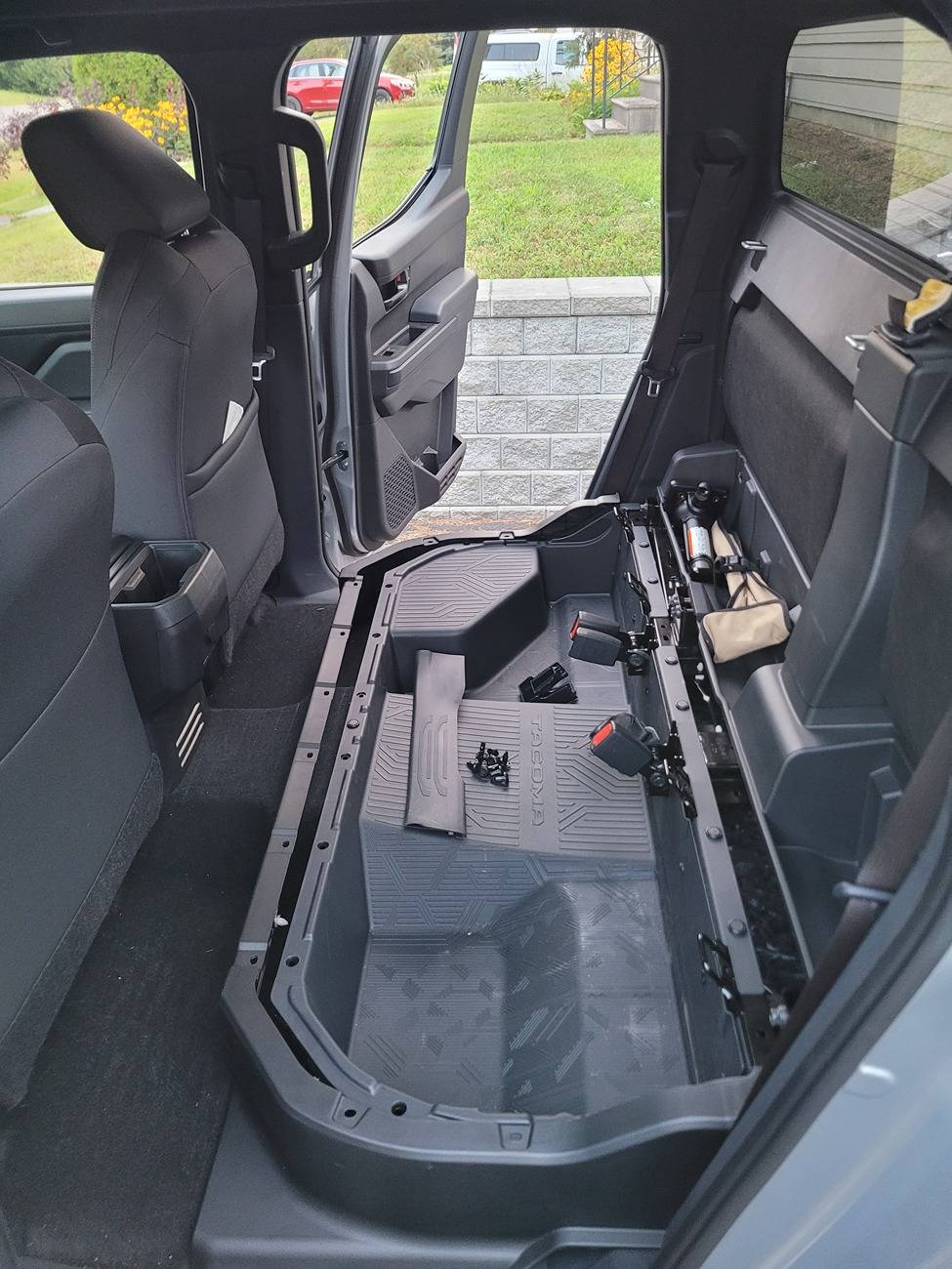

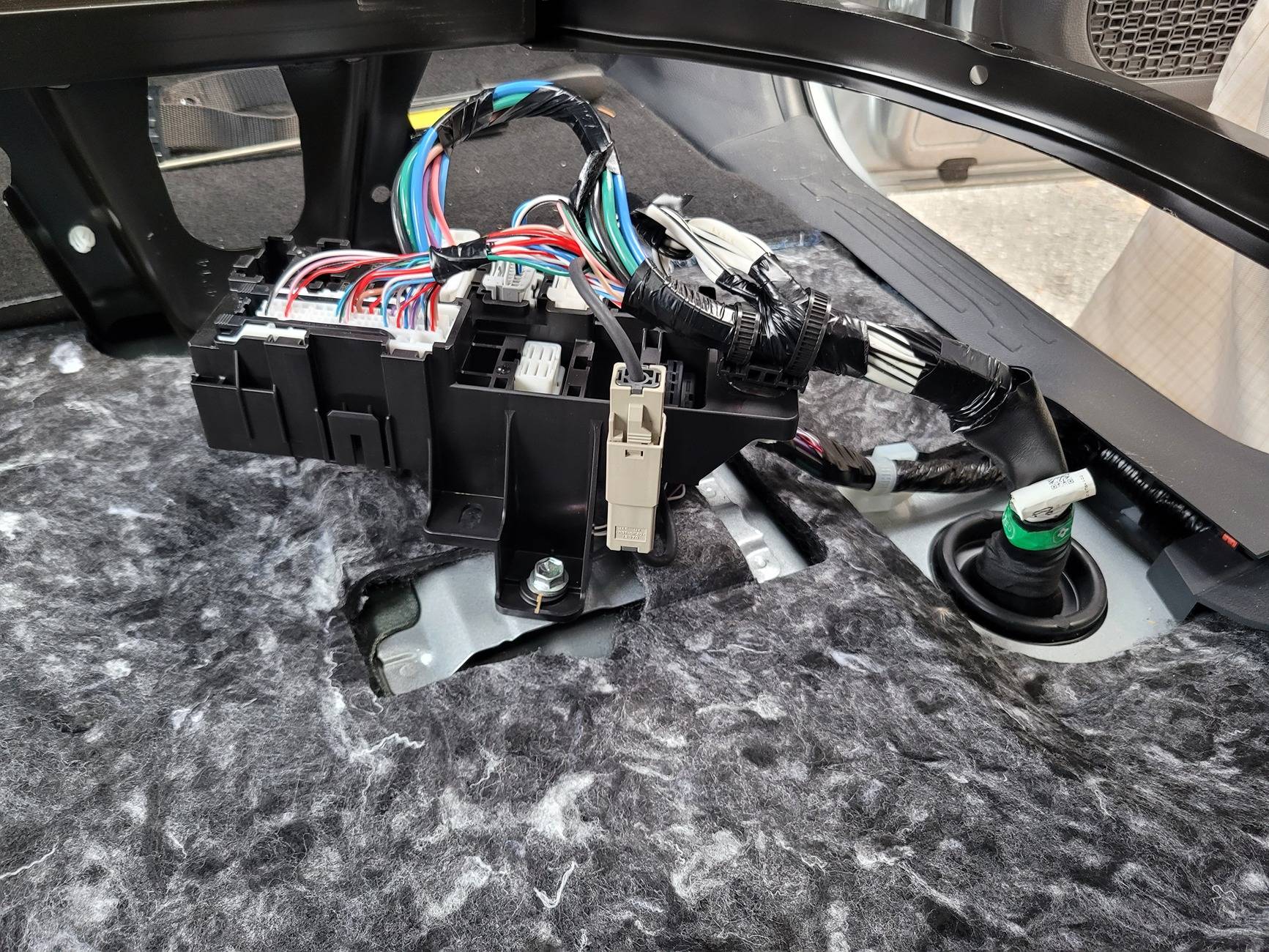

On my SR5. So far I got the seats out and the trim around the front and side edges. The "tub" storage thing is next and looks like it will come out easy with a few pop pins. The tub is supported by a metal frame that also looks like it will come out (bolted to the back wall and floor I think). Not sure I will remove the frame tho as the blocked off space under the rear passenger seat has a big junction assembly of wires, which I do not want to touch. After I see whats under the tub I will likely put it back and make a hinged plywood lid to cover it. I will remove the seat belts parts and maybe see whats behind the back wall cover. I expect the road noise will be louder, will find out tomorrow.
Update: Got most of the plastic removed, its very easy to get it to this point. It would also be easy to remove that black frame which would open up a lot of usable vertical space (which is what I need), but that assembly of wires is in the way. I suspect at some point I will take out the frame and make some sort of cover for the wires, but for now I'll just leave the tub in place while I figure out what sort of platform to put in there.

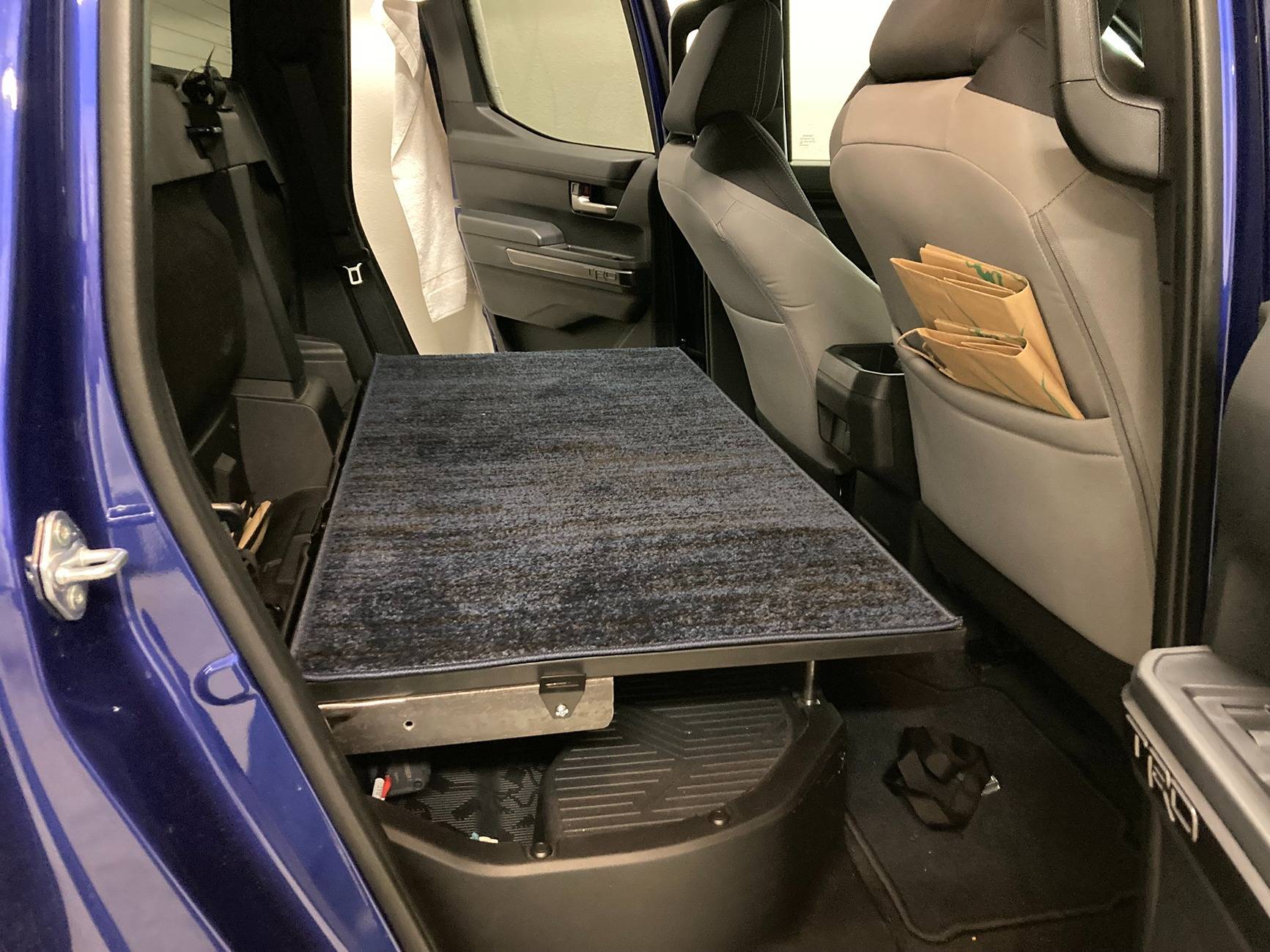

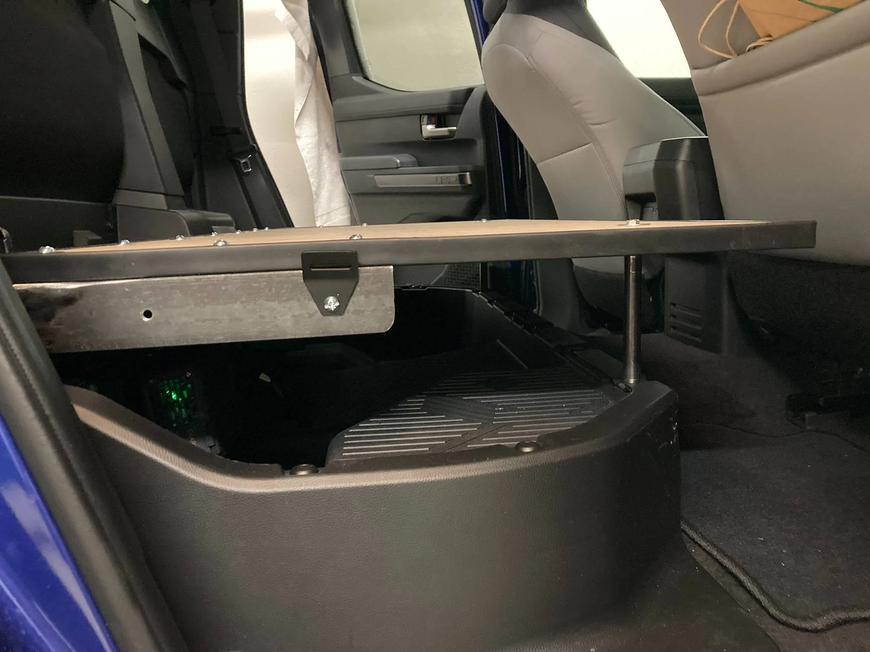

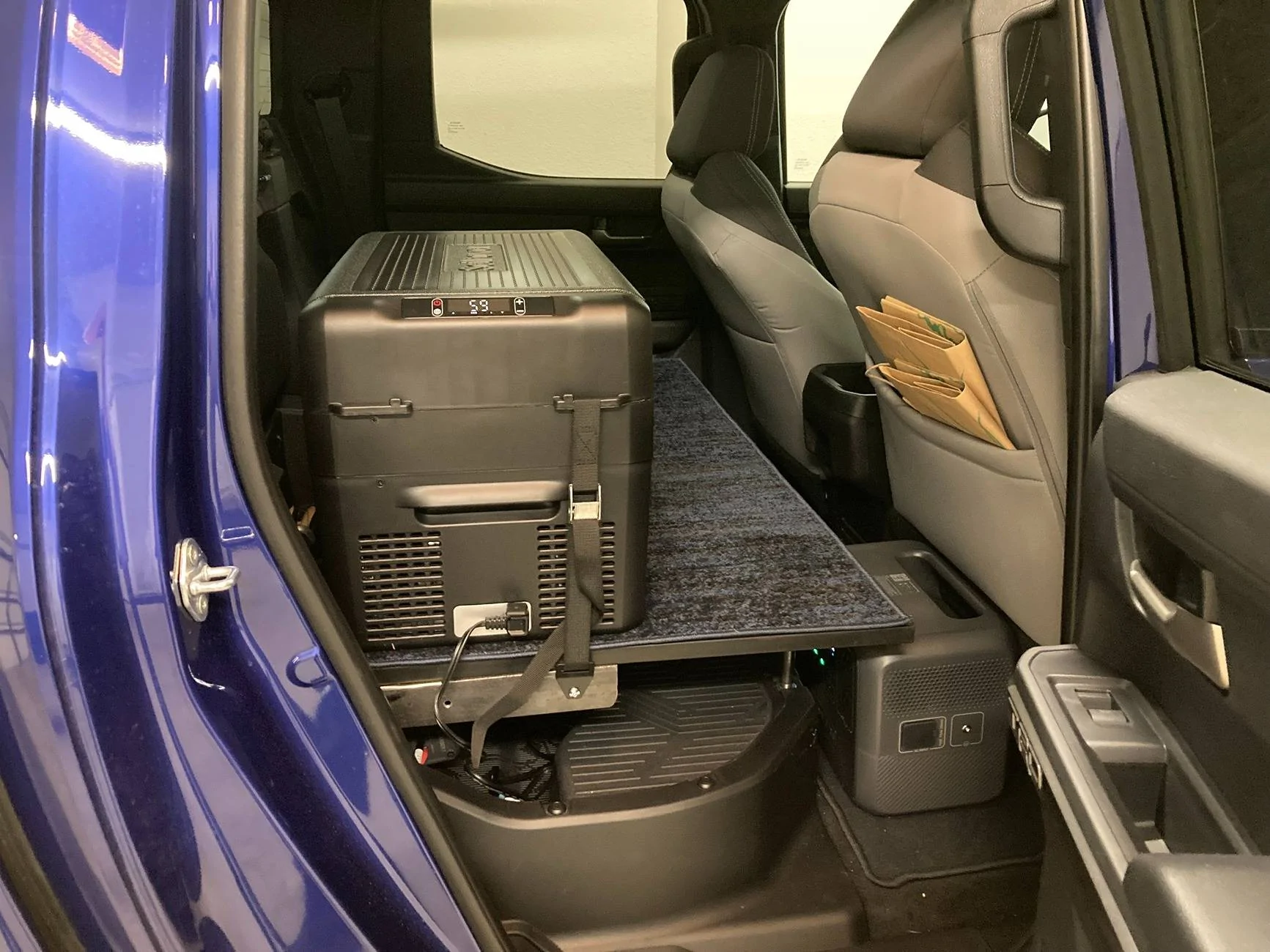

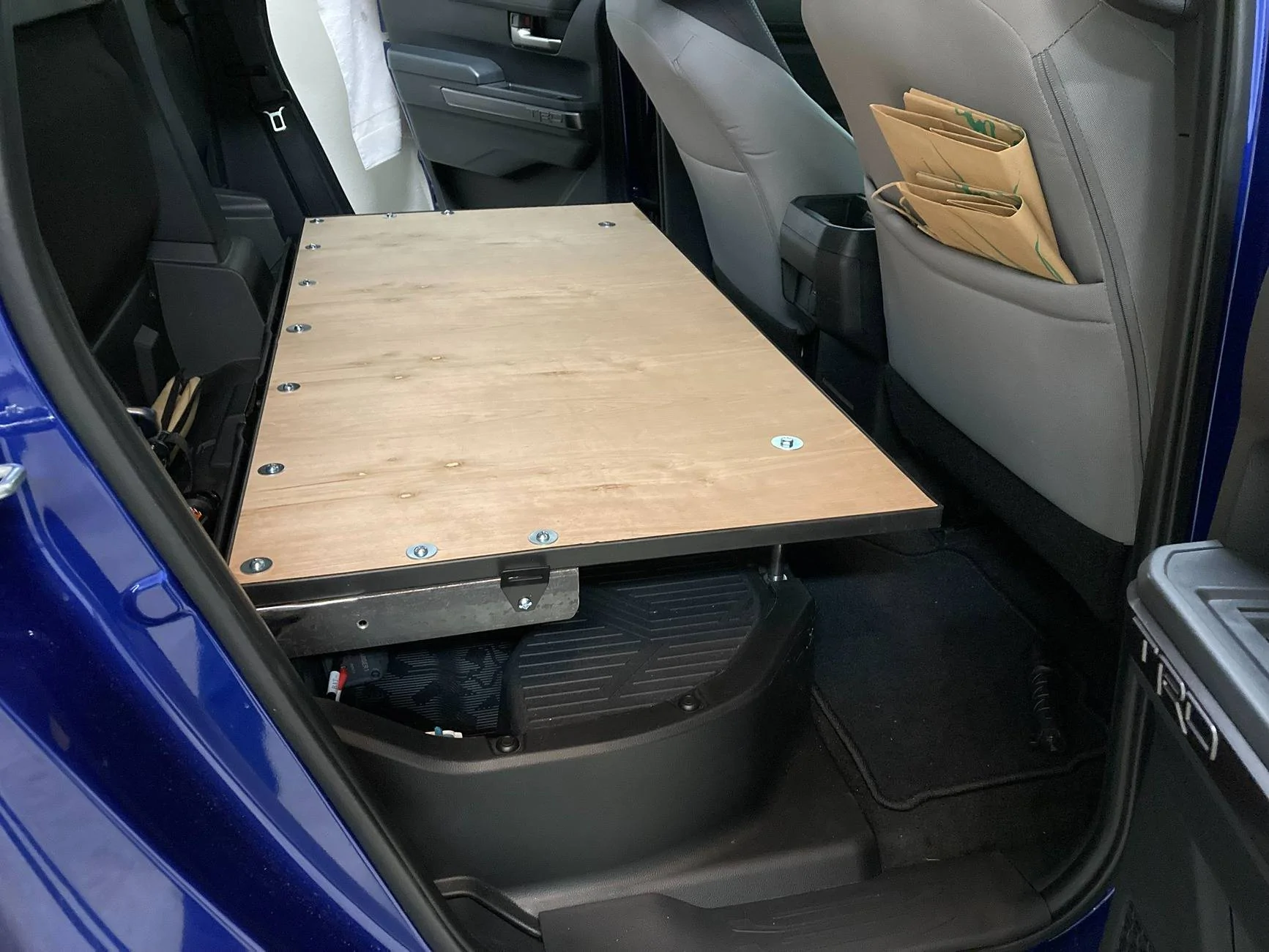

Checking back in, I made a rear seat delete shelf with 2'x4' plywood and a piece of angle iron. I used the GooseGear idea of putting nutserts in the seat frame and using spacers with long bolts for the front support. I left the sides open since I don't have the skills to make access doors. My brother in-law did the cutting, welding and drilling on the rear frame. I topped it with a 2'x4' indoor outdoor rug from Amazon. It is very solid and will support anything I would want to put on it.
I am happy with how it turned out and I have less than $150.00 in it. The Charger1 has to come out when the seat is in, that is if you want to put the seat bottom down. I also put nutserts in for the Charger1. It takes me about 20 minutes to take the rear seats out and put the shelf in. Not going to swap them around much. I'll mostly use this on camping trips. I'm still playing around with the fridge orientation and tie down placement. I also need to paint the frame but that can wait.
I also do not have any notifications after this but I disabled any "rear seat occupant reminders" I found a long time ago.
Edit to add, the shelf weighs 27 pounds without the front supports.

Looks great and very similar idea of what I’m trying to achieve.
The issue I’m having at the moment is installing the nurserts. Because the 2 layers of plastic, I can’t get the tool flush with the metal and it’s keeping it from grabbing. I feel like I need to take the plastic tub and surrounding plastic out but I have no idea how to do that.
Did you have to take it out? Or what tool did you use?
I have an attachment the goes on your drill. I feel like it would work but I need to get down to the black frame.

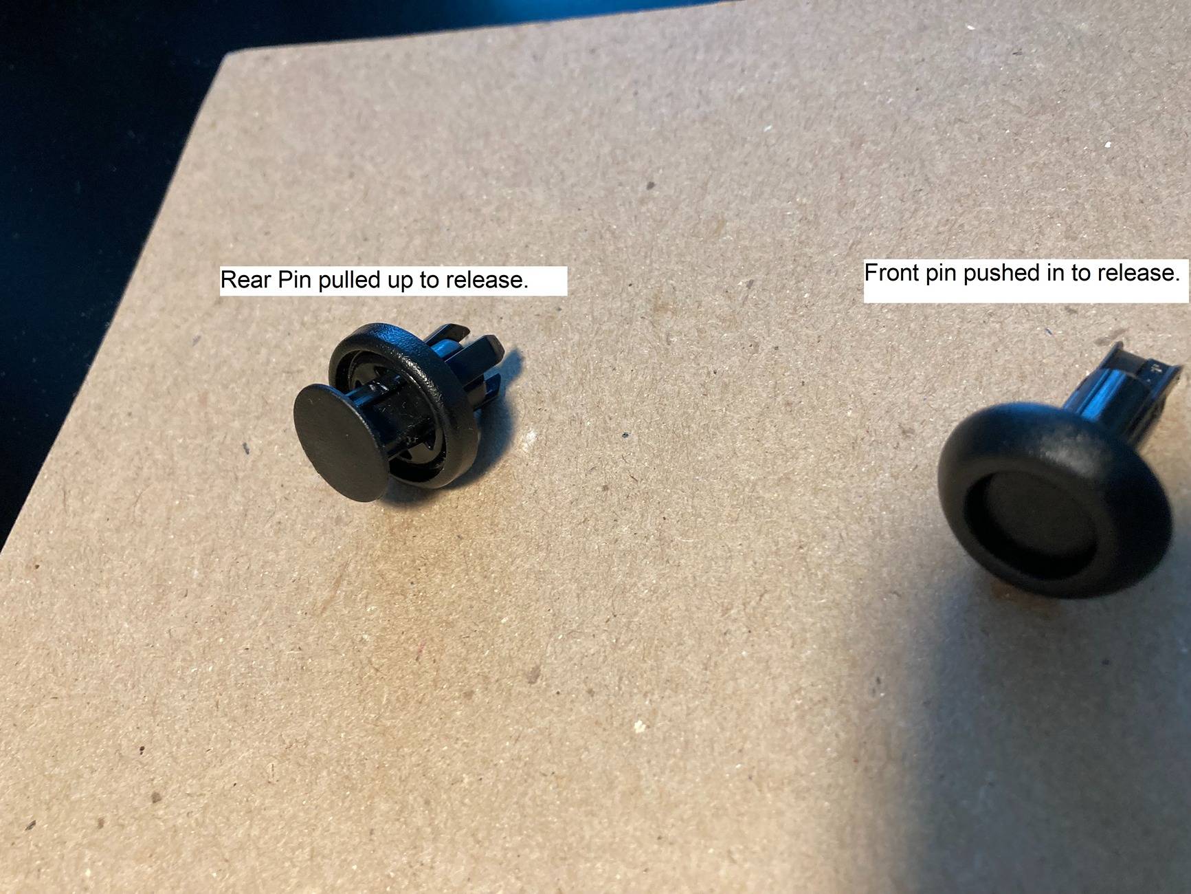

@Tycoma yes the plastic tub all had to come out. It's not hard you just remove all the plastic pins holding it in. You push the center of the front pins to get them to release. The pins along the rear need the center pried up to release. I put a picture below that shows each. I used plastic trim tools but you could use a screwdriver, the front pins I just use my finger. I used a cheap Harbour Freight nutsert tool to put them in. It worked great but as you noted the tub has to come out first.
Edit to add, now that I think about it the side pieces that form part of the door sil also had to come out. They are secured at the front and rear, trim tools come in handy for this.

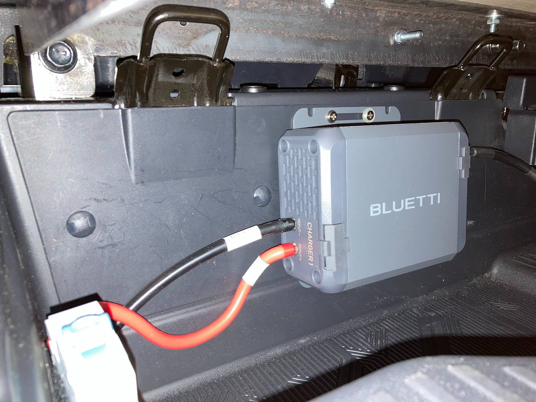

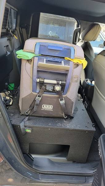

Rather than start a new thread I will just add to this one. I have the non-hybrid seat delete. Under the passenger side I installed a 50Ah battery, charged by a Powerwerks 2A/4A/8A DC-DC charger off the engine. This battery powers my HAM radio, and fridge.
I've gone back and forth with the fridge. It's been on the back seat, and in the camper-canopy. I think it's home will be the back seat.

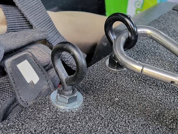

I also installed a bunch of eye-bolts on top. There are several t-nuts preinstalled on the seat delete (1/4"-20). There are also a bunch of extra holes. I installed t-nuts on the vacant holes to give me more flexibility.
Did you know if you can relocate those wires more yo the back im trying to make a box for sub

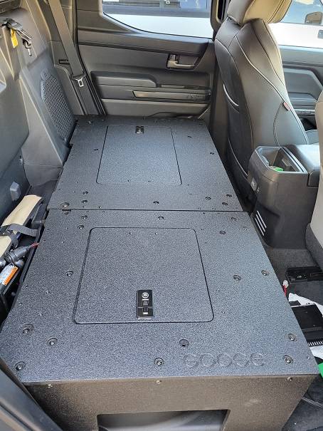

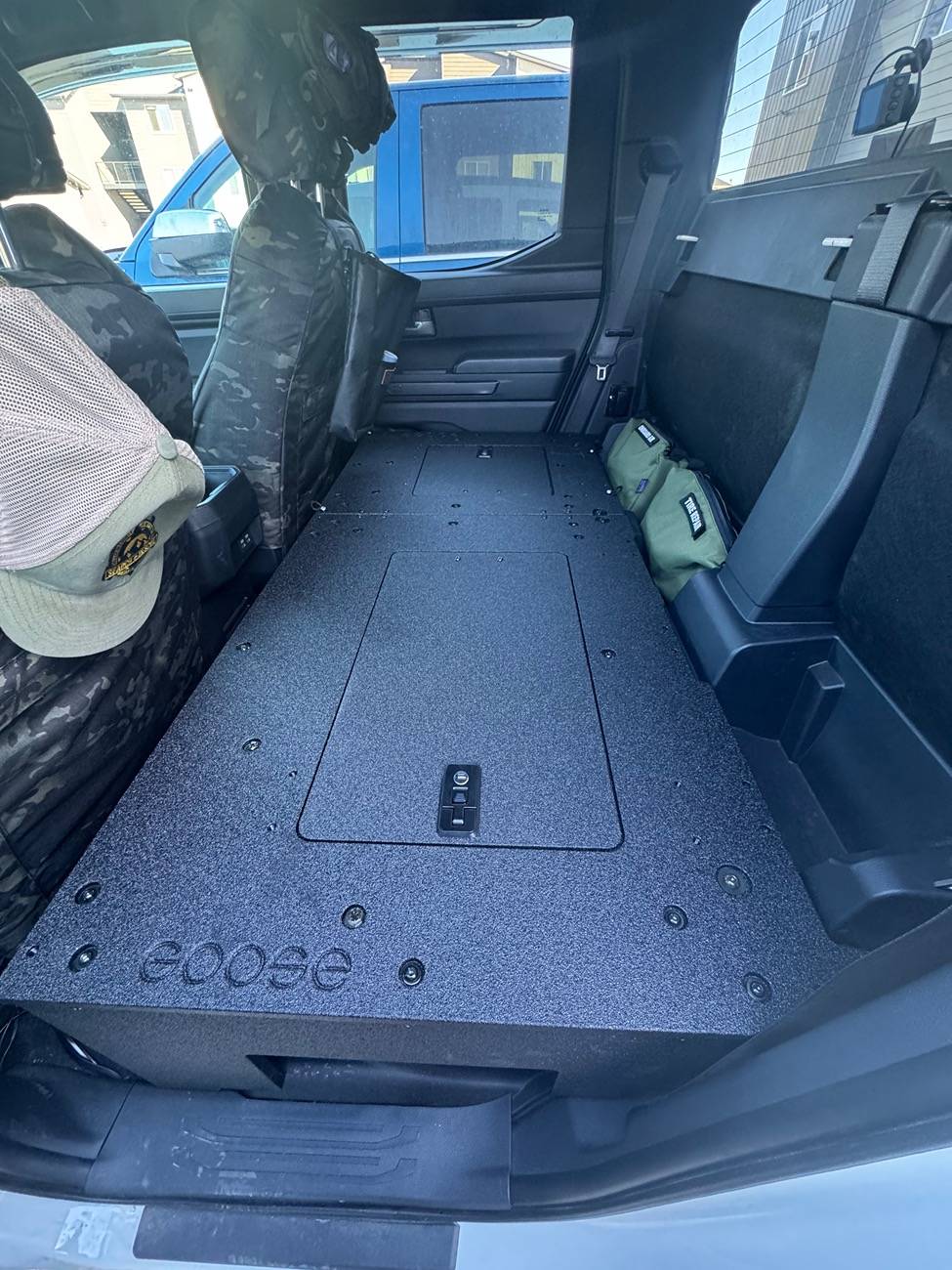

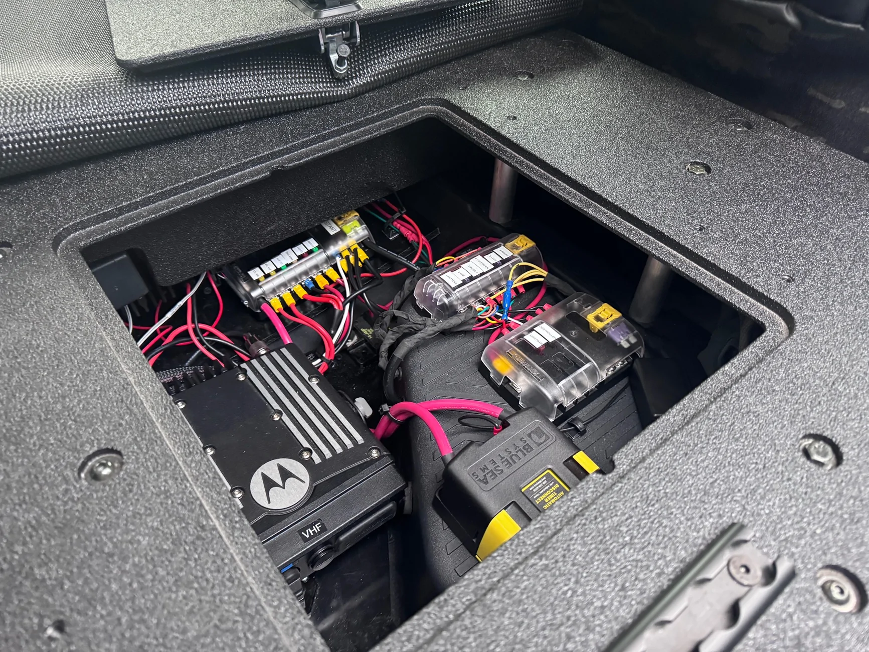

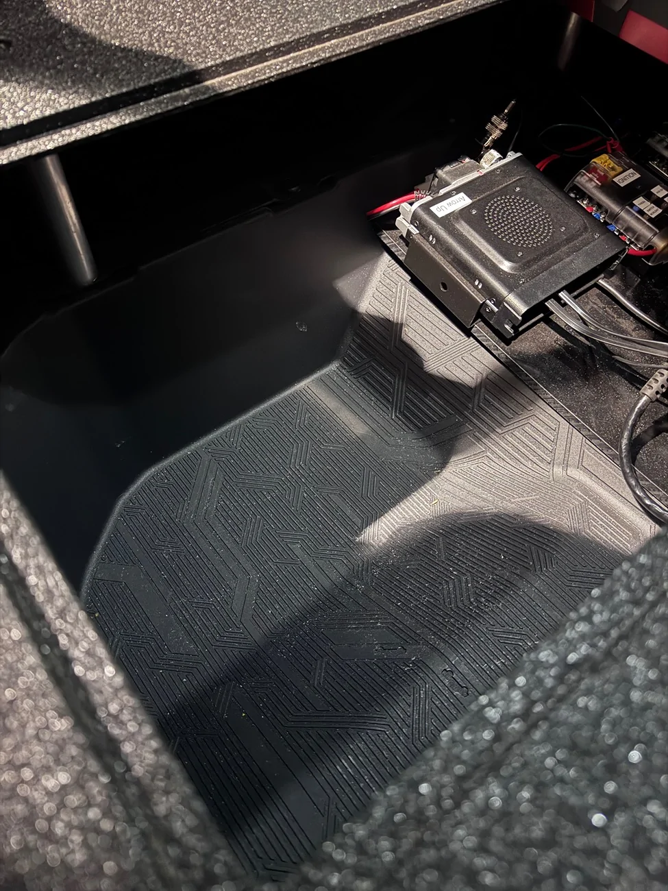

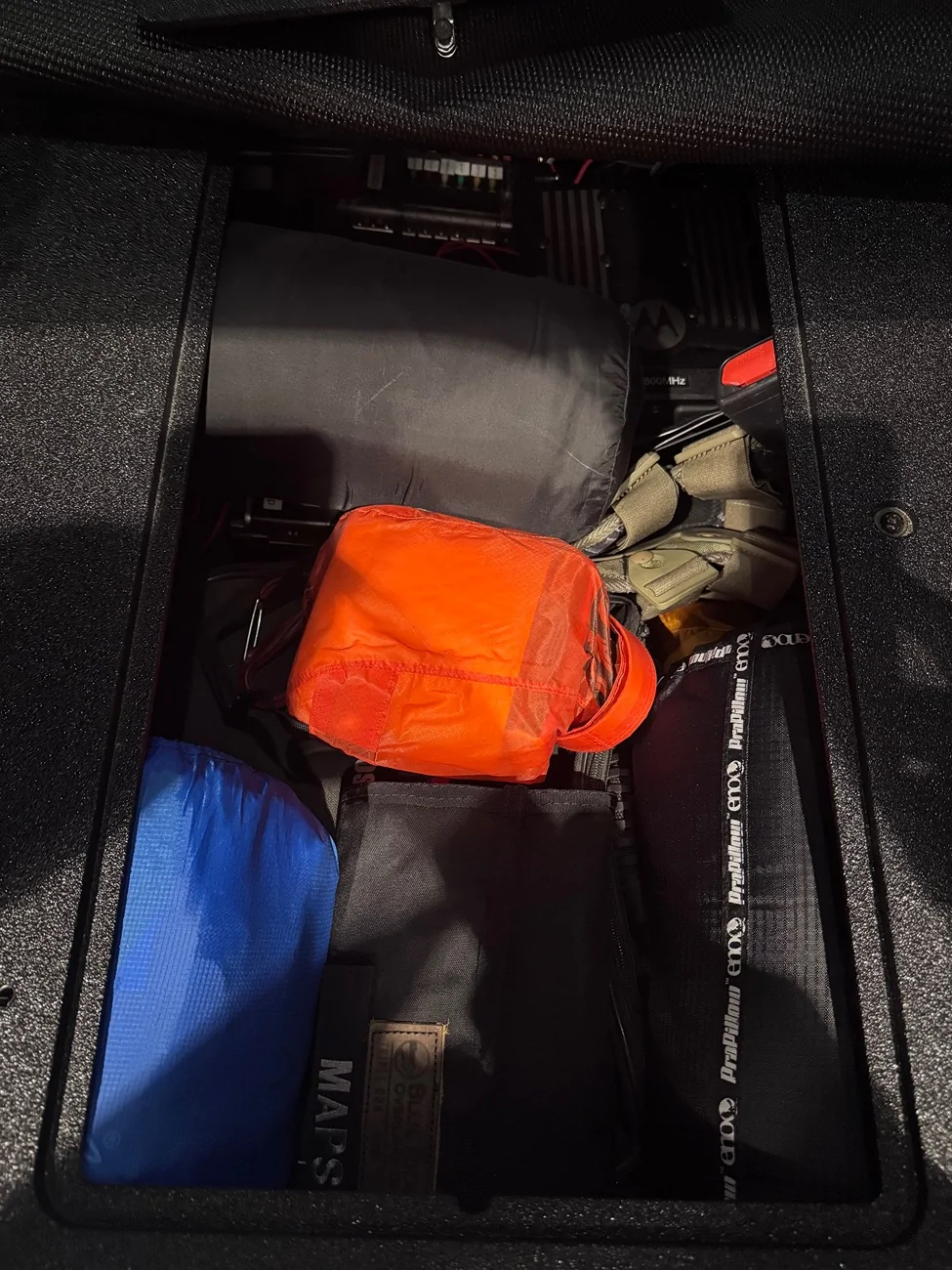

Would you mind taking a picture of the interior of the goosegear (60% side)? It bugs me that I lose the floor space if I do decide to buy it.
geonerdist
Curtis
Apr 5, 2024
96
107
Bozeman, MT
2024 Tacoma TRD Off Road/2007 Nissan Xterra
Sure thing, I just had carpal tunnel surgery yesterday. Moving slow today and I don’t have any handy.
I will say what you lose in floor space you gain in vertical height. I also keep soft things like jackets pushed through the side “vents”, so they end up between the front facing panel and the wall of the storage bin. There’s also still room between the seats and the delete kit to put stuff too.
The driver side has a ton of room compared to the passenger side.

Thank you geonerdist! Looks like there is more vertical space for the storage as well. Only thing holding me back is the husky rear mats I just bought haha. Thinking if I should cut it up and leave the 40 portion or just sell it.
