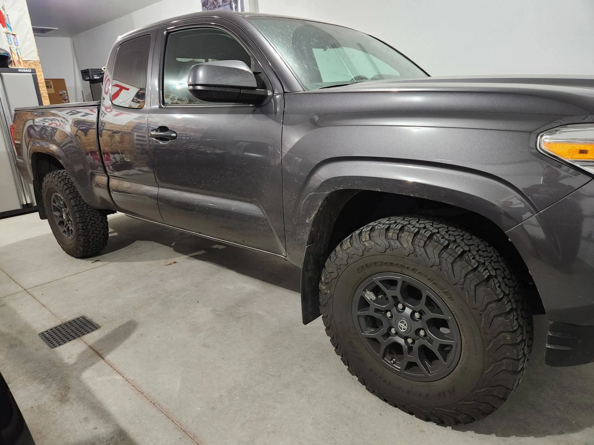

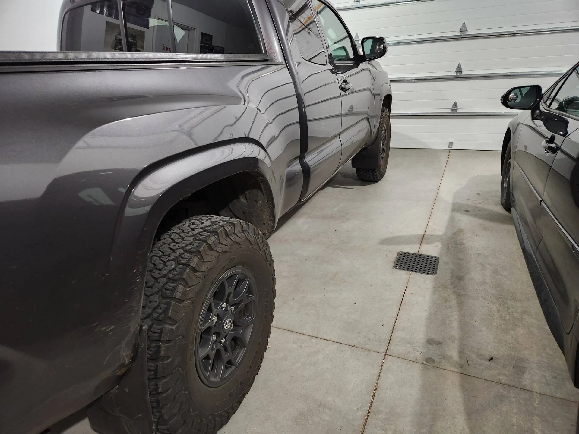

265/65 R18 comes out to: 31.56" overall and 10.43" wide. Same as my 265/75 R16 on my 2016 SR.

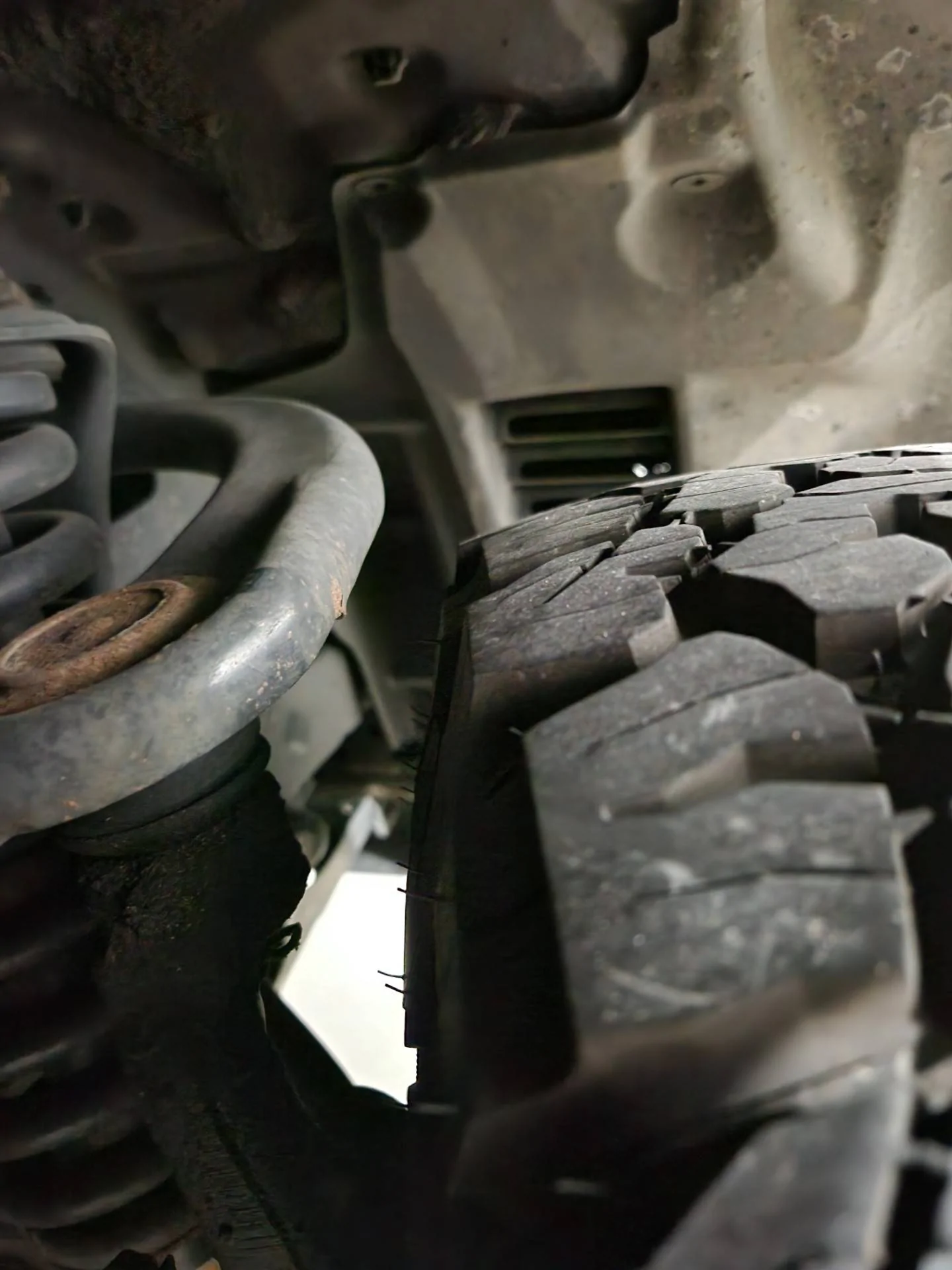

Here is my concern with the added 0.4" or 0.2" per side, can I clear this already tight gap with upper a-arm? New Tacoma front should be similar to 3rd gen. on front end. For 275/65 R18
