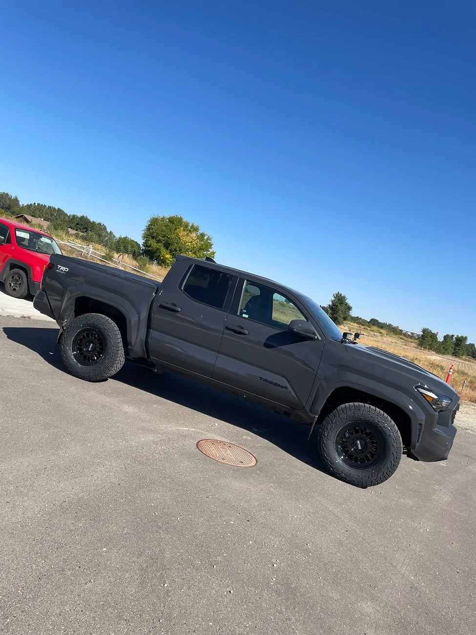

I have 285/70/17 on +25 offset wheels. Never had any issues with rubbing

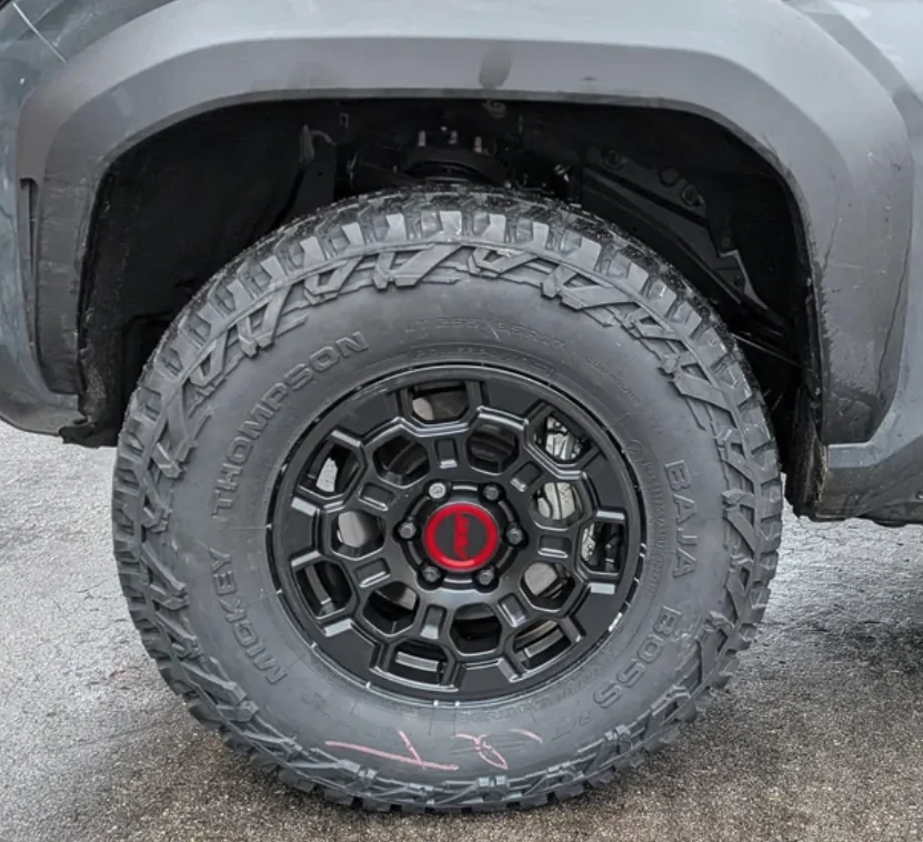

BLtheP
Apr 12, 2024
169
108
TX
There are people with even larger than 285/70R17 with no rubbing. But it all depends on what wheels you have. Stock wheels lend the best chance of success.
Personally I think 285/70R17 or 265/70R18 look the most proper. Bigger than that just looks really crammed in there to me.

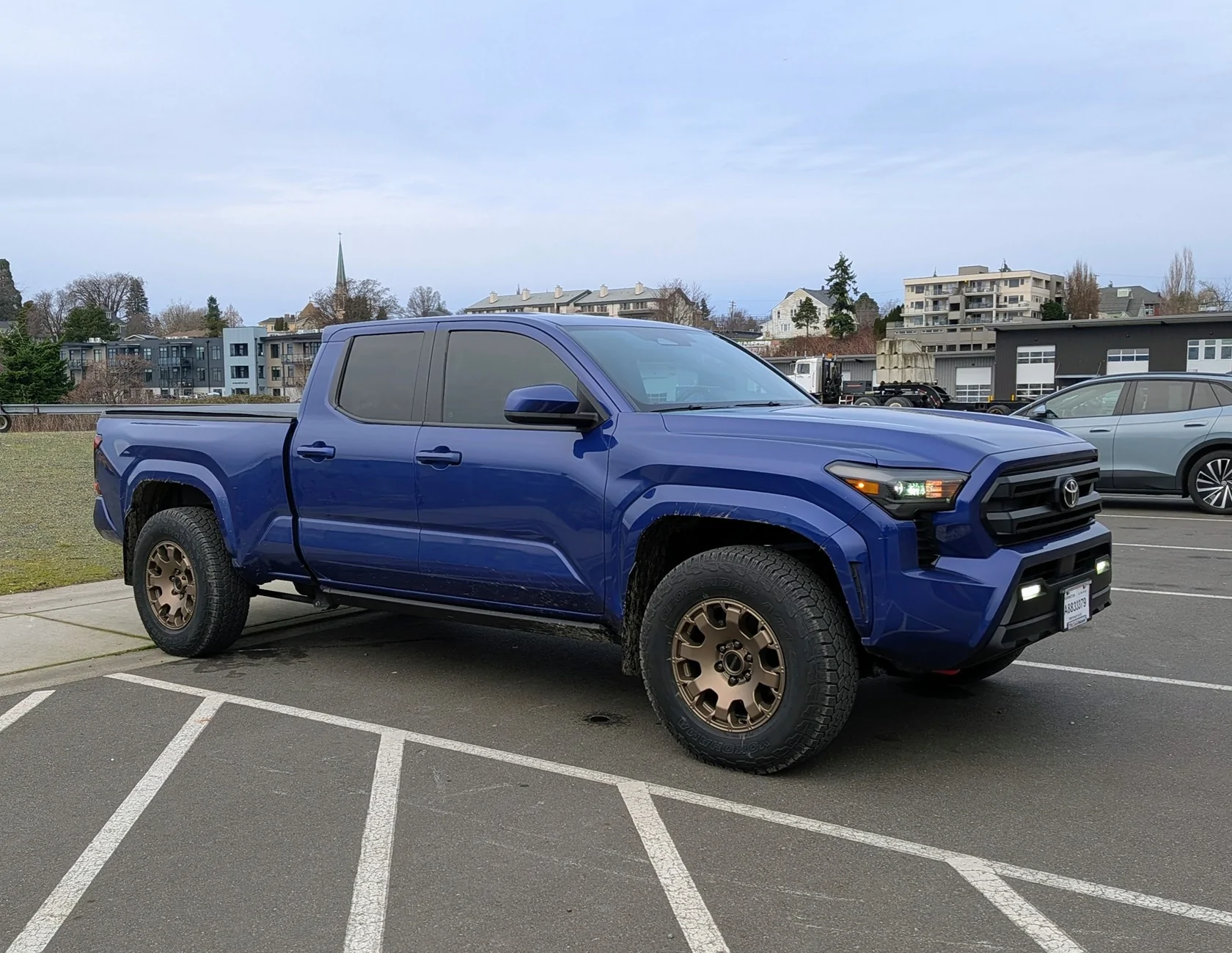

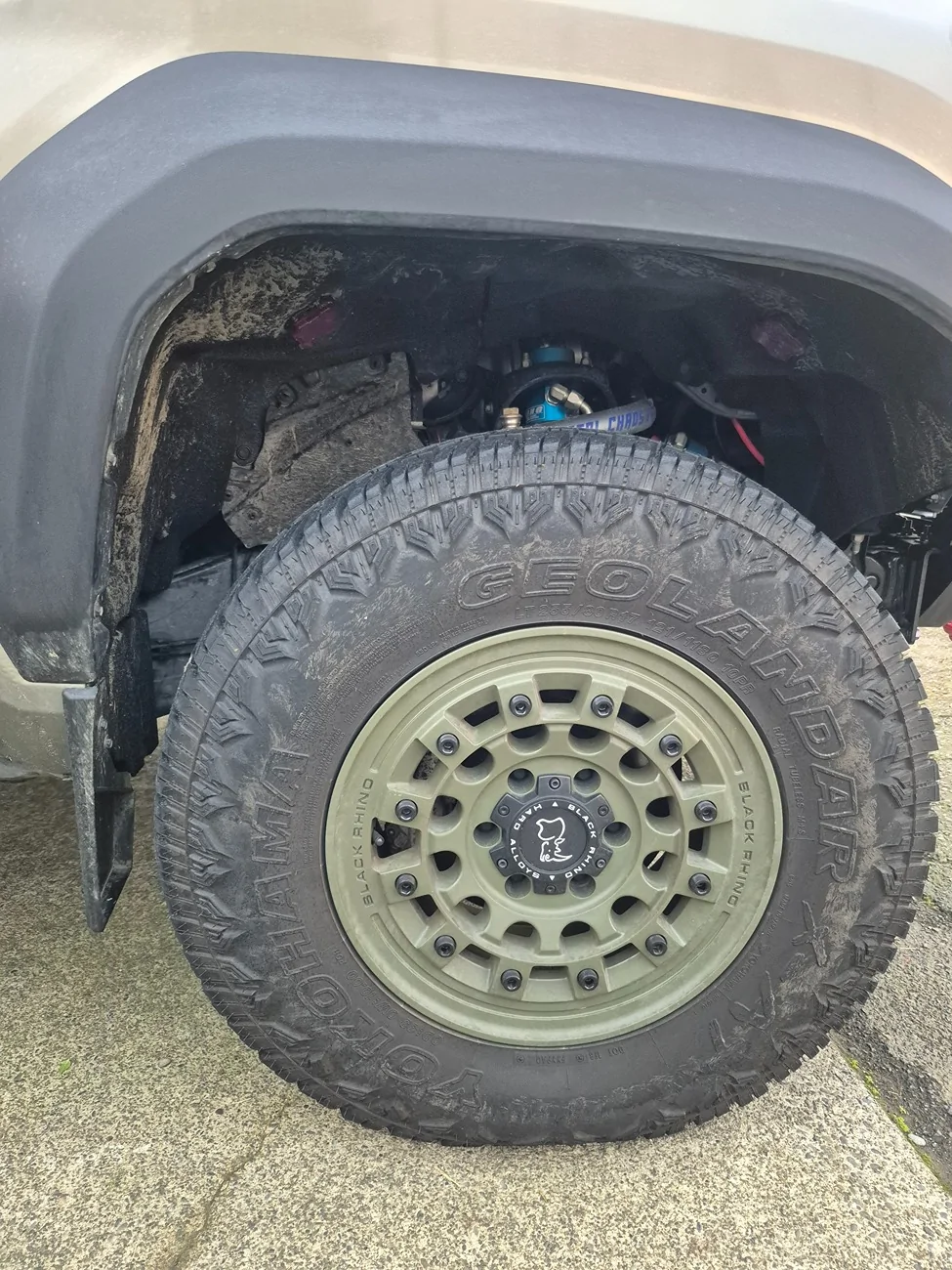

Anthony
Jan 11, 2025
508
338
Aberdeen Wa
I am running yokokohama geolander XAT 255 80 17's on +20 rims with no problemS before I lifted it. They are a true 33x9.5
A another option to consider, hope this helps you.

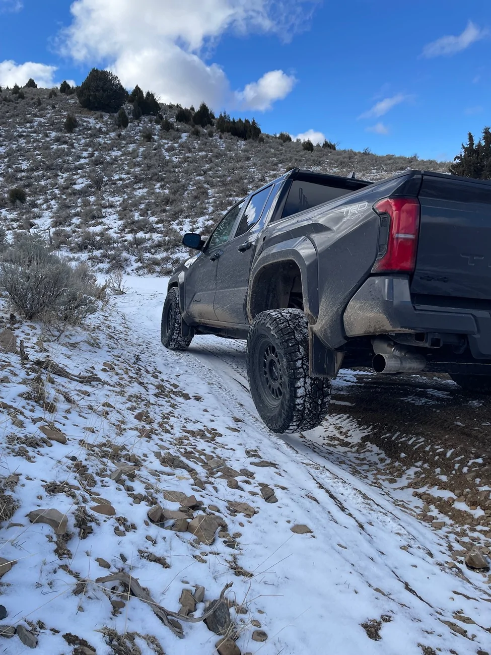

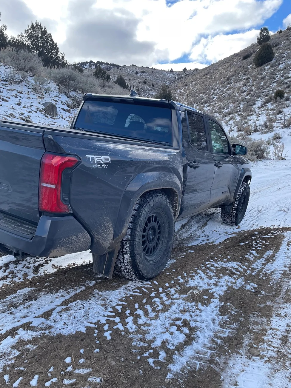

4th gen 2025 Tacom m/t to
255/85R17 almost 35" on +45mm offset rims, no lift, zero issues except front mud flaps that had to be removed.
