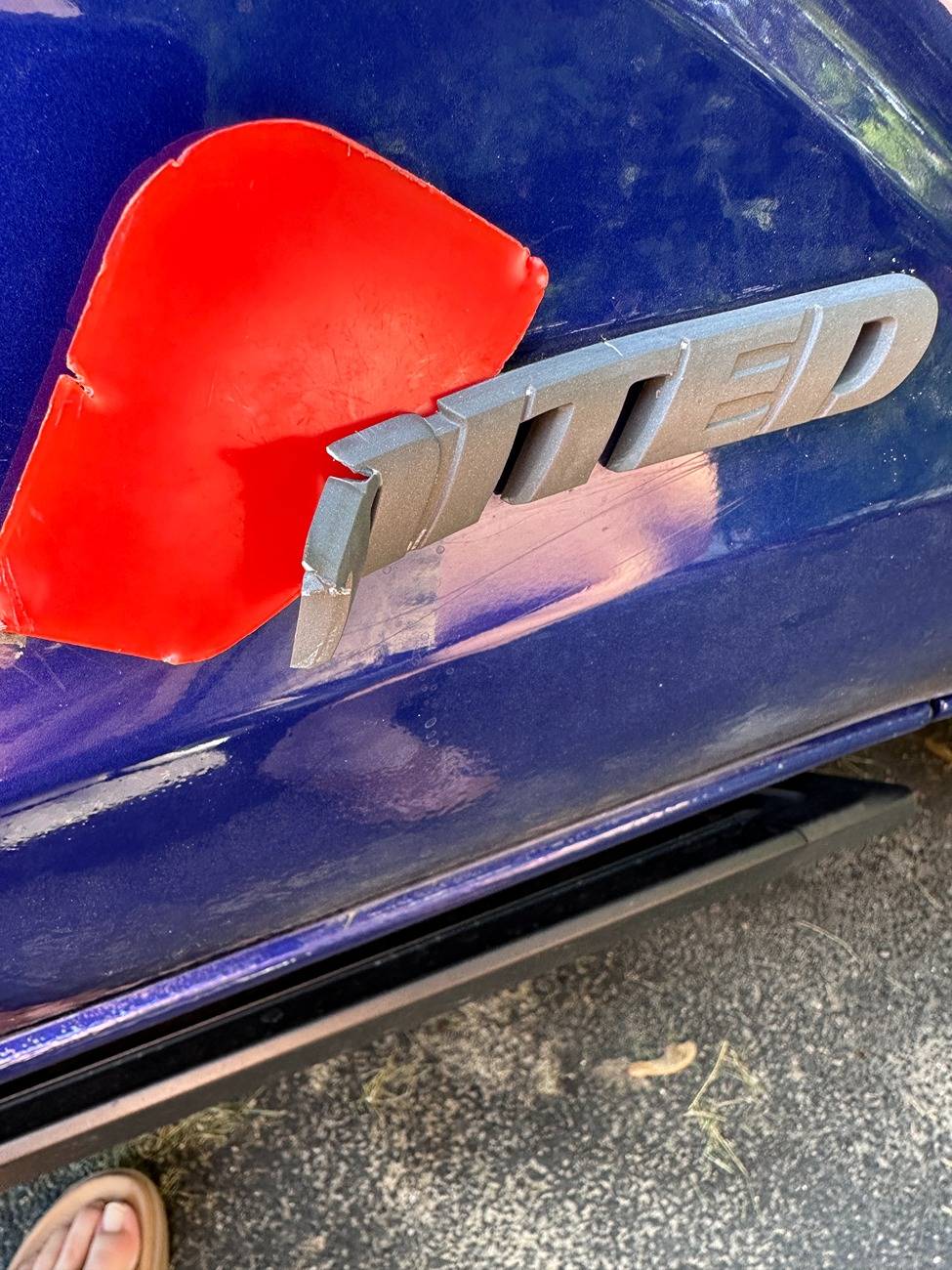

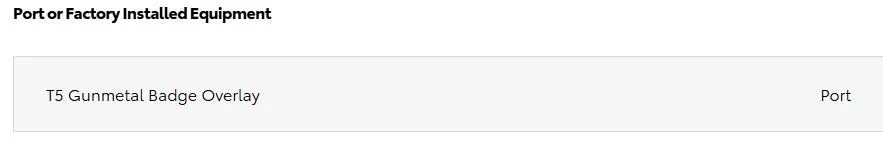

Check your window sticker. My blue limited had the "gun metal" overlay already installed at port. I had to remove them to install the flat black overlays. The kit had the front emblem which I can't use as the front emblem on the limited is illuminated.

This was the issue. Was the gunmetal one hard to remove?

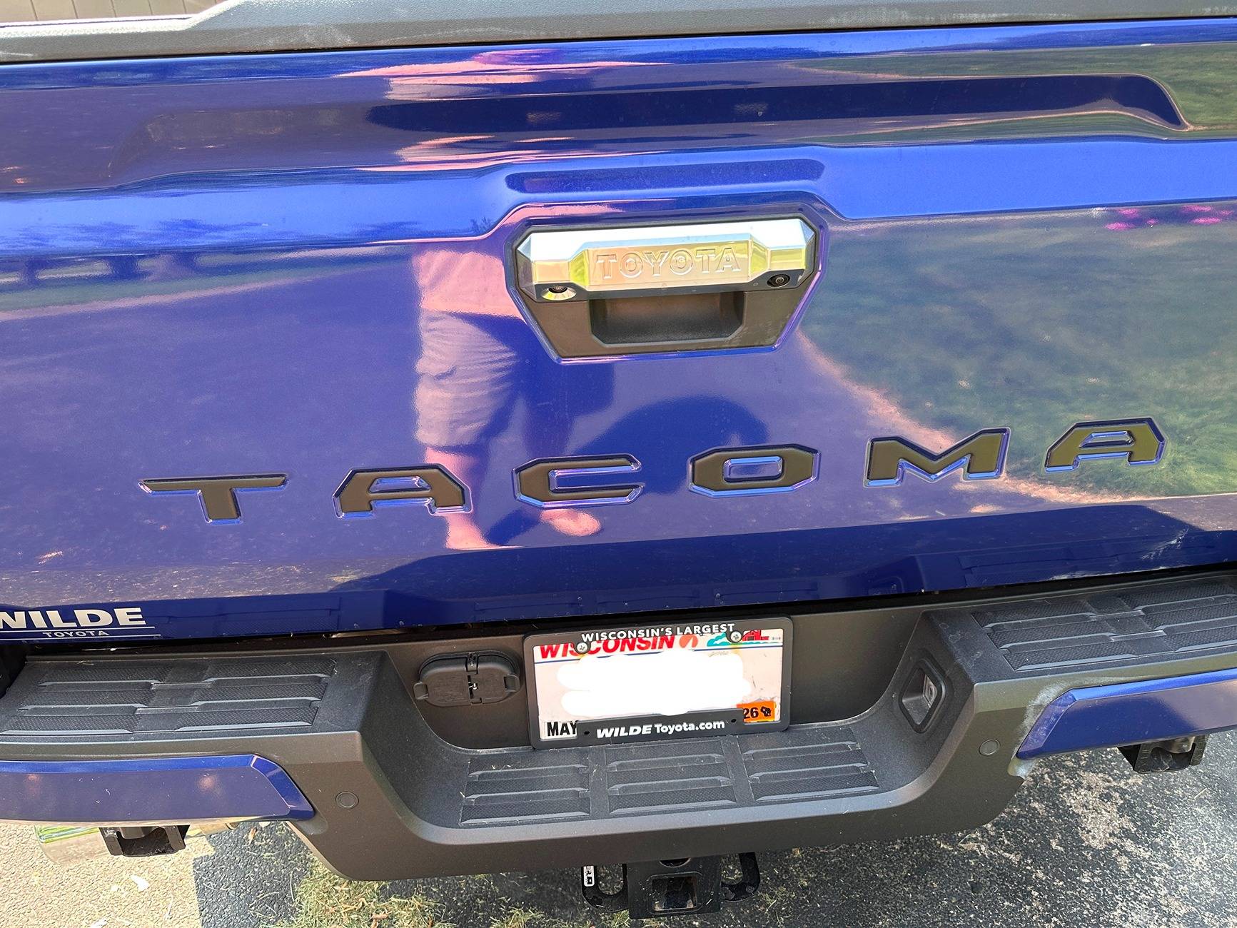

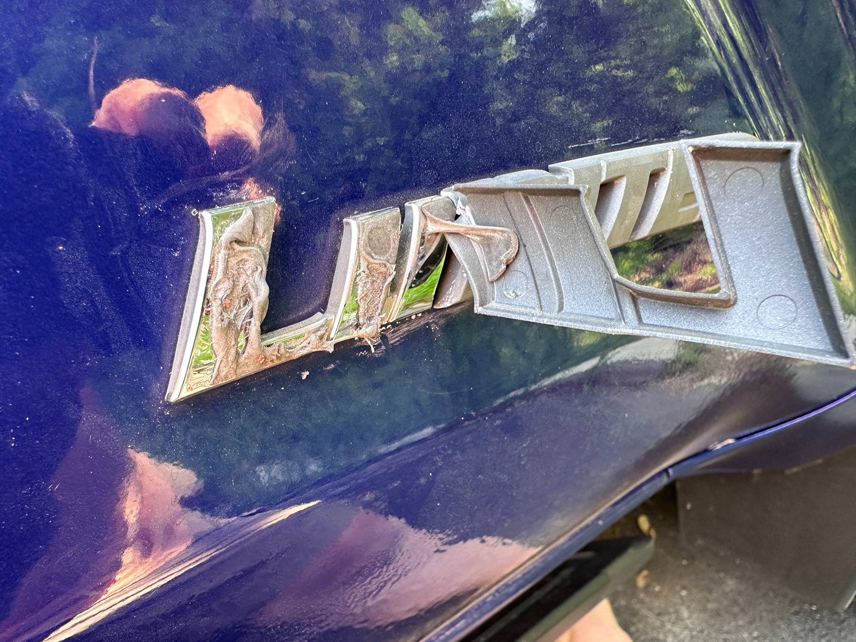

Yes, it was a pain, but I did get it off and replaced. The hardest part is getting a starting corner up. I found the lower part of the L the best place to try and wedge the spudger between the chrome piece and the overlay. Once I got it started, it wasn't too difficult. Use 91% IPA to remove the remaining old adhesive. I did the tailgate too. That took some time, but turned out really nice I think..
